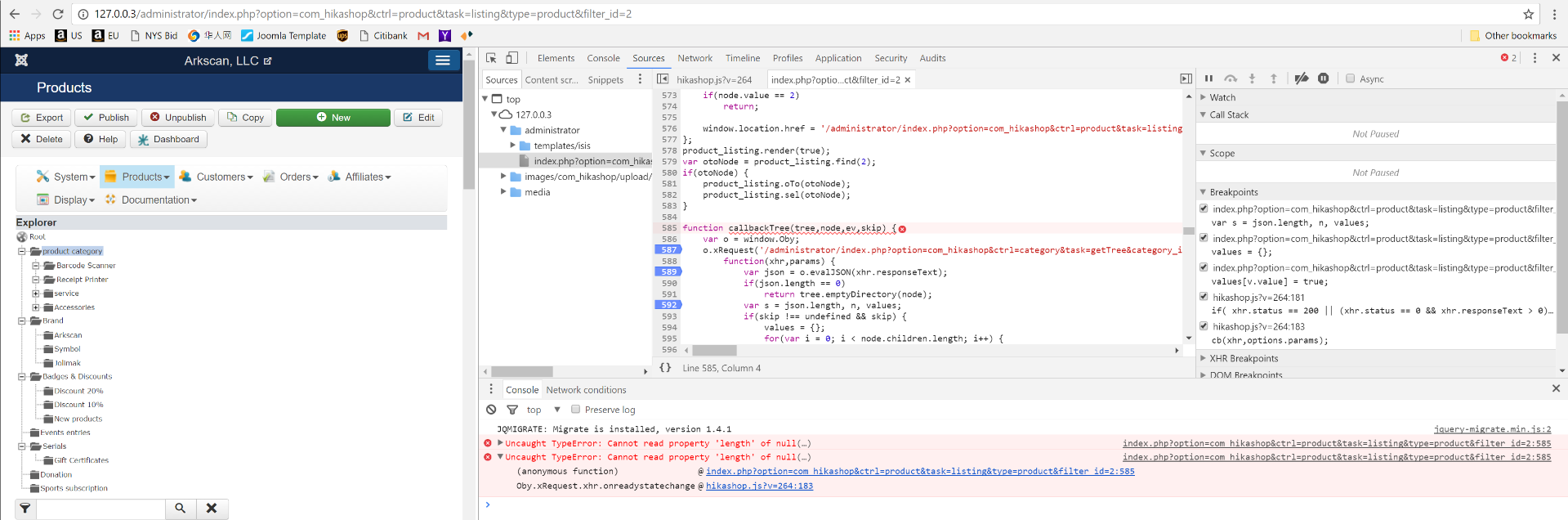

  • Posts: 11
9 years 9 months ago #255434
see attached error with the debug, the 'Barcode Scanner" and "Receipt Printer" should have child categories, but they don't, instead showing the '-' with nothing below.
