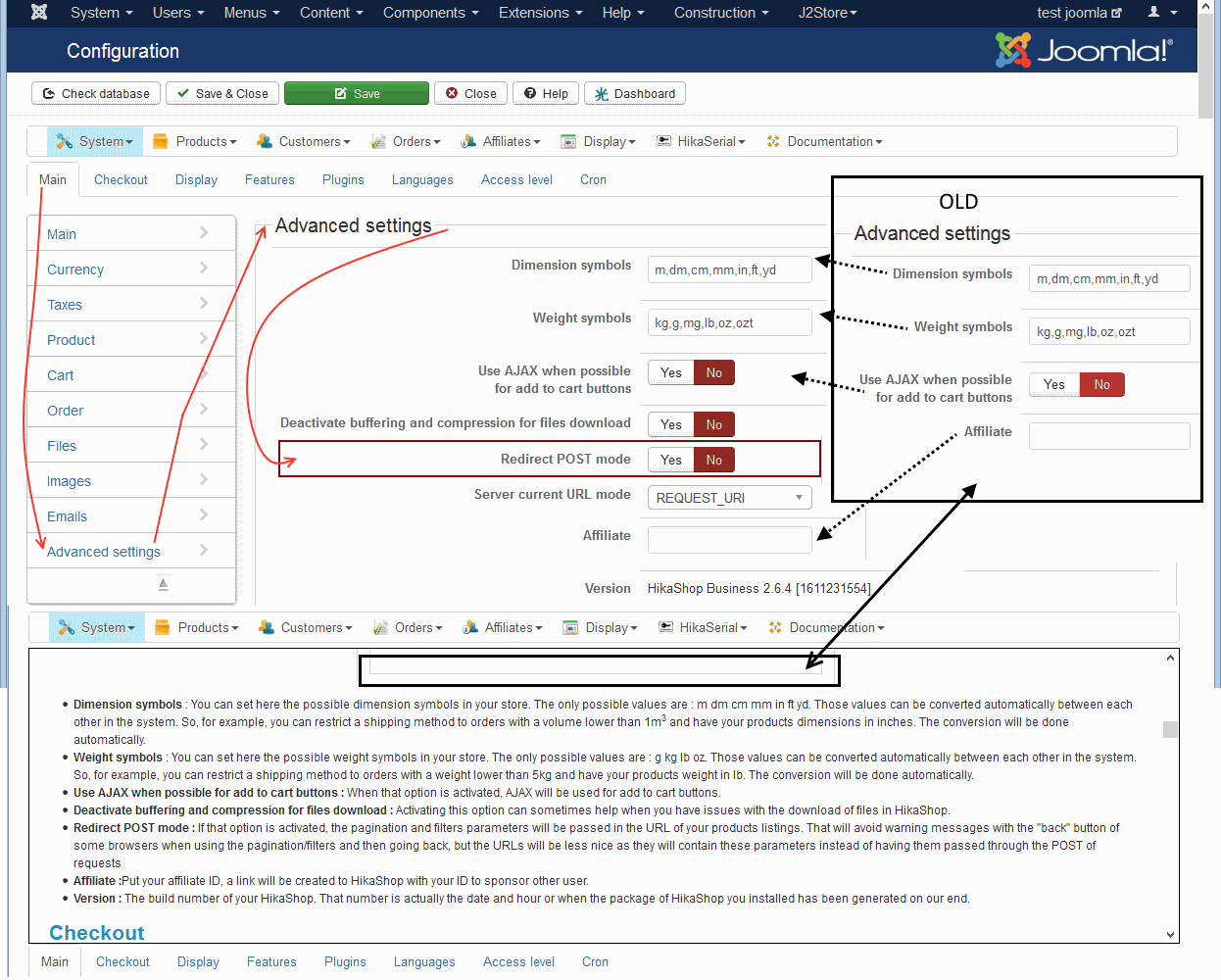

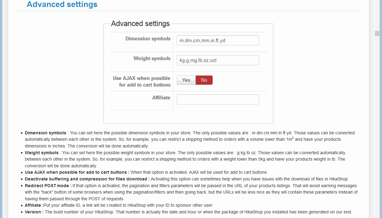

Thank's a lot Really strange documentation : the capture screen is not update but the text is update to the actual gui backend !! .
here now 27 november the capture screen of hikashop documentation about configuration -> advanced setting and below the comparison

So advice is clear , take care that capture sceen are not update but text doumentation is update !

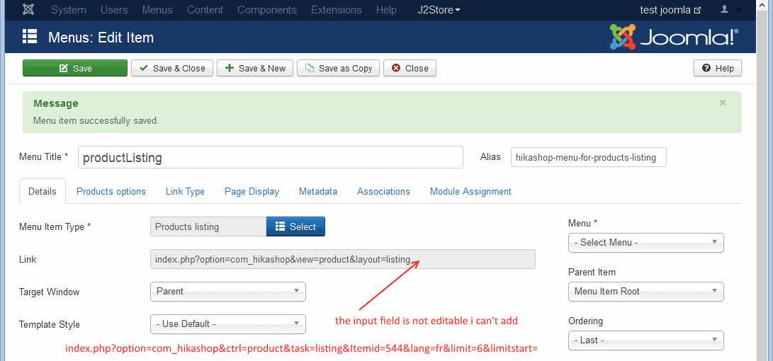

Since module can be a link between the menu and the filter ( id menu to use inside module) , i achieve to see the URL to use without configure the menu to show the filter. Does this method is also valid for find the url with parameters ?
You write :"However, it can't be done on modules as modules are not affected by filters. It has to be done for a menu item."
So how it can be done ? The problem is i can't add option name/value to the URL of menu item of type product list ! the field of label name link is not editable !! 544 is already the id of the menu so i think i don't have to enter this variable/value ....

1. We can't redo the captures each time we add a new option, it takes too much time. We only take new captures when the interface really changes. We'll do it for HikaShop 3.0 actually for the HikaShop configuration documentation.
2. Create a new menu item of the type "External URL" and enter the URL there: docs.joomla.org/Help36:Menus_Menu_Item_External_URL
