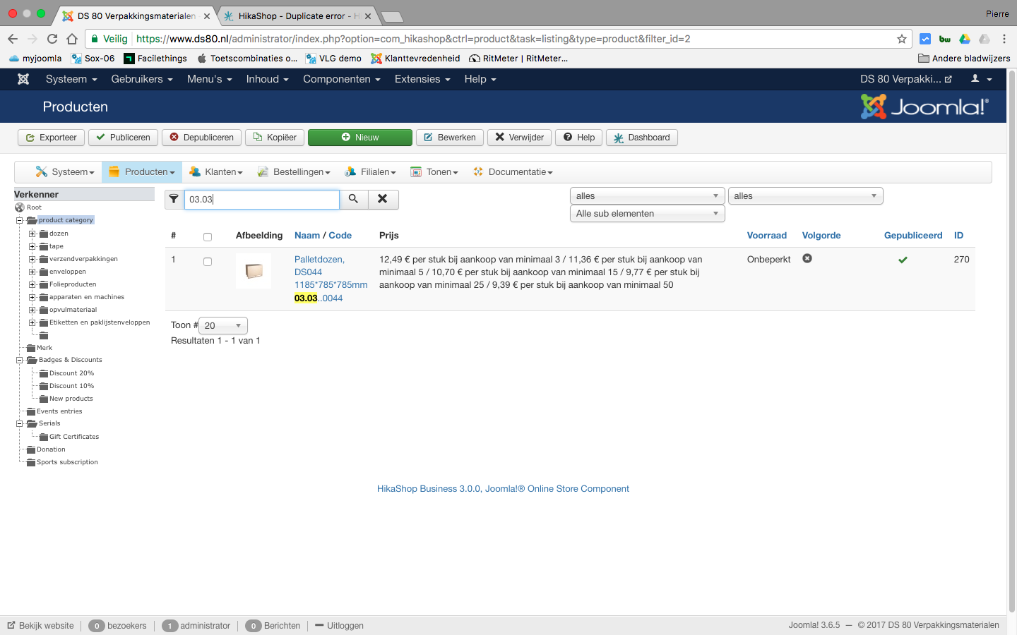

Started working on this issue again. I will try to explain as well as I can what happens.
On screenshot one you see that I search for products with code 03.03 shop root level, search settings to ' all' as proposed by Nicolas. There is only one product 03.03..0044 this is the wrong code it should be 03.03.0044

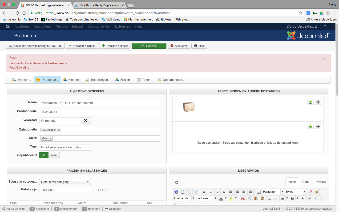

03.03.0044 is not present in the shop I cannot find it no matter what i try however... when I try to alter the article number and hot save I get the error as in screen shot 2 stating that the article is already present. This happens with 20-25% of all articles.
Old customers abandon their cart as they cannot find the article numbers they are used to.

As expected you do already have a product with the product code 03.03.0044 in the shop.
I've done a mass action via the menu System>Mass actions in order to find it:
administrator/index.php?option=com_hikashop&ctrl=massaction&task=edit&massaction_id=1
Click on "process" there and you'll see a listing of all the entries in the table of the products in the database containing 03.03.
There, you'll see not one but two entries.
And the other one you don't see can be edited by directly accessing this URL:
administrator/index.php?option=com_hikashop&ctrl=product&task=edit&cid[]=427
As you'll see there, the problem is that you've added this product to the "taxation category" and that category isn't taken into account on the products listing as you're not supposed to add products to it.
So change that category in the product for a valid category, and you'll be able to delete it via the products listing.
Or even easier, if, for each product you have a duplicate one with the correct product code in the taxation category, then you can configure a mass action based on the category_id of the category of the product with an action to delete the products, so that it would remove all the products linked to the taxation category.
