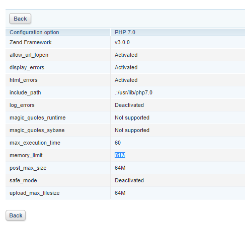

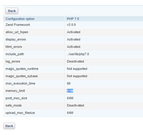

I've attached a copy of my php.ini file settings (I can't change anything though.)
Was wondering if there was a way to overcome the limitations of this file or is there another way I can go to make it so I can sell files that are 5+ GB?

The memory limit is not the problem in your case ; but the "max execution time".
It means that if the user haven't download the file within 60 seconds, the server will shut down the PHP process and the user download in the same time.
In order to secure the download, the server need PHP or a specific module.
So if you want to deliver large files and PHP do not give you the possibility ; you'll need to use server systems like "X-Transfer" or "mod secure download".
These are features/modules for Web Servers, and if your hosting do not provide them, I'm afraid that it will be complicated for you to provide secured downloadable files.

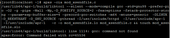

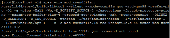

Compile and install
apxs -cia mod_xsendfile.c
Getting an apxs command not found error....

ok, figured out why I was getting that error and I think I have that resolved, but now I'm getting this when I go to compile the mod.

9 years 1 month ago #273648
It says that you don't have gcc. So you'll have to first install gcc on your server.
