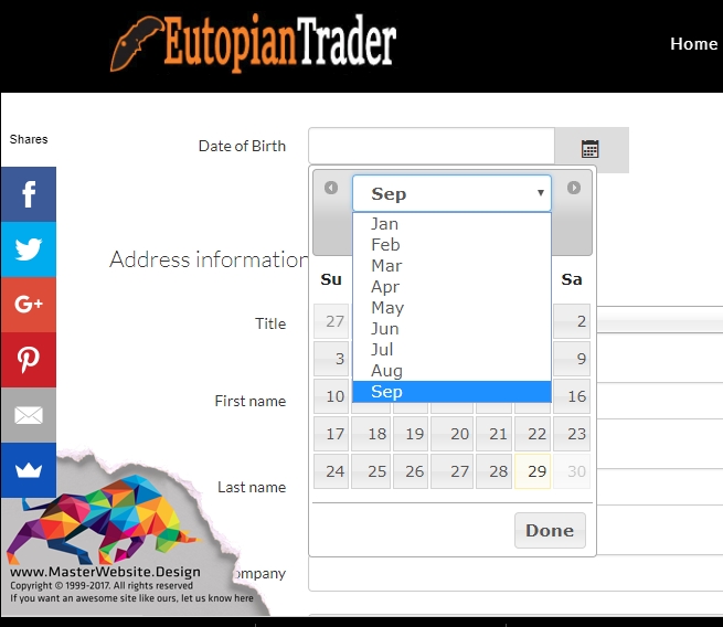

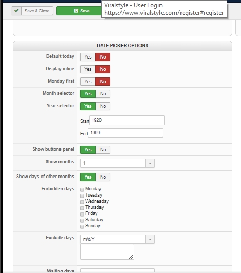

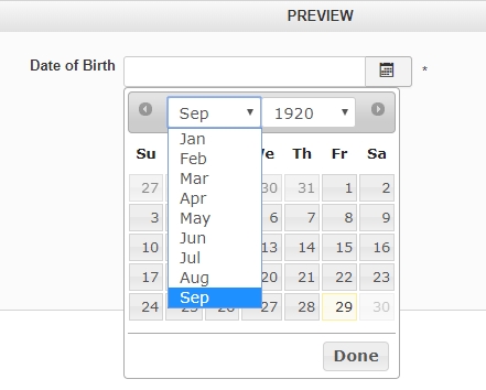

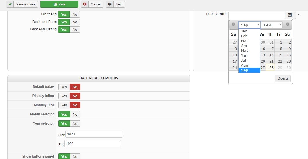

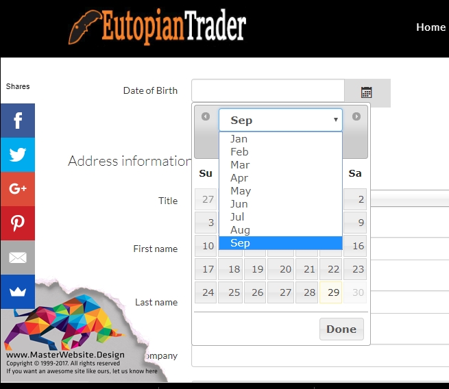

I hope I am not losing my mind here, but I had added a new field for my customer signin where I added a Date of Birth field and I chose to use the Advanced Data Picket in the hopes of making this a required field with a verification to set it so that a new user would have to enter a date that would show that they were 18 years old or older. I set everything up, but oddly, the month of October is not an option to be chosen.
I also set it up so that Start Year was 1920 End Year was 1999. The idea was that they could not pick a year for their DOB past 1999 as that would indicate they were over 18. Well for the most part it works, but I have found that if you choose a date and then change in in the same session, it doesn't always accept the change. It's almost like your first chosen date is stuck in the cache and unless you close the window and go back in, you can't select a new date. Also, again, the month of October is not available in the list of months and I am not sure why.
For now, I have to remove the date validation and just choose the simple date picker because the advanced date picker seems to have a number of issues. Can someone let me know what info you may need me to provide to help you look into this issue? If you would like to access to see what I am seeing, please let me know. Also, let me know and I will turn the Advanced Date Picker back on so you can see the issues I am seeing.
The attached SS should show you most of how I have it setup and the fact that OCT is missing from the choices of months.
Thanks!
(HikaShop Business 3.2.0 [1709061916])

We would need:
- instructions to reproduce the problem on your website.
- screenshots of all the settings of the custom field.

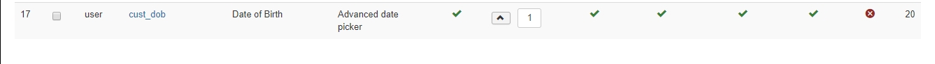

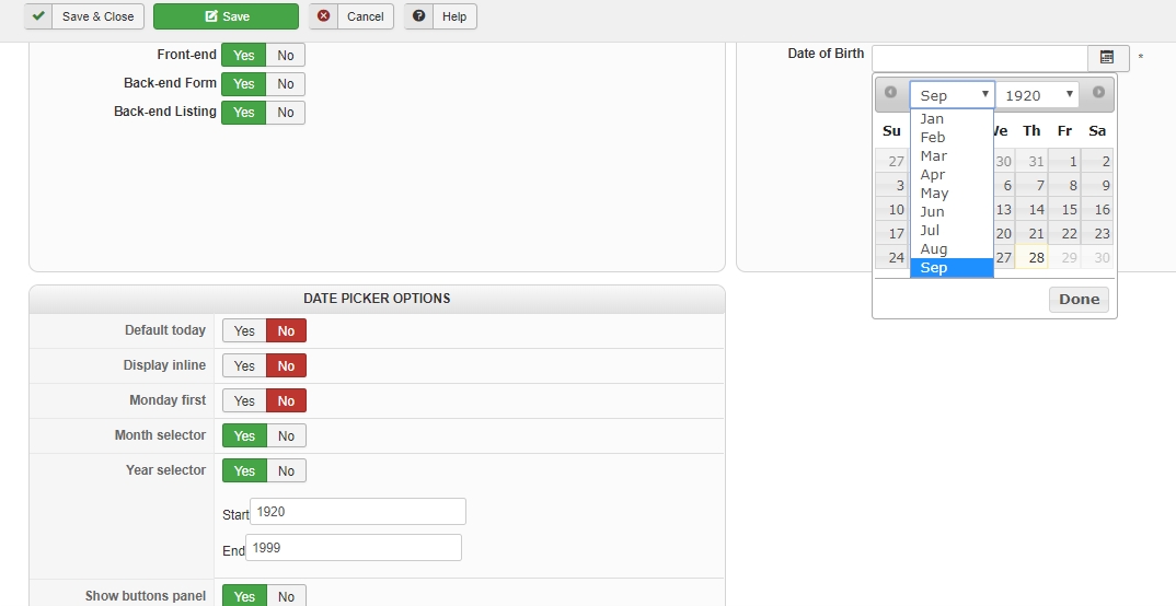

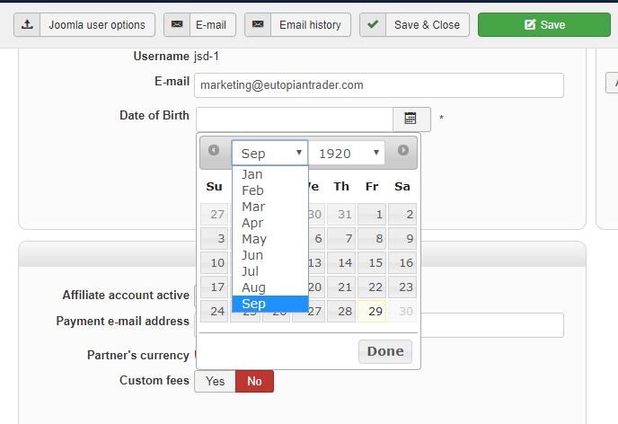

It looks like since we upgraded to 3.2 the issue with not being able to reselect the year once you have already selected it has disappeared, though that could have also been a cache issue because right at the same time I upgraded my browser and that problem is not reproducible as of today. However, the missing October is still an issue.

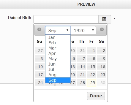

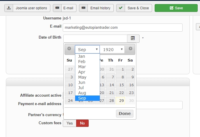

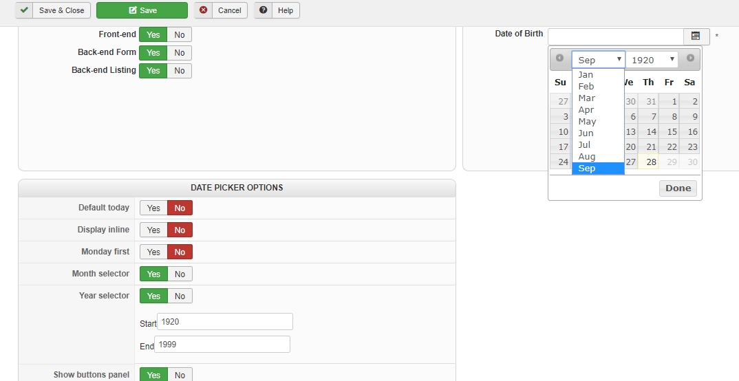

To reproduce this, create a new field in display / new field called DOB. Set up the new field using the Advanced Date Picker and configure it per screenshots.
Use the Test Calendar, edit hikashop / User, or use the new user registration form and select the DOB field opening the calendar and you will see in all places that October is missing from the choices.
The important thing is to set the dates to only show past dates, and set the start year to 1920 and end year 1999.
This should be easily reproducible. If you need any other information, please let me know exactly what you need and I will provide it.
The screenshots should be in the order in which this was configured / tested. ie 1. Create New Field, 2. Configure, 3. Test in the configuration using example calendar, 4. Test HikaShop User Editor, 5, Test New User Registration (using the Joomla to Hikshop user registration plugin.
Thanks!

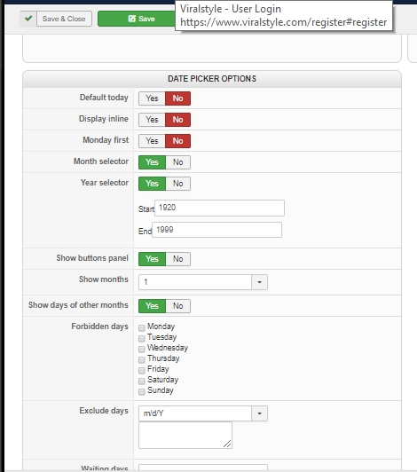

What settings are you missing? I attached the screenshots that show every single setting, not one was missing from the screenshots. If you need me to list them instead of using the screenshots I can do that but I thought it would be easier to configure your end to the screenshots.
Please let me know what settings your missing or if you need me to list them out, but I did provide every settings they are just in the screenshots.
There are 6 screenshots attached to the previous reply showing every setting.

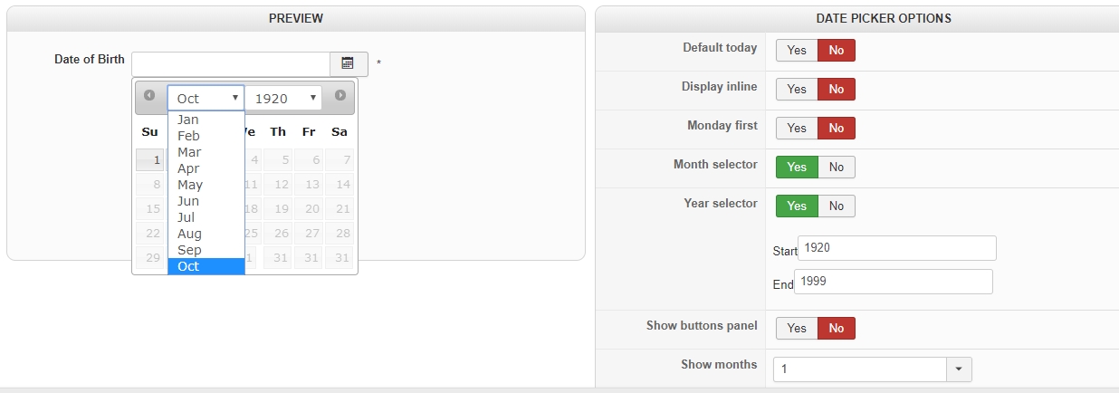

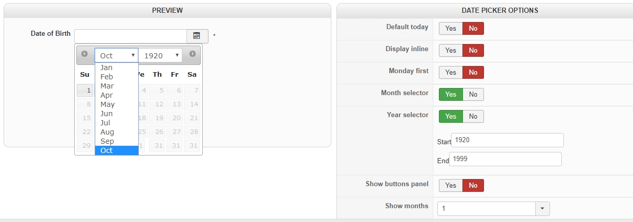

I was able to get in the back end this time but am not getting this error in the demo site
Warning
Copy failed: /web/administrator/components/com_hikashop/falang/hikashop_category.xml to /web/administrator/components/com_falang/contentelements/hikashop_category.xml
However I was able to reproduce the missing months. If you check for the field Date of Birth, and you use the calendar example you will see that now the months November and December are missing from the drop down box for the month. See the screenshot.
This is the same problem I am seeing. So it appears that all months from the current month until January become missing.
  • Posts: 86101
  • Thank you received: 14203
8 years 11 months ago #279671
Well, we've done further tests and apparently, this only happens if you set the "allow" setting to "past dates" in the settings of the custom field, and that setting wasn't in your screenshots nor did you say anything about it so of course I left it with its default value to allow all dates in my first tests.
Anyways, that restriction on past dates is enforced in the date picker library we're using to display the date picker which apparently doesn't work fine with the restriction on the years. So I would recommend to keep that "allow" setting to "all dates".
