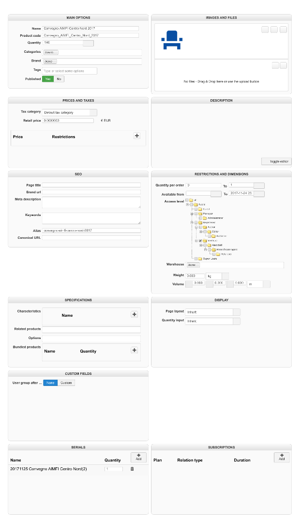

8 years 11 months ago - 8 years 11 months ago #283188 by joomleb
so, I made the modification and:
1 - I have back the message: "Product not found"
2 - I attach the screenshot of the product settings. PS In Menus, the "Event" public menu is setted with alias as "convegno-aimfi-centro-nord-2017"
3 - "URL you're using to access that error page" - Here the product Menu Link on the copy test site
Thanks for support !
Last edit: 8 years 11 months ago by joomleb.

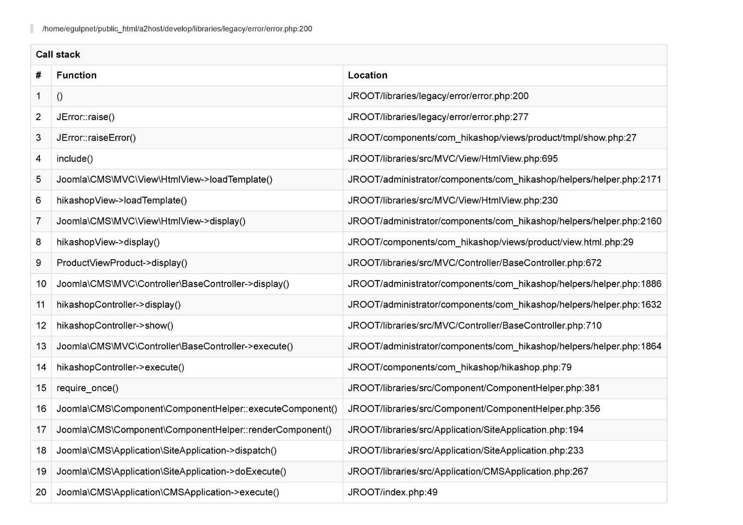

8 years 11 months ago #283192 by nicolas
What I see on the like you gave and hat you reported so far is different.
On that link, I have that:
monosnap.com/file/AcTbS0L3G0fIpABmRJyhcvJa3zatev
And looking in the details of the error, there are no files of HikaShop involved with that error.
It seems to be a Joomla content menu item trying to display a Joomla article it can't find.
So I'm confused.
How do you get to that "Product not found" error page ?
Do you also have that "article not found" error when you try to access the link you gave ?
How did you configure the menu item of that link ?

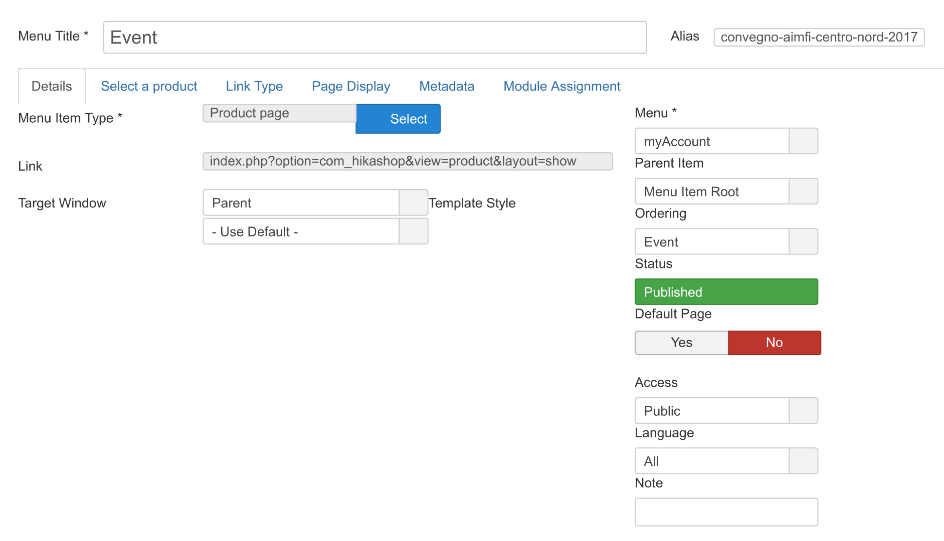

8 years 11 months ago - 8 years 11 months ago #283242 by joomleb
thanks for helping:
1 - "Do you also have that "article not found" error when you try to access the link you gave ?" I'm too sorry, I made a mistake, I corrected it .
2 - "How do you get to that "Product not found" error page ?" = After trying I came back to the original file components/com_hikashop/views/product/tmpl/show.php. So now I have back the blank page. Please, let me know if I have to swith again to your modified file.
PS Menu Access: Public - Event Product - RESTRICTIONS AND DIMENSIONS - Access level: "XXX" - If the user is not assigned to that usergroup = blank page
Menu Access: Public - Event Product - RESTRICTIONS AND DIMENSIONS - Access level: "XXX" - If the user is assigned to the "XXX" usergroup = the Product page is shown rightly
3 - "How did you configure the menu item of that link ?" Here attached the setting image:
8 years 11 months ago #283244 by nicolas
Can you make sure that you selected a product under the "Select a product" tab of your menu item ? And make sure that this product is published.
8 years 11 months ago #283264 by joomleb
A - "Can you make sure that you selected a product under the "Select a product" tab of your menu item ?" = sure, selected
B - "And make sure that this product is published." = sure, published
Infact, When a user assigned to the "XXX" usergroup (same group selected into Product > RESTRICTIONS AND DIMENSIONS > Access level ) click on the Product Menu, the Product page is shown rightly
8 years 11 months ago #283272 by nicolas
Well, that's normal then.
If you set an access level to the product, then the users using the menu item link that don't have access to the product will be redirected to a 404 error page with the text "product not found", and then your template has a problem with the display of error pages.
