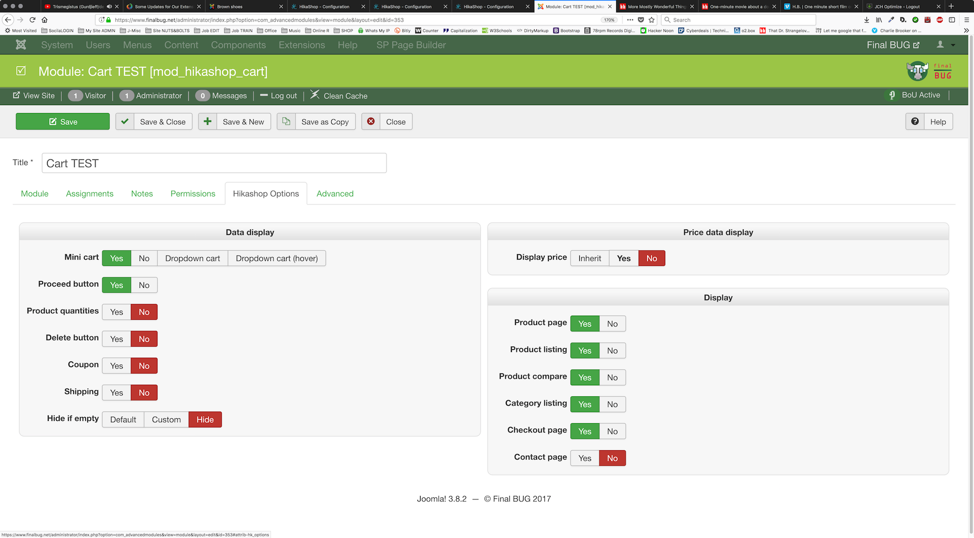

Hi Hika Shop Team
I am trying to configure the Hika Shop Cart Module
So for e.g. I am playing with the settings as shown in the first screen shot.
There are a couple of things that seem odd to me…

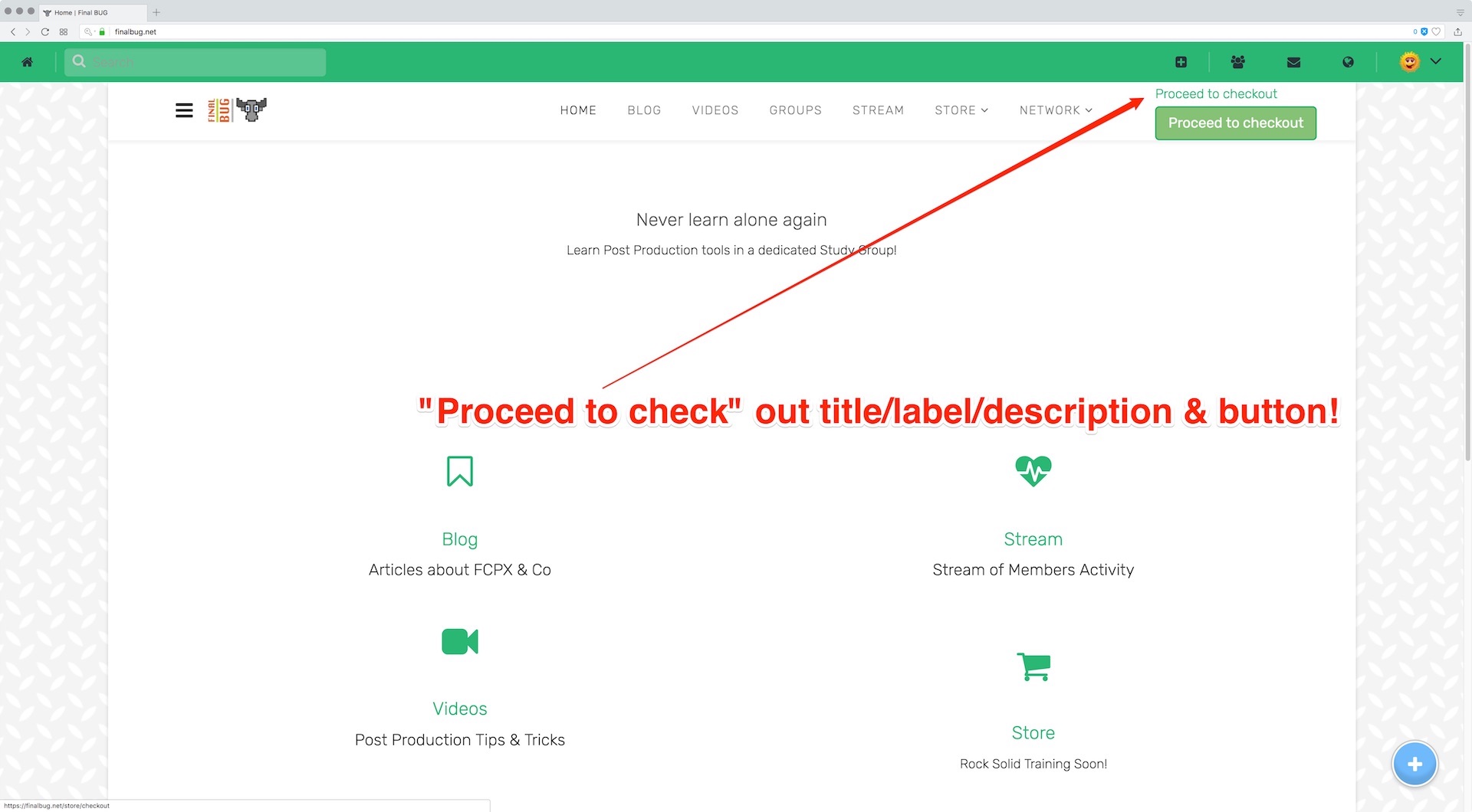

e.g. 01 second screen shot: 02Mini-cart-Yes-Front-End
Is it normal that I have a button called “Proceed to checkout” with what appears to a label/title/description above it “Proceed to checkout”?

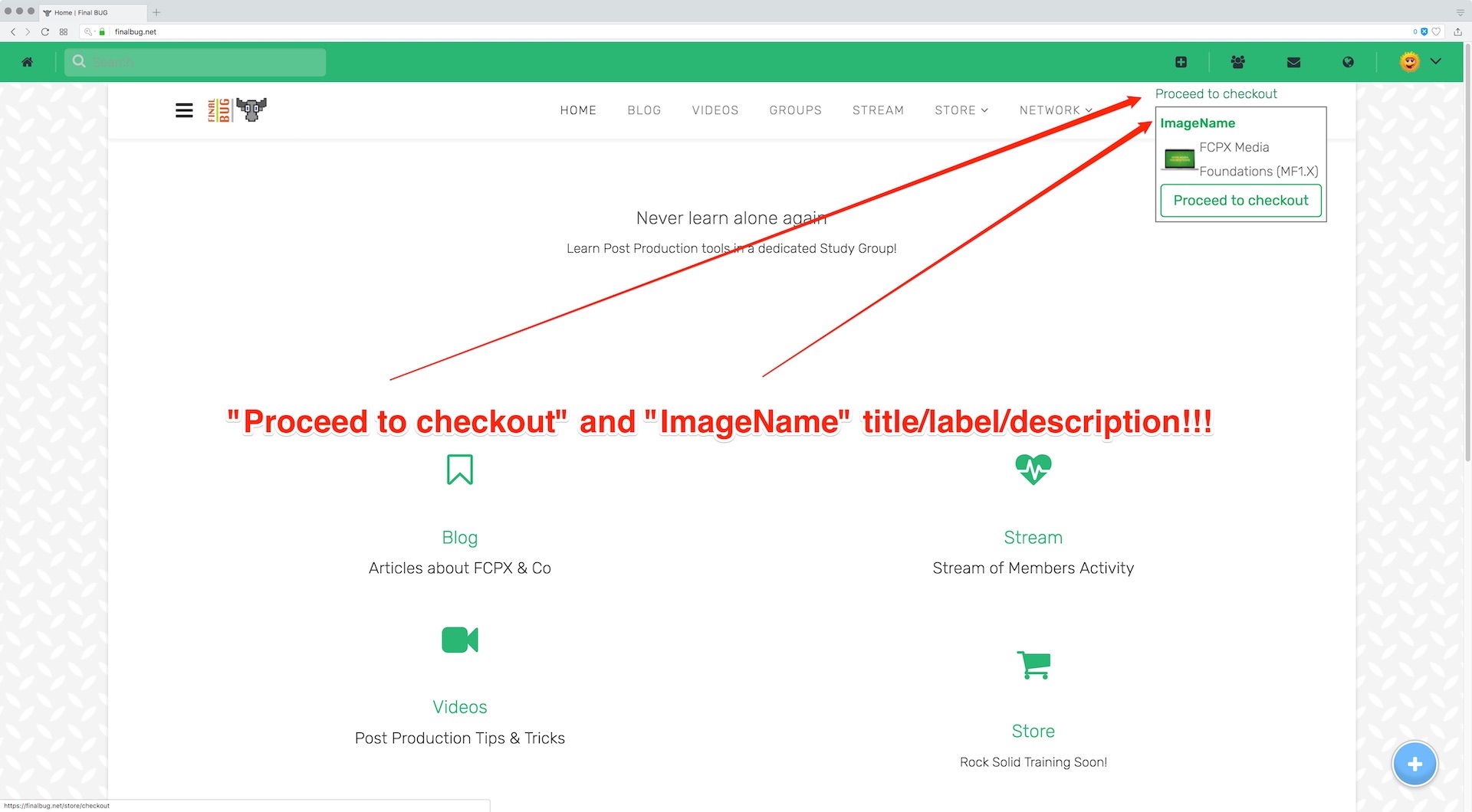

e.g. 02 second third screen shot: 03Mini-cart-Drop-Down-Cart-Front-End-Down
and
Is it normal that I have an item called “Image Name” with what appears to a label/title/description?

  • Posts: 86113
  • Thank you received: 14210
8 years 9 months ago #283817
These are not normal.
All I can think of, is either that you customized the file "cart" of the view "product" to do that, or more realistically that you added translation overrides to change these texts.

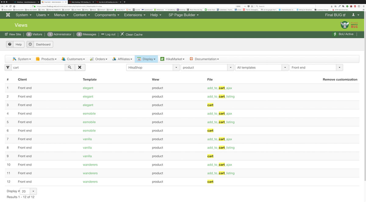

8 years 9 months ago #283856
We analyse the cart.php code, and you are just in a specific case that right know leads to this result, and so thank you for your return !
We will work to optimize the view code for our next release, but meanwhile I will bring you a solution.
Go in Main HikaShop Configuration, then go on Display dropdown and select Views :
Then use the 3 dropdown filter, to find the cart View
Then "switch off" this code part :
That may do the trick, hope this will fit your needs.

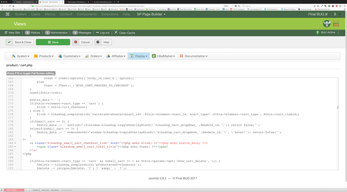

  • Posts: 139
  • Thank you received: 10
8 years 9 months ago #283895
Hi Philip
Thank you for your detailed explanation.
I could still do with some help on this.
As I am not a coder.
I went here:
And looked for line 170 where you wanted me to add code but am seeing something very different to in your screen shot:
Also I tried searching for “TOTAL IN CART X” which I can clearly see in your screen shot and I can not find it!
I am probably making some stupid mistake.

  • Posts: 86113
8 years 9 months ago #283898
I see the code Philippe was talking about at the top of the code in your screenshot... Sure the line numbers are a bit off, but not by much.

8 years 9 months ago #283944
Hi, hi
ok I know that this is Kindergarten stuff but I got my head around adding this two lines of code.
they remove the description for Mini cart = Yes
but not for Mini cart = No
i.e. I still see "ImageName" when Mini cart = No
kindly advise
Paul
  • Posts: 86113
8 years 9 months ago #283958
It's not "ImageName". It's the title "Image" for the column of the images of the products and the title "Name" for the column of the names of the products.
If you want to remove these, you can use some simple CSS to hide them.
For example:
.hikashop_cart_title{ display:none; }

  • Posts: 86113
8 years 9 months ago #283988
No, that's normal.
You have a table of products in the cart. each row can have different information: the image, the name, the price, the quantity, a delete button, etc.
So there is a title on top of each column of the table, like on any other listing of HikaShop.
You can add your CSS to the style CSS of HikaShop under the Display tab of the HikaShop configuration:
