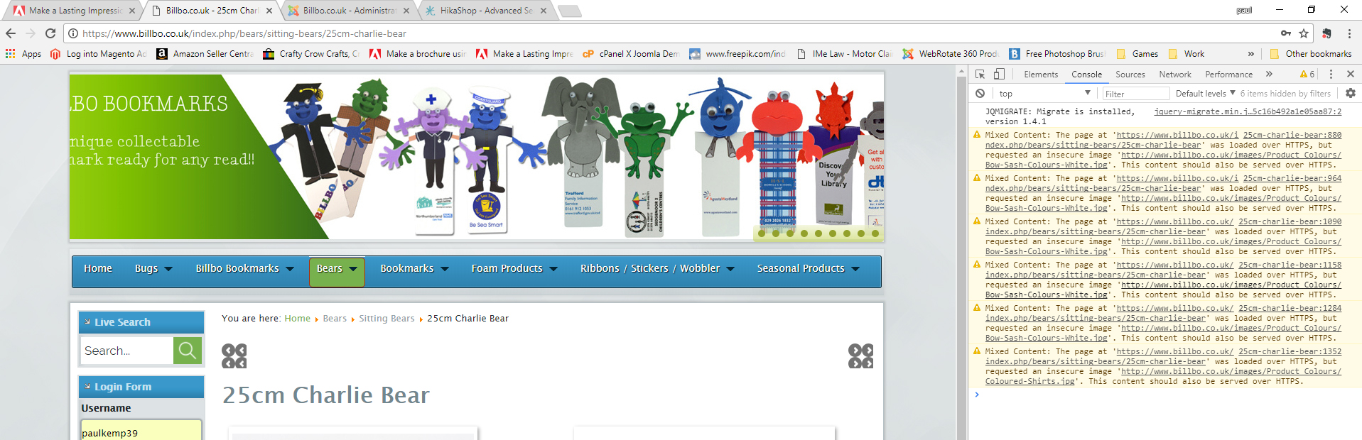

I have just setup my website with a ssl certificate and set joomla to use the https protocal.
All works fine but when I go to certain products I get the warning that there is mixed content.
How can I get these products to use the https like the other products on my site.
I have attached a pic of the error.

If you look at the URL of the image, it's the image that you've added in the description of your product:
monosnap.com/file/VleMZDyElubMGOe88sEAnuRDLvdYPo
So you need to edit it and change it to use https.

Thanks Nicolas,
Dont know why I didnt spot that myself, long day I guess.
Thanks Paul
