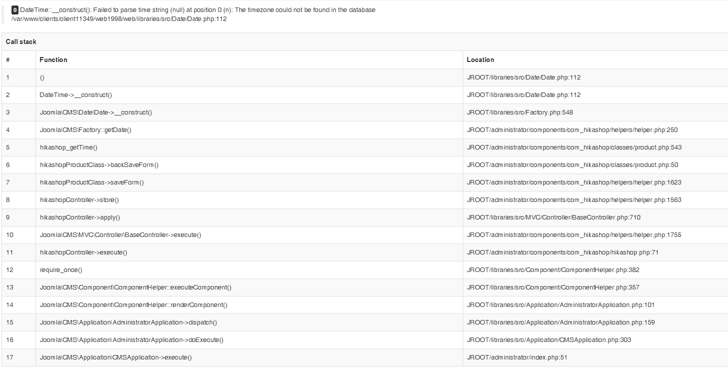

-- Error-message(debug-mod must be tuned on) -- : DateTime::__construct(): Failed to parse time string (null) at position 0 (n): The timezone could not be found in the database

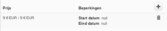

Good day,

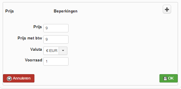

After installing the Hikashop component I want to create my first product. After entering te prize and saving the record I get this error message:
'DateTime::__construct(): Failed to parse time string (null) at position 0 (n): The timezone could not be found in the database'
What do I do wrong?
Thanks!
