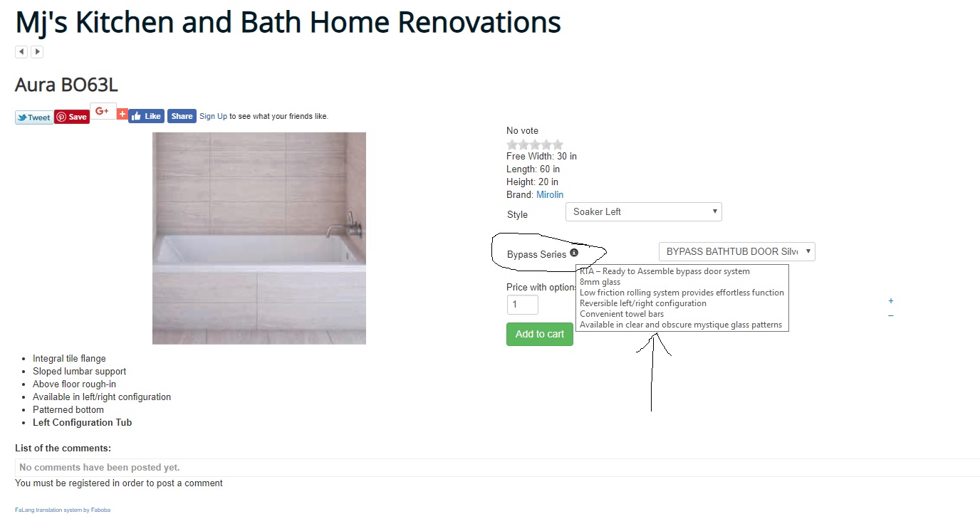

I added the Option "Bypass Series" to the Product Aura, the Option "Bypass Series" has two active Variants. While the variants show on the product Aura, their variant descriptions do not...it only shows the default description.
In addition the Option is Optional, I am really having difficulty with being able to allow options the client can pick but are not mandatory. Just about every product for a Bath and Kitchen renovation has options that are NOT mandatory. FOr example: client picks a bathtub....it has several Variants based on left side install right install which are mandatory to select. BUT Optional to this are the doors that surround the Bathtub which are in their own respective Category and also optional drains and hardware they MAY select as an Option but are not Mandatory. I will have several thousand products to create with Options that are optional and also as above those options are actual products with their own variants ion which the variant description must show when they select that Option.

1. The description icon on the option name is supposed to be the description of the main product of the option not the variants. So it's actually normal it doesn't refresh when you change the variant selected in the option.
We didn't think it would make sense.
I personally still don't think it would.
Moreover, if you want to change that, it won't be so easy as the tooltips are initialized by Joomla when the page is loaded. So changing the content of the tooltip dynamically would require some custom javascript to clear the tooltip and reinitialize it.
It's not impossible to do if you're a developer and you know well PHP/javascript but otherwise I don't see any way to do that.

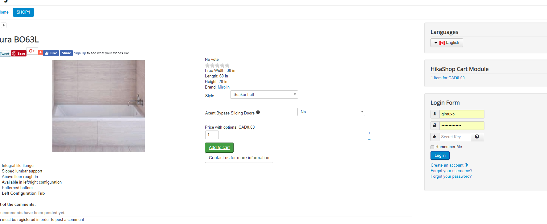

You will have to do this to every template you have active on your Joomla site if you want each Option you add to have a No selection so that the customer is not forced to add an option to his Product purchase and bonus is the Options that are selected as No will not show up in the cart which would potentially confuse the client. (In the example below you see that the Axent Bypass Sliding Doors is an option and the client selected no so on the right hand side in the cart you only see one item which is the Soaker left Bathtub variant without listing Options the client selected as No.
