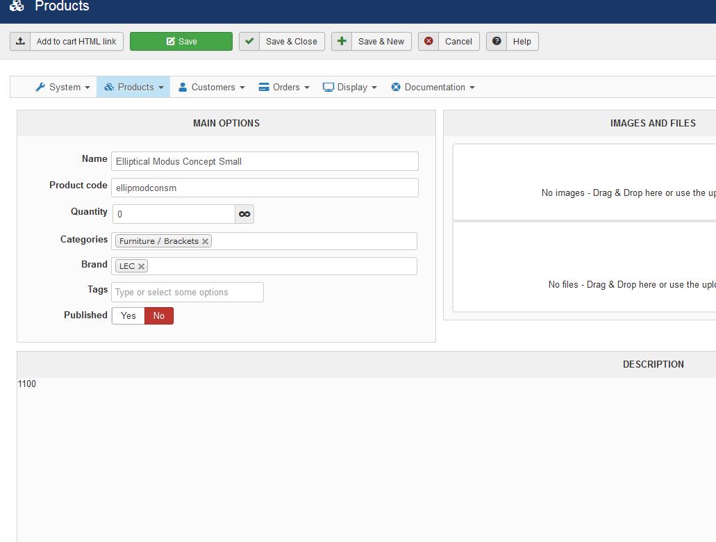

7 years 7 months ago #302321
Hello, so this is the code I'm implementing in the form.php page;
<?php echo $this->editor->width = 1100; $this->editor->display(); ?>
This results in the following display in the product editor page;
  • Posts: 86101
  • Thank you received: 14203
7 years 7 months ago #302331
Sorry, the code I gave is wrong.
It should be:
<?php $this->editor->width = 1100; echo $this->editor->display(); ?>
