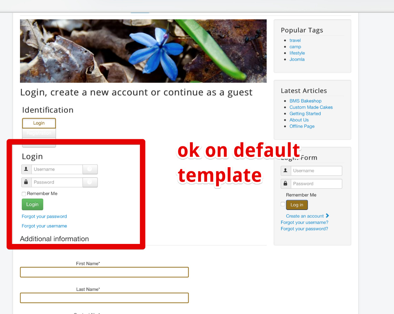

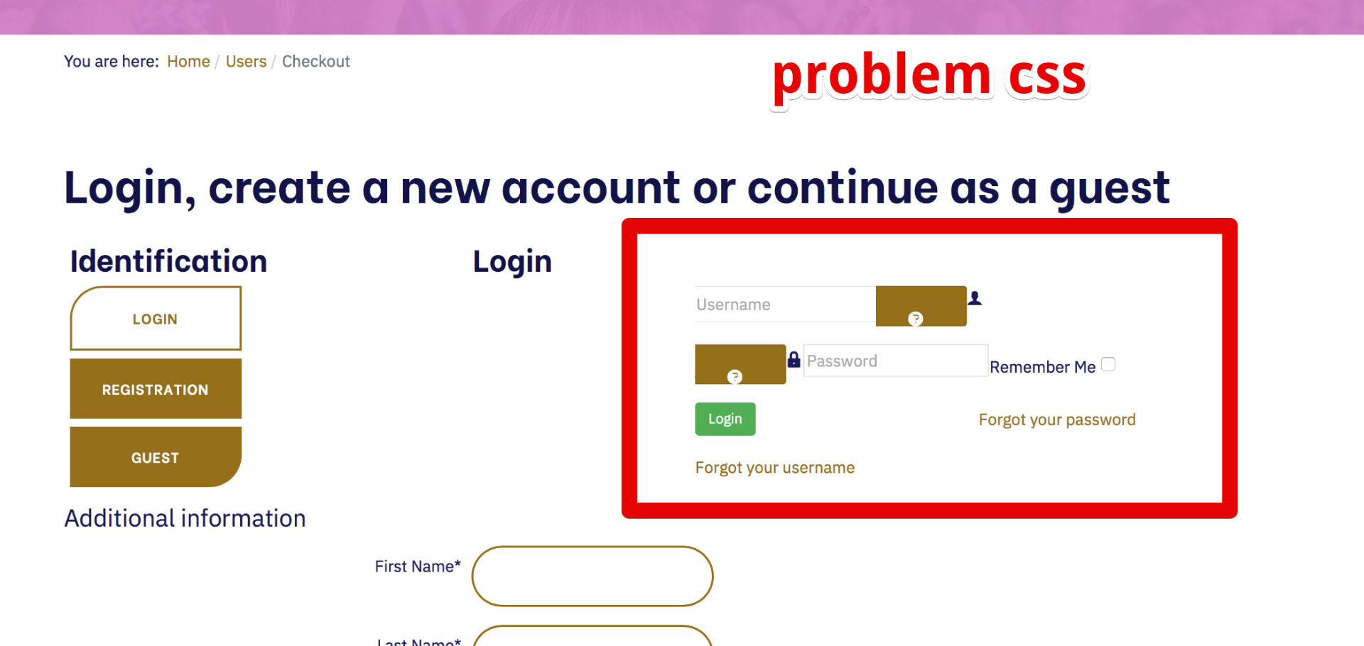

hi
i have a tempalte using bootstrap 4 from joomlart.
the login looks wrong on the checkout page my options are below
and i cant correct it. tempalte developer is asking if hikashop can work with BS4?
if not how to make the login on the checkout form inherit template style?
please see that photos.
Last edit: 6 years 2 months ago by ronron.
  • Posts: 86101
  • Thank you received: 14203
6 years 2 months ago #321779
You must have the "use boostrap v2 design" setting activated in the "advanced" tab of the HikaShop configuration.
I would recommend to turn that off since your template is not using bootstrap 2. Then it will display properly.
