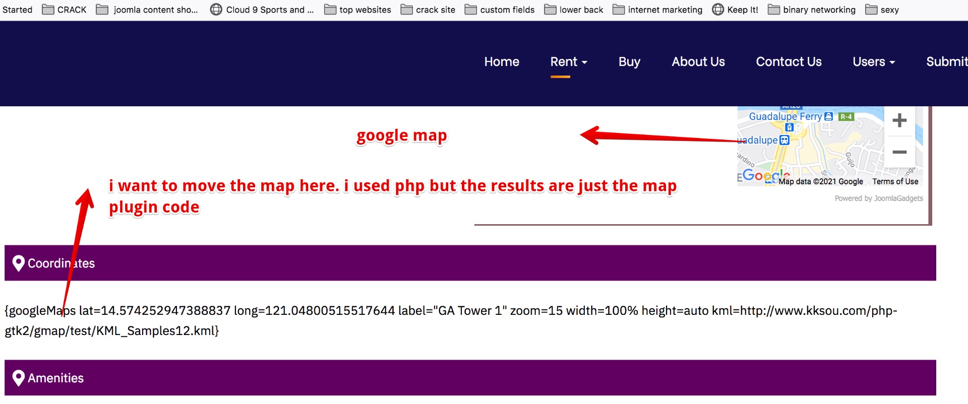

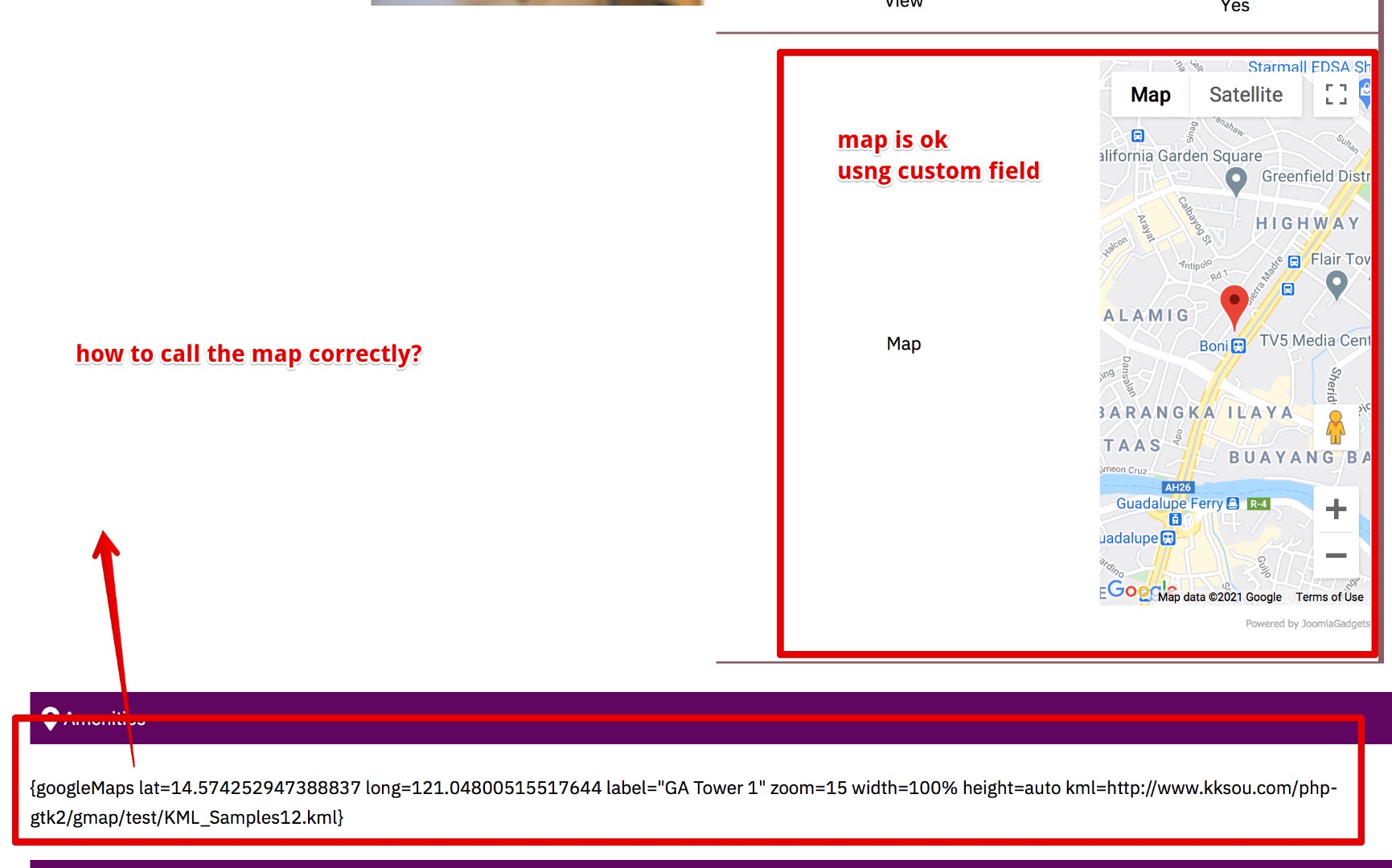

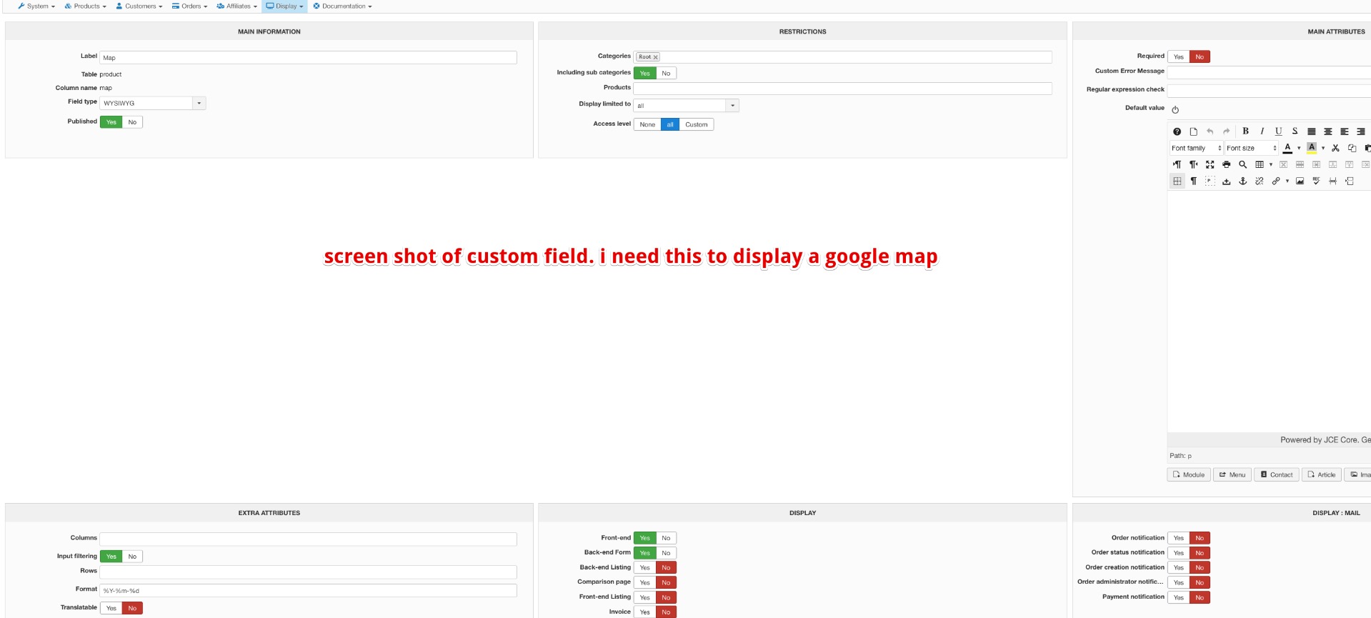

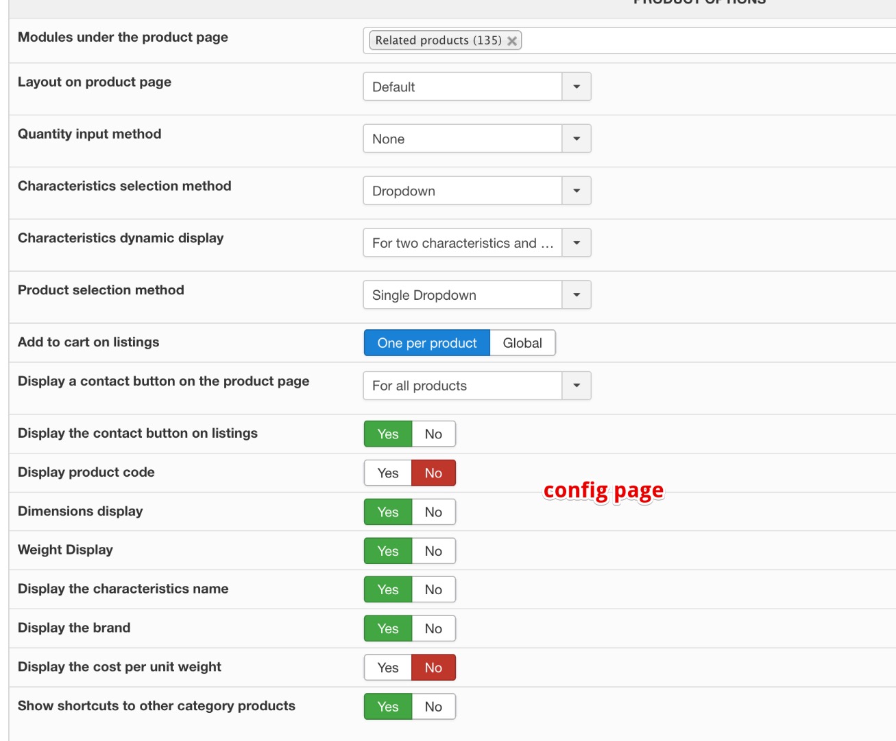

5 years 6 months ago - 5 years 6 months ago #330851
by ronron
Replied by ronron on topic questions of custom fields
hi nic
thanks for the quick reply and sorry forgot the ss.
Please see attached it.
This is the custom field configuration
This is the url of the page affcon.net
As you can see google map is working fine but It is displayed on the right side of the page. i want it to appear below and not on the right. i used php but the result is not the map but the code plugin
this is another ss
This is hikashop config
this is another ss

5 years 6 months ago #330853
by nicolas
Replied by nicolas on topic questions of custom fields
Ok, so your question is about how to handle the display of a custom field so that the content tag in it is properly replaced by the corresponding plugin.
That's quite simple. Instead of:
$this->row->map
you need to use:
JHTML::_('content.prepare', $this->row->map)
$this->row->map
you need to use:
