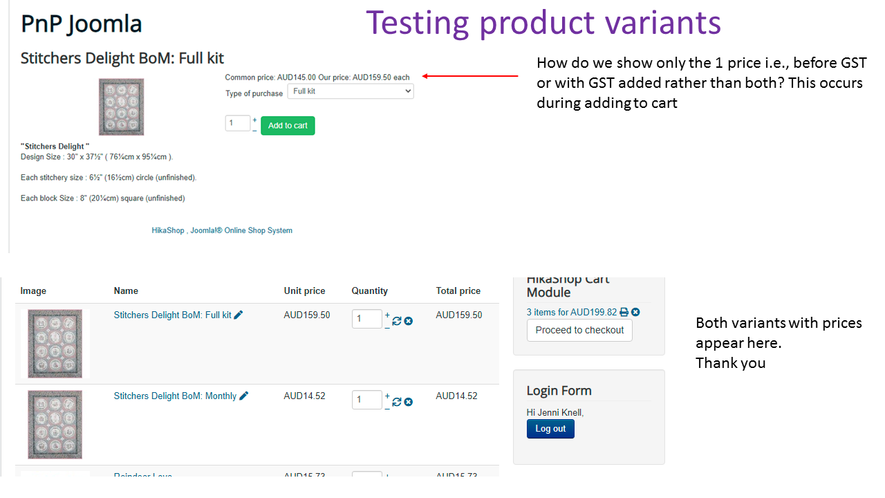

Nicholas
After reading carefully and following you I was able to get both variants in the cart. Thank you
I notice that during the variant selection within the cart I can see the pre & post GST (tax) prices. Can we choose either one?
See attachment
See attachment
5 years 6 months ago #331980
by nicolas
Replied by nicolas on topic Multiple purchase options for producr into cart
What you see on your screenshot is because you've entered a "retail price" in your product / variants.
Make sure that this field is empty and you'll get only the second price displayed.
