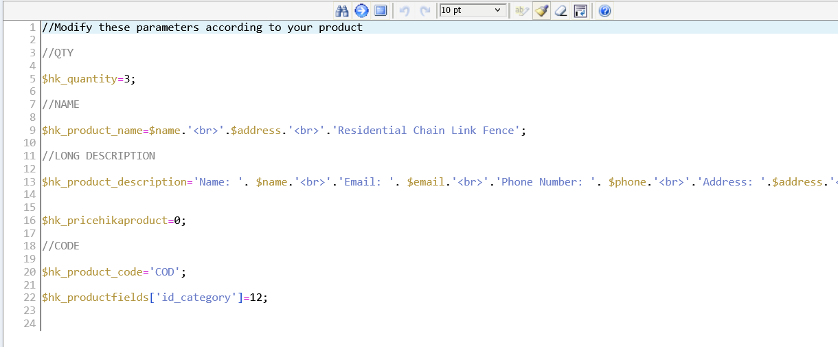

Sorry - that's my fault. I don't quite know how to figure out the names for these things.
I've attached a screenshot showing some of the PHP code that is creating the Hikashop products from Calcbuilder results.
So, for instance, it uses the code $hk_quantity to limit the quantity of each "product" to three.
I want to add a line of code that works on the "limit" you mentioned, and limit it to one. I tried just using $hk_limit, but since it doesn't work, I assume that's not right.
Instead of $hk_quantity, what would I start that line of code with to ensure that the quantity on the created product is limited to one?
  • Posts: 86114
  • Thank you received: 14210
2 years 8 months ago #357815
Ok.
You won't be able to create the limit in there.
To be able to create the limit, you need the product id. And in this code, you have yet to create the product, and thus, the product is not yet known.
As I said, the first thing is to check with the support of Calcbuilder to see what they recommend on how to proceed with this based on what I wrote previously.
