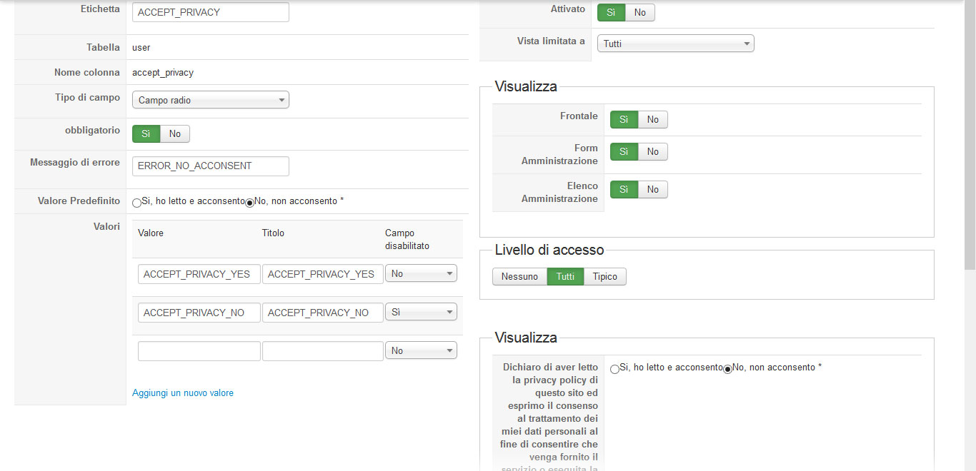

I've created a custom radio field in user tab. I've created 2 values: "Yes" and "No". Field is mandatory.
"No" is disabled and default value is setted to "No". I've filled the Error Message with a variable that I want to translate and the tested my registration form.
If I do no click over the radio to set it to "Yes", I would expect that when I click on register button, my error message would be displayed but that's not. The page just reloads, no user is created (correctly) but no error message is displayed to inform user that he must click over "Yes".
What's wrong?

Please post screenshot of your custom field configuration.

Attached you can see the screenshot of my radio button.
When I go to registration page, I fill all fields except the radio (just for testing) and when I click on register button, no error message inform me that I should fill that required field (maybe because it's already pre-filled with value "No"...?)

Uses the values "1" (for yes) and "0" (for no). "ACCEPTED_PRIVACY_NO" is not considered as an empty value. So the result is logical.

12 years 11 months ago #118919
Tested as you suggested but still same issue. Just reload the page, no user created but no message of error displayed.

Well, I missed something. "0" will not be considered as empty for the custom field system. You have to empty completely the value.
But at this moment it will not be possible to set the "no" as default, because it has an empty value.
The error message is printed when there is no value set in the custom field, so when the value is empty.
I recommend you to use a single checkbox with a value.

Unfortunatly I cannot use a single value because italian laws want that I use something like that with 2 values.
Thanks anyway. Hope you can find a solution for my case in future.
