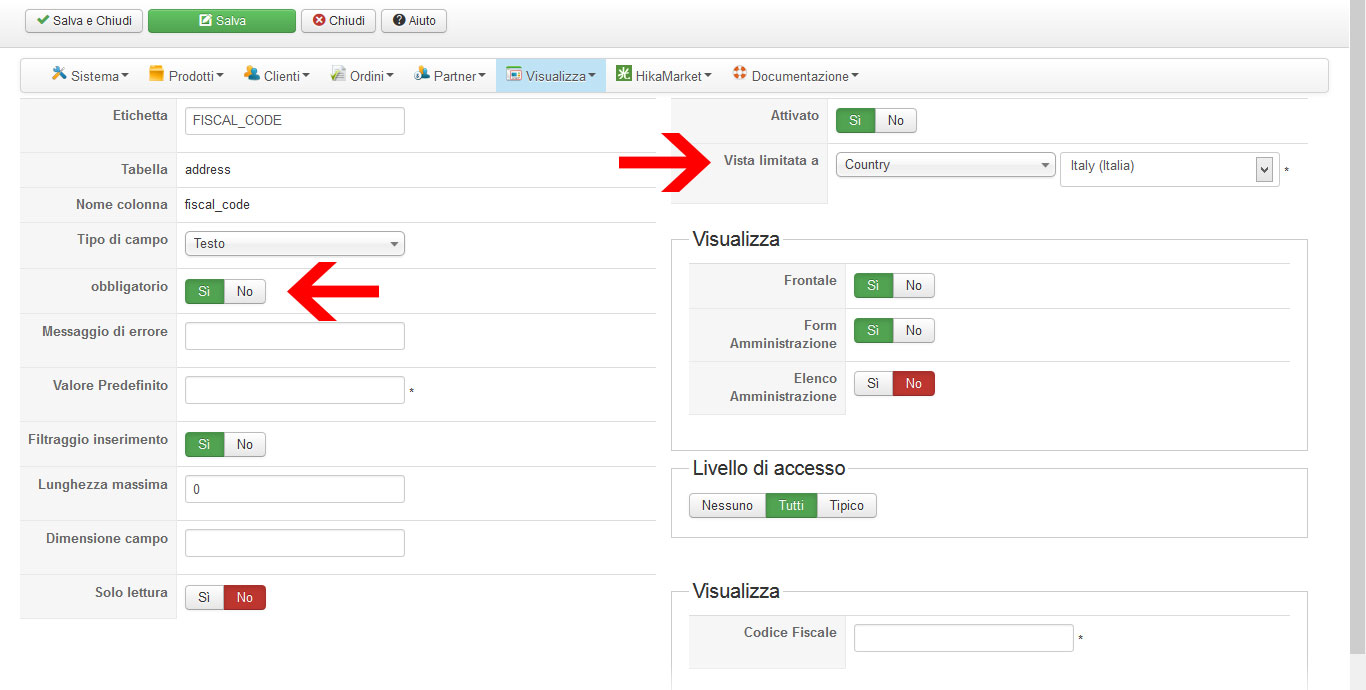

I have created a mandarory field. View for this field is limited by user country field. So if user is in Italy, this field must be shoun otherway not.
Anyway if a user from France for example try to register, the field is correctly hidden, but user cannot complete registration because an error message shows that user should fill that field that anyway is hidden.
Any solution?

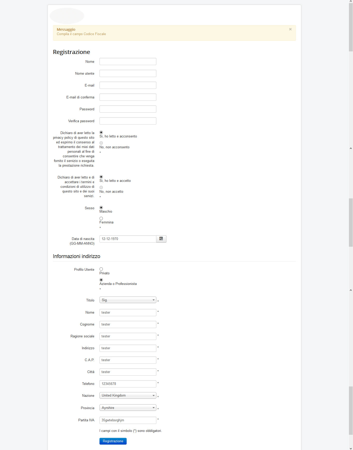

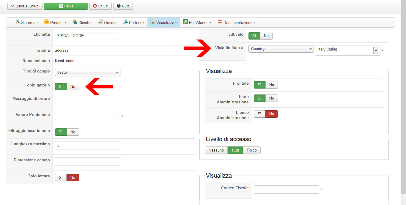

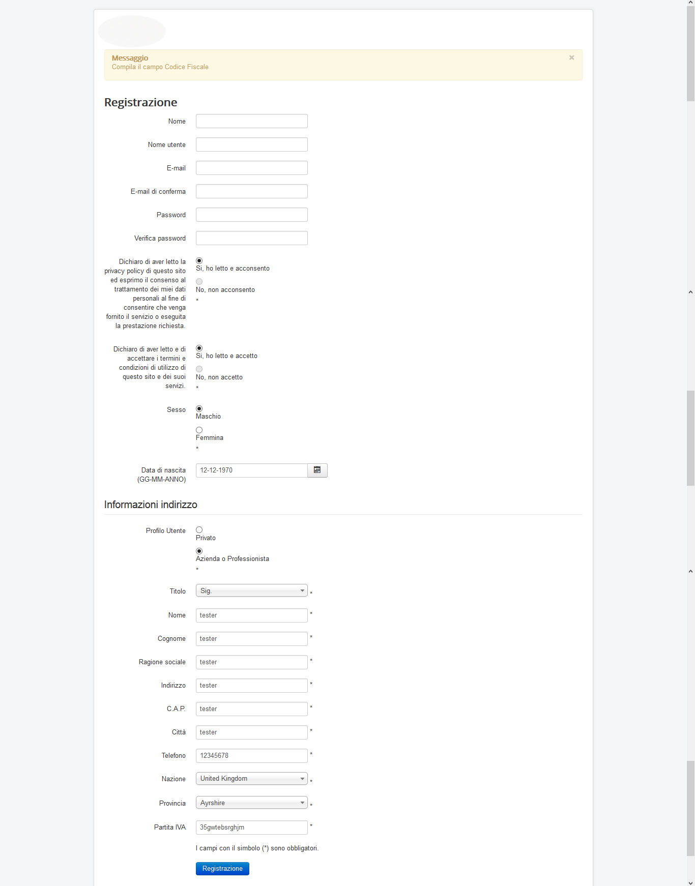

12 years 11 months ago #119226
As you can see in the attached image, I need a mandatory field to show for customers in Italy. So I've setted this field as mandatory (obbligatorio) and also I've setted it to show only if country is "Italy".
If a user from UK, for example, try to register, this field is hidden but being mandatory, when user click on register button it displays an error message that asks to fill this field but a user from UK cannot see that field because it's hidden. Take a look at second attached image where you can see the form. The mandatory field is not shown (correctly) but user cannot fill it and system says that it's required.
So, is that a bug about the condition or just need to set something to let it work fine?
