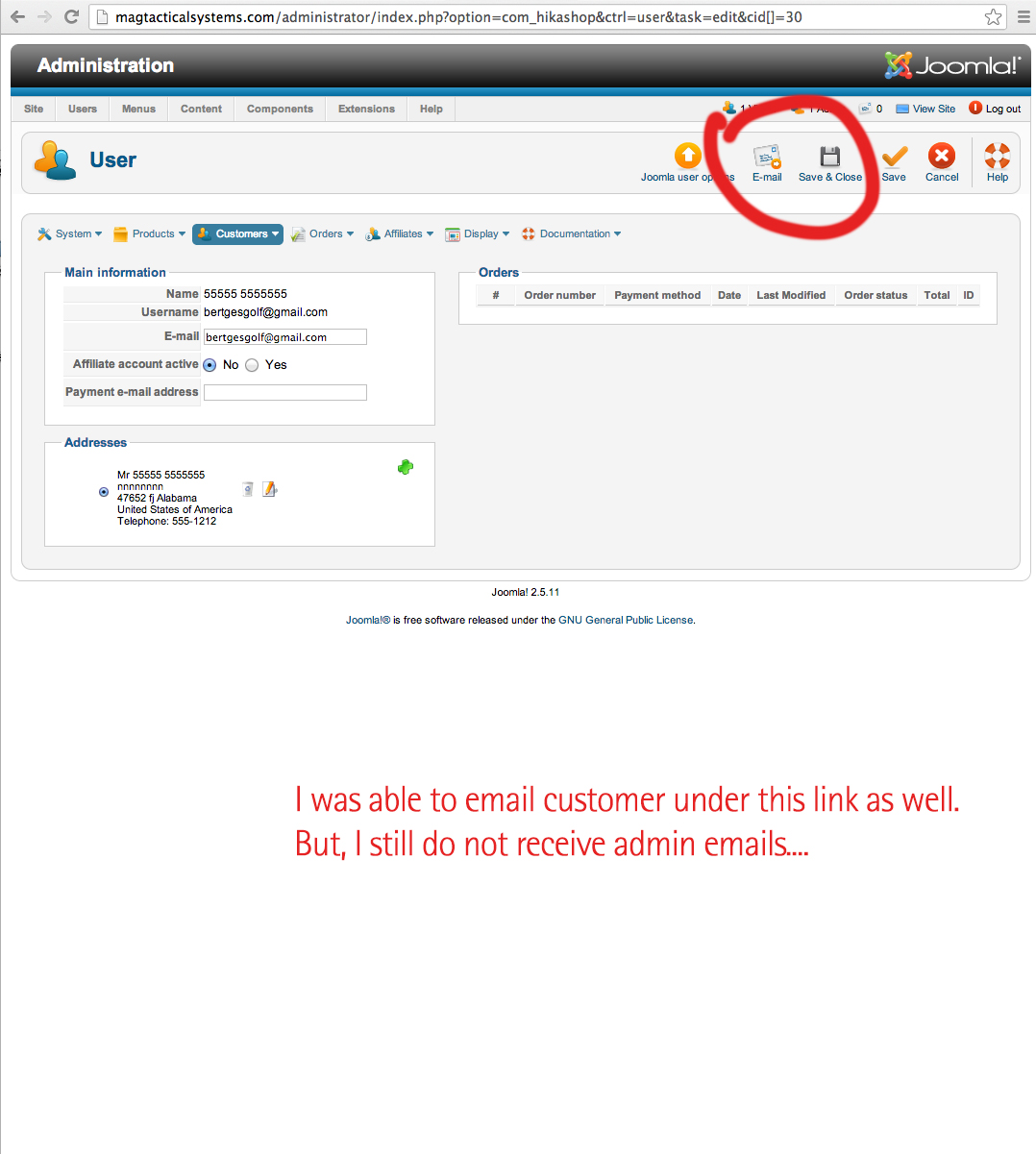

No matter what I do.... I cannot receive admin emails when customers: login/register or do anything else that call for email response. The customer does receive the emails but the admin does not.
I did add the code
echo $data->customer->email;
to the User account administrator notification file. Still no avail. the Joomla email is set up correctly as well in the joomla global settings. I am currently receiving emails from a form on frontpage through this setting, thus validating the global conf.
Look over everything I could find in this forum. Sorry to bug you if I'm doing something wrong. Also, I have all Tthe correct hikashop plugins on as well. Please advise. been working on this all day, but no admin emails.

  • Posts: 28
12 years 11 months ago #120564
Last edit: 12 years 11 months ago by johnnyb12.

  • Posts: 28
12 years 11 months ago #120584
Nothing in the spam folder.
Afeer checking this, I tried to configure the joomla mail server to a gmail account. I have done this before in another joomla site. Same thing. The user gets the email for registration, but the admin does not get anything. Also, there is no error.
...and The user both shows up in both the main joomla users group and main hikashop user group in the joomla admin panel...
Any more ideas?
