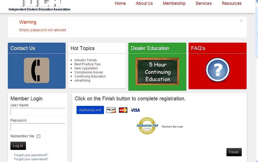

Password fields left blank and user is able to register:
I just noticed that when a member purchases membership and they are taken to the checkout page with the registration form, upon filling out the registration form and if there is nothing put into both password fields and they are left blank, the registration continues. The next page in the checkout workflow does give a warning that an empty password is not allowed but if a user clicks on the finish button it will process the registration and take the user to the next page. The user is now in Joomla. I have tested this with just using the registration form without being part of the product checkout and it does the same thing however no warning is given and after the registration is processed the message prompts the user to log in .

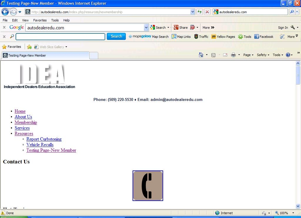

Issue with IE:
For some reason Internet Explorer is completely messed up when I have the Hikashop content module displayed on the page. If I remove the module from the article the page is fine, but when I put the module in my article so that user can purchase membership it messes the page up. See screenshot attached. Firefox and Chrome are fine.

Thank you for your suggestion. I tried jQuery Easy and it did not help. I was able to resolve the IE issue by disabling JCH Optimize and ScriptMerge.
