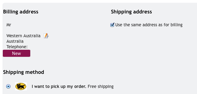

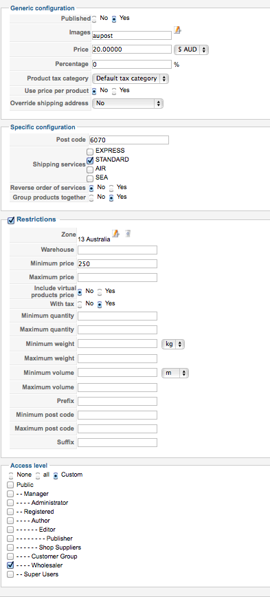

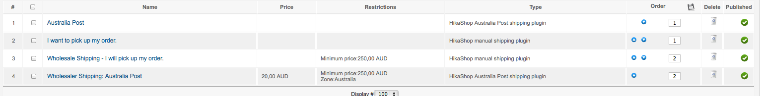

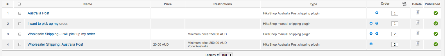

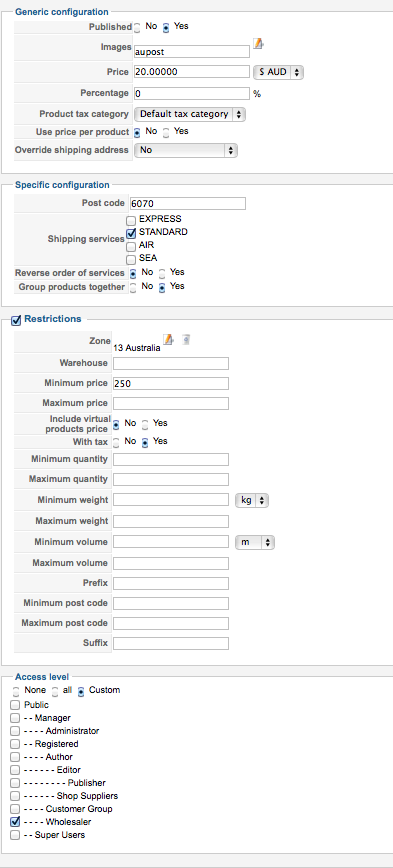

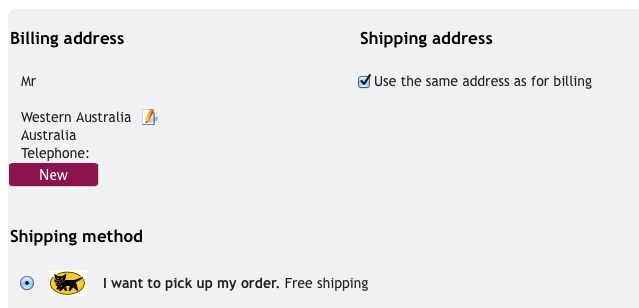

  • Posts: 44
12 years 6 months ago #141524
I have followed your description, the products are now all showing a 40% off when logged in as a wholesaler.
I am struggling with the shipping methods as a special shipping method applies for the wholesaler. I created two new additional shipping plugins for wholesalers only
1: Australia Post with $20 one off charge and minimum of $250 purchase
2: Pickup with a minimum of $250 purchase
Both plugins have the "wholesaler" Access Level.
None of them show when going to the checkout, instead the standard "free shipping" plugin is shown which should only show when the normal registered user checks out.
Thank you for your suggestions.

  • Posts: 44
12 years 6 months ago #141623
it worked out, the problem was that I did not have the full address entered in the user I was testing with. See images above, so the postage could not work.
