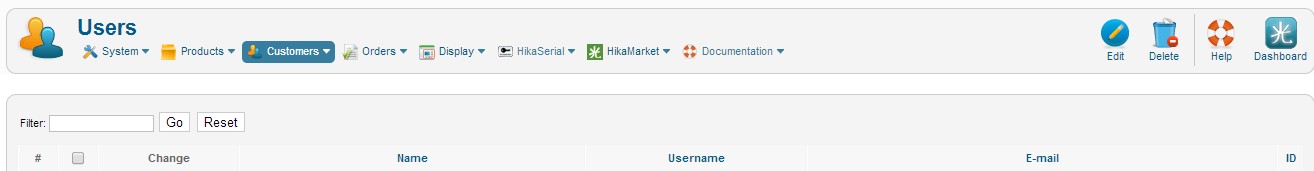

Is there a way to display (and sort) the telephone number (address_telephone from the address table) to the Customer -> User view on the backend. See the attached screenshot for more information, I would like to haave the telephone number displayed between Email and ID. Thanks for letting me know how to do this.
  • Posts: 86183
12 years 6 months ago #146458
There is no option for that. For the display, that would require to edit only the file "listing" of the view "user" via the menu Display>Views and add a query to load the address data of each user and then display it where needed. With the sorting, it's more complex. It would require to edit that file for the display but also the administrator/components/com_hikashop/views/user/view.html.php file in order to modify the query loading the users to add a join to the address table.
