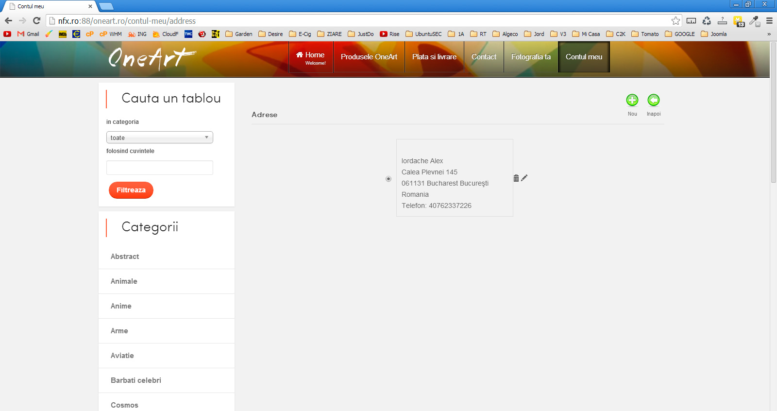

First - I have the latest Joomla + The latest Hikashop.
Second: I use the pop-up for the addresses.
My problem: when I go to My Account and then to my Addresses all I can do is erase them.
If I click on the "pencil" icon to modify it, nothing happens. If I click on + Add Address nothing happens. The only way to add an address is to make an order and use the checkout proccess to add an address where the popup does appear and I can enter a new address.

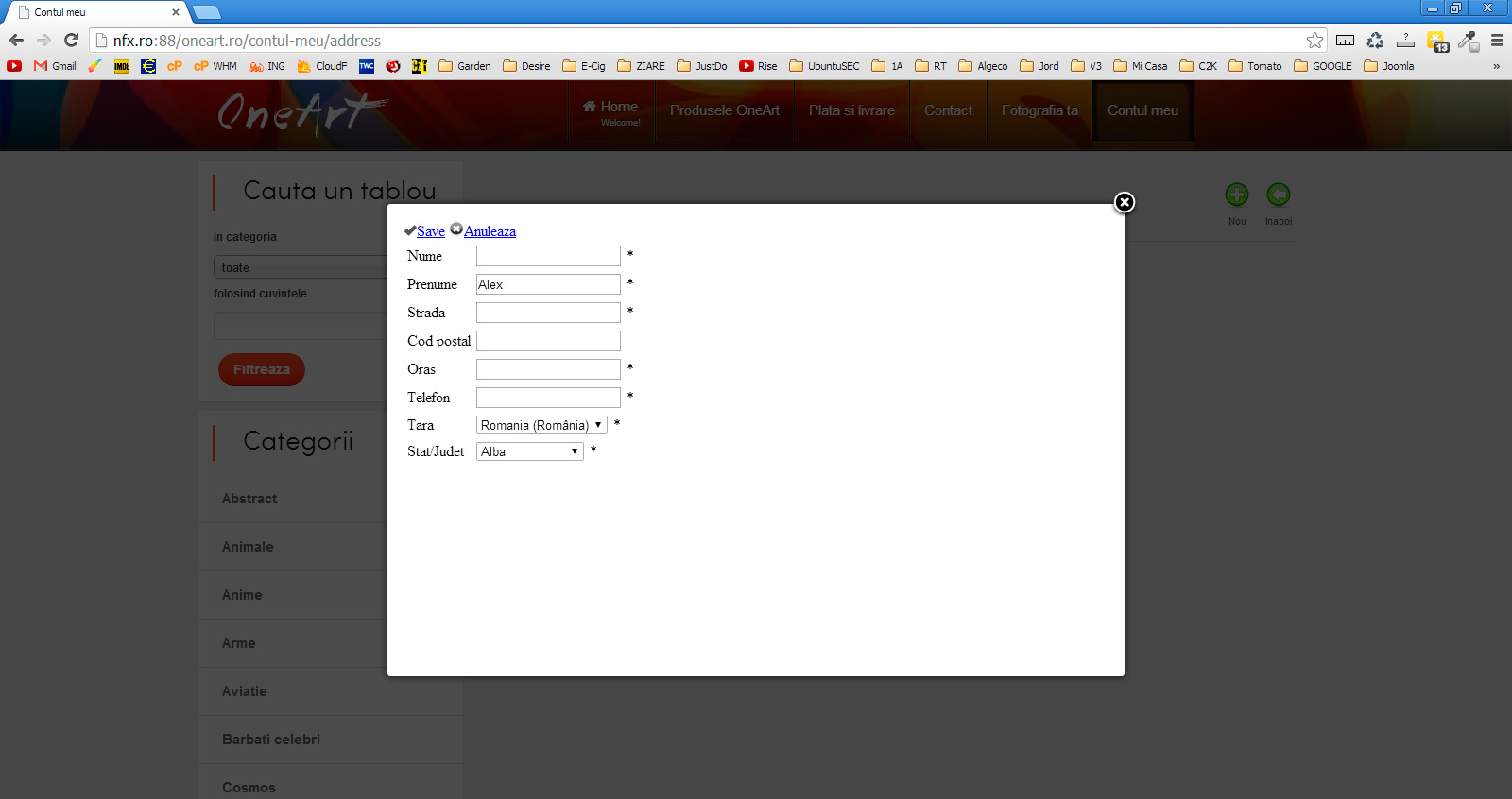

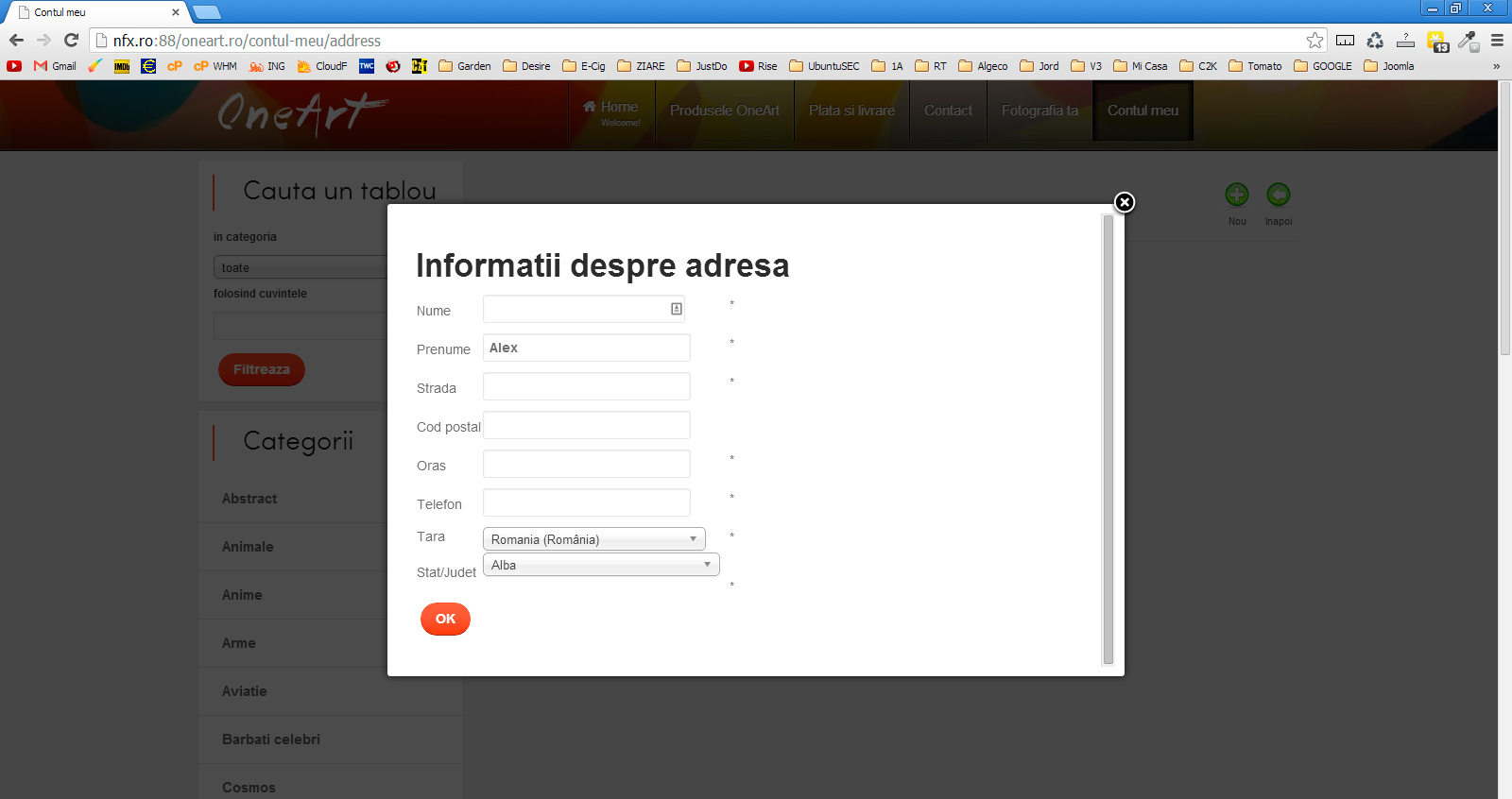

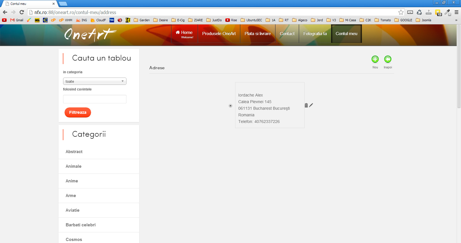

I activated MooTools and disabled the bootstrap.
I can Add addresses now.

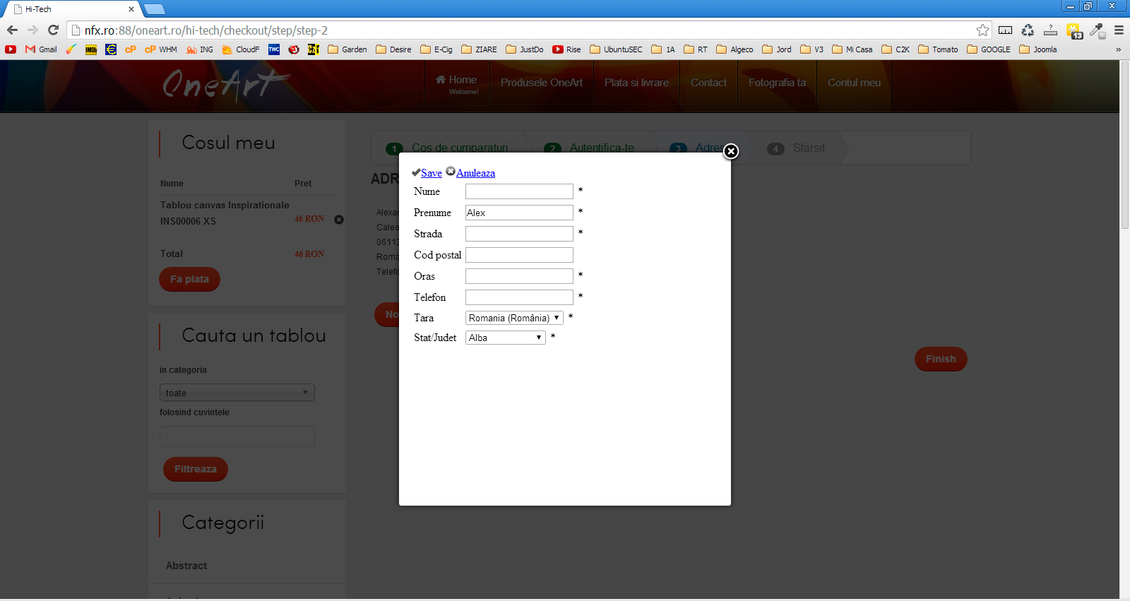

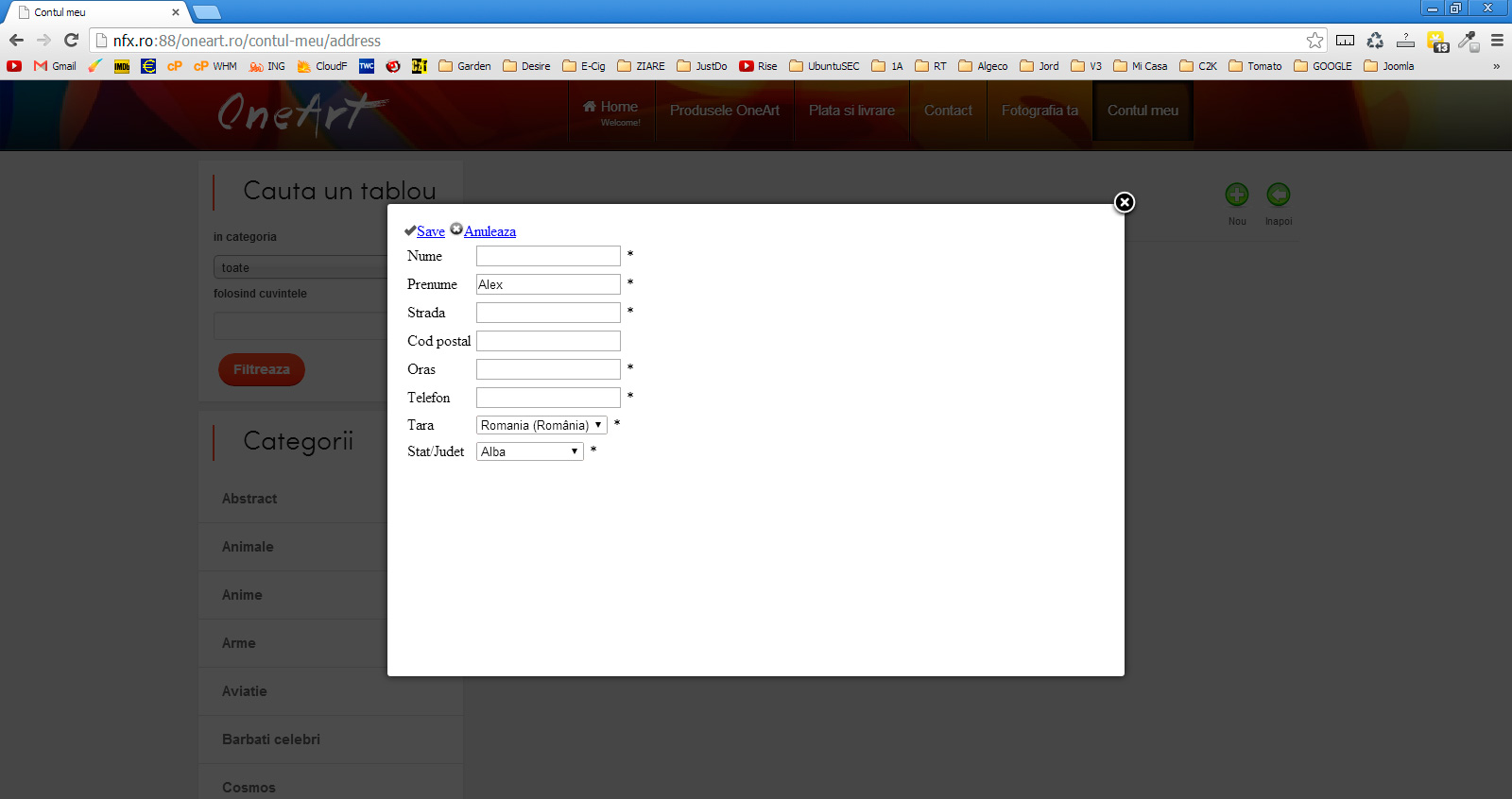

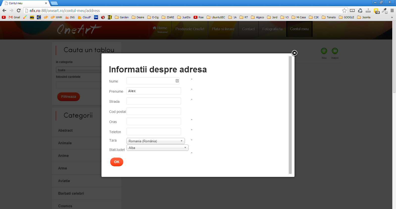

I made 3 screenshots.
1) Add Address - everything is ok
2) View Address - everything is ok
3) Edit Address - everything is NOT ok. As you can see the design is broken and the address info is not pulled into the edit form - the street, zip and other info are missing.
Please help me fix it.
Thank you.

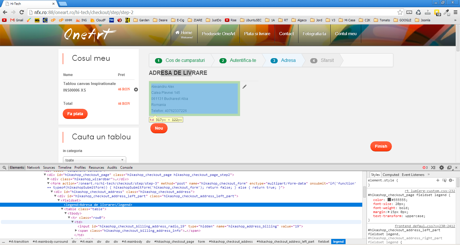

There's still a problem. If i try to edit the address during the checkout process - the same lack of template pop-up appears.
How do I solve this one?

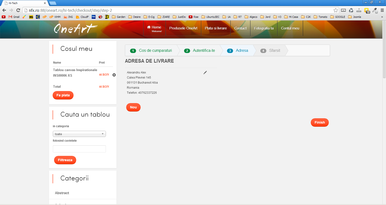

Yes, of course.

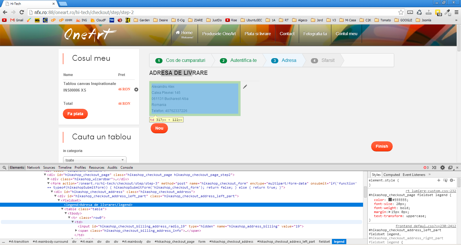

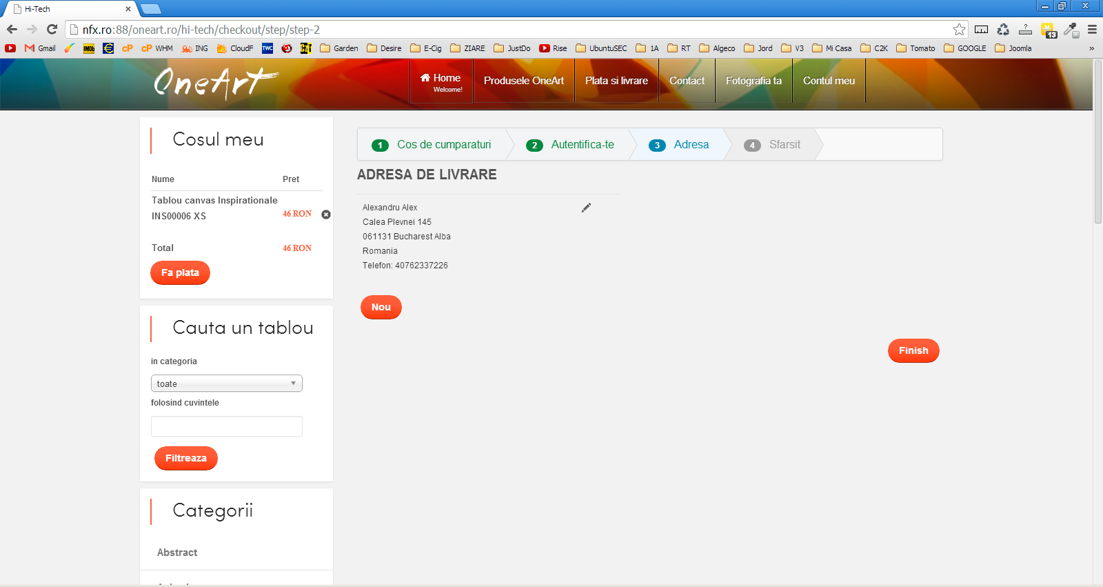

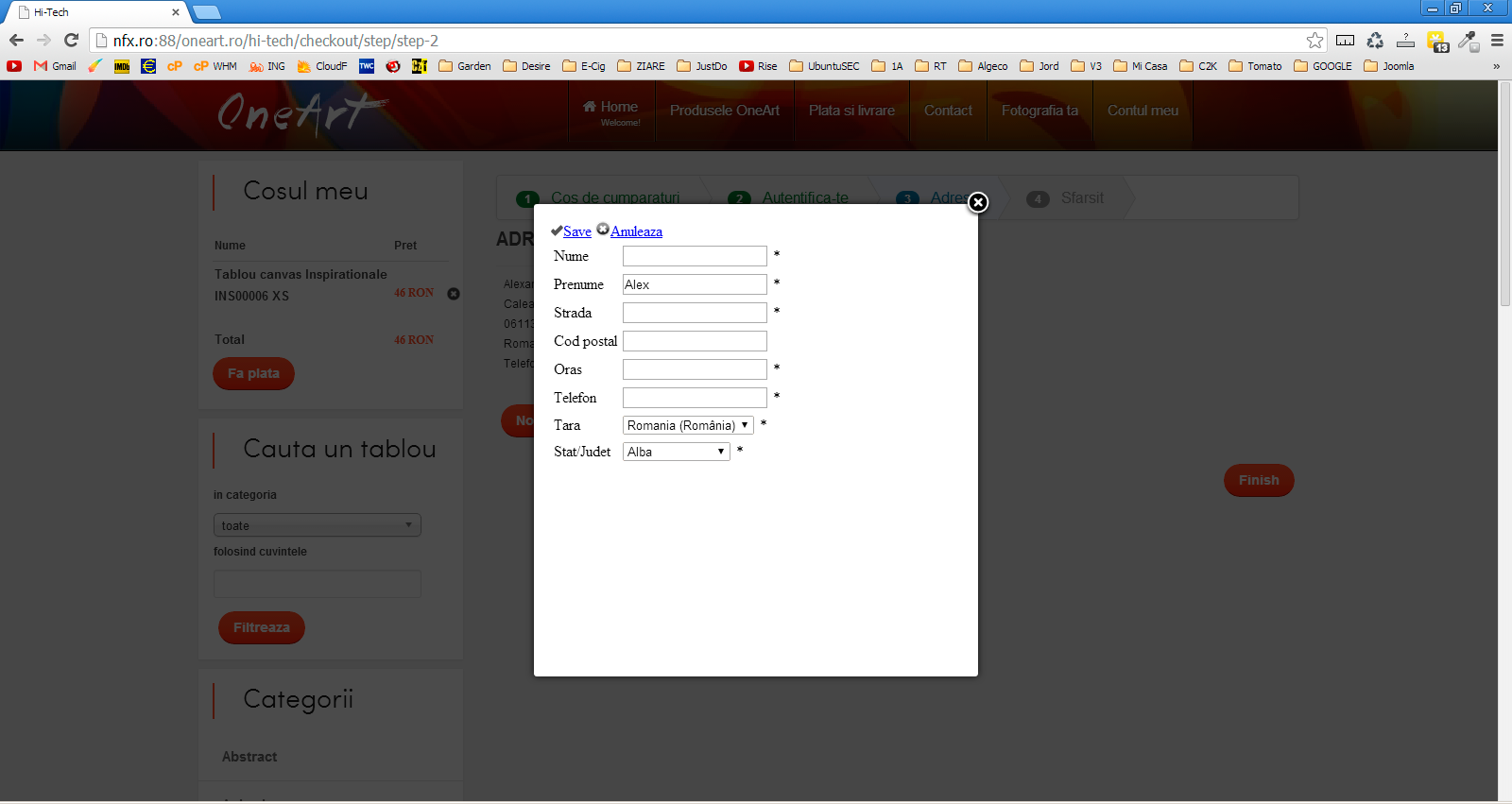

This is the Address in the Checkout process
This is I believe the Billing Address
And this is what happens when i click on the Edit pencil.
  • Posts: 171
  • Thank you received: 9
11 years 11 months ago #149051
Hi lex131,
Same problem was here, later I realized a new shipping system was created for checkout process.
Maybe you have (as me) a template override, try to remove in your /templates/TEMPLATENAME/html/com_hikashop/checkout/ all the files starting with "address". Or you can style it with your own after updating the mentioned files from /components/com_hikashop/views/checkout/tmpl/.
Hopefully this helps you out. I like the new address editor much better than popup style.
PePe
