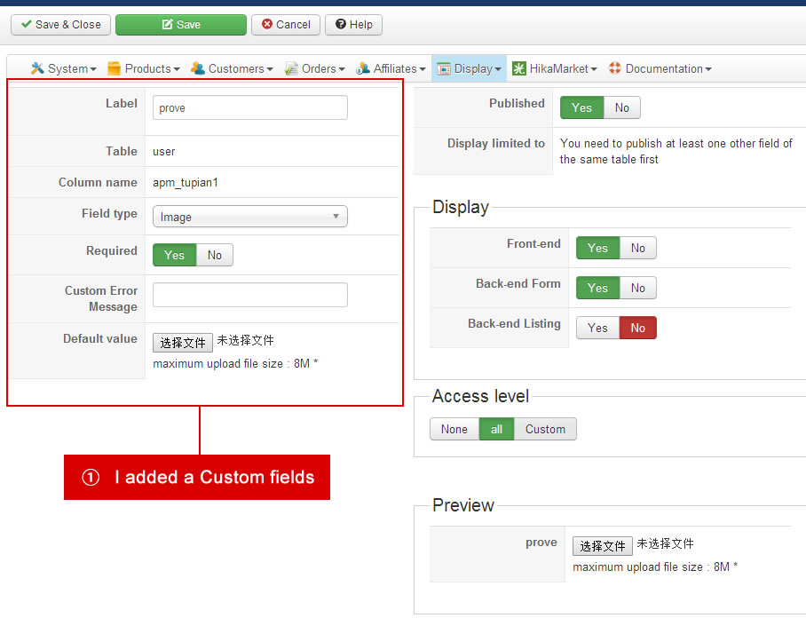

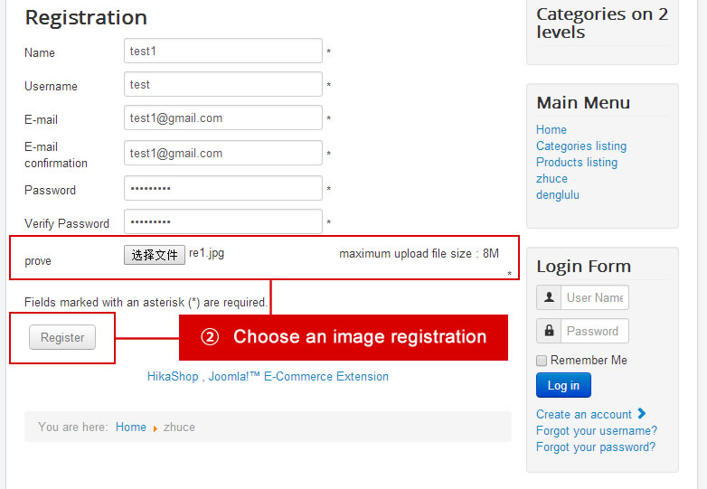

-- PHP version -- : 1.3.2
-- Joomla version -- : 3.2.3
How to solve, please help me!

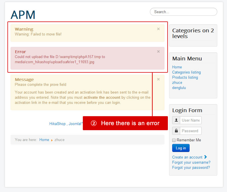

12 years 3 months ago #153116
This indicates that your web server doesn't have the right to copy files in the folder media/com_hikashop/upload/safe.
So edit the permissions of that folder via FTP and set the rights to 777 so that you're sure that your web server will be able to write files in that folder and that should then not produce that error anymore.

  • Posts: 19
12 years 3 months ago #154561
"image" :There is an error
"ajax image" :No problem, not an error
12 years 3 months ago #154741
For the moment thanks to use the Ajax upload. We will try to reproduce the problem on our end and correct it.

  • Posts: 86028
  • Thank you received: 14173
12 years 3 months ago #154793
We did further tests but the upload of files with the "image" type is working fine in all or tests.
All we can think of is that your web server is not configured properly.
You'll have to use the "ajax image" type for now, or check with your system administrator your web server (apache/PHP) settings, or try on another web server.
