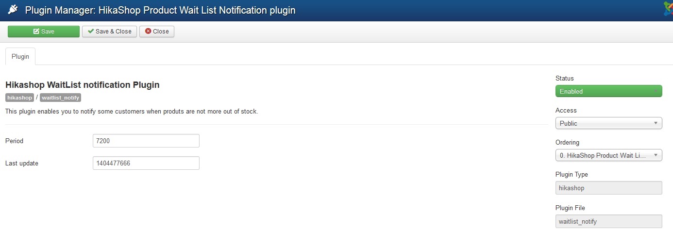

  • Posts: 78
11 years 10 months ago #179489
I have checked that the Hikashop WaitList notification Plugin is activated. It is.
What does the " Period" refer to?
Also it says Last update was 1404477666. What is that ? Some sort of date format? I attach a screenshot.

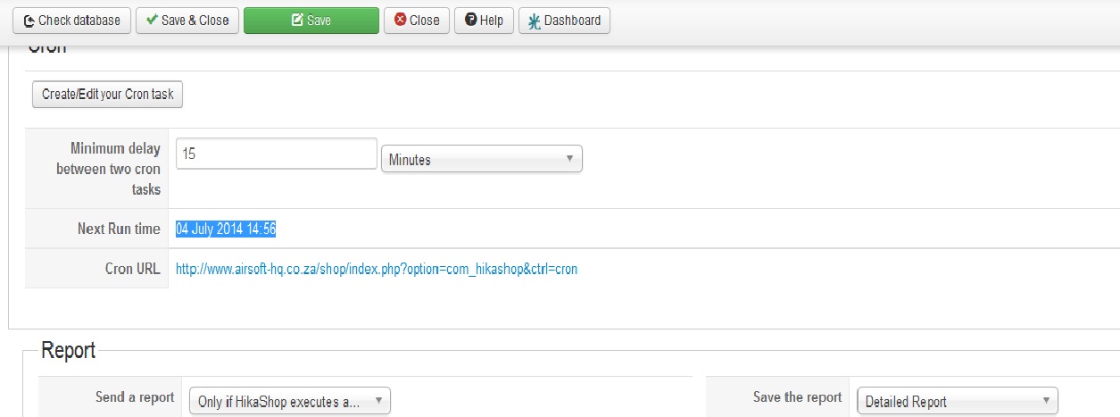

I have then also gone to the cron configuration (System -> Configuration->Cron
But I notice here that it says that the next Run Time is 6 months ago !!!!!!????? i.e. 04 July 2014 14:56
Is this the problem? How do I fix it?
I have included a screen shot - please bear in mind today's date is 13 November 2014.
  • Posts: 26386
  • Thank you received: 4078
11 years 10 months ago #179538
Your cron task was not right configured in your server and it was forcing a redirectin to your homepage.
So our system, after several iterations (during several days), have finally save your home page as the cron trigger url.
Since that day, your homepage is called every 15 minutes instead of the cron trigger url.
I fixed it in our server, please be sure that your cron url can be right called otherwise the same trouble will happen.
About your points.
1 - the period is the time between to trigger calls for the plugins. This value is in seconds.
2 - the strange value is a timestamp ; it indicate the time when you have been trigger for the last time.
3 - if you see that you are no more called for the cron task ; please check that the url is working and click on the button "create/edit your cron task" to update the url in our server.
  • Posts: 78
11 years 10 months ago #179565
So the CRON URL should have been www.airsoft-hq.co.za/shop/index.php?opti...m_hikashop&ctrl=cron ?
Was that the problem?

  • Posts: 26386
11 years 10 months ago #179659
Yes, the CRON URL you wrote is the right one.
You can also create a cron task in your server in order to call this url yourself.
All is explained in the cron task documentation :
www.hikashop.com/support/documentation/i...ashop-cron-task.html
