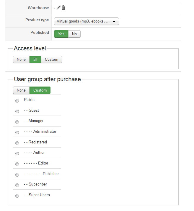

A purchase of any of the objects in this Hikashop is going to require a registration. However, I would like to define the group that the user has to register to.
For instance;
Object 1 purchase: Registered User
Object 2 purchase: Site Member
and so on....
Can anyone point me in the direction of where I can find some documentation on this?
  • Posts: 49
12 years 5 days ago #166612
Ok, I think I found this at the bottom of "Add Product". Can anyone confirm that this is the correct place I should be using to do this job?
  • Posts: 86028
  • Thank you received: 14173
12 years 4 days ago #166625
The "user group after purchase" option is to add the user to the group after the product is purchased.
If you want the user to only be able to purchase the product if he is in a specific user group, it's the "access level" option above that you want to configure.
