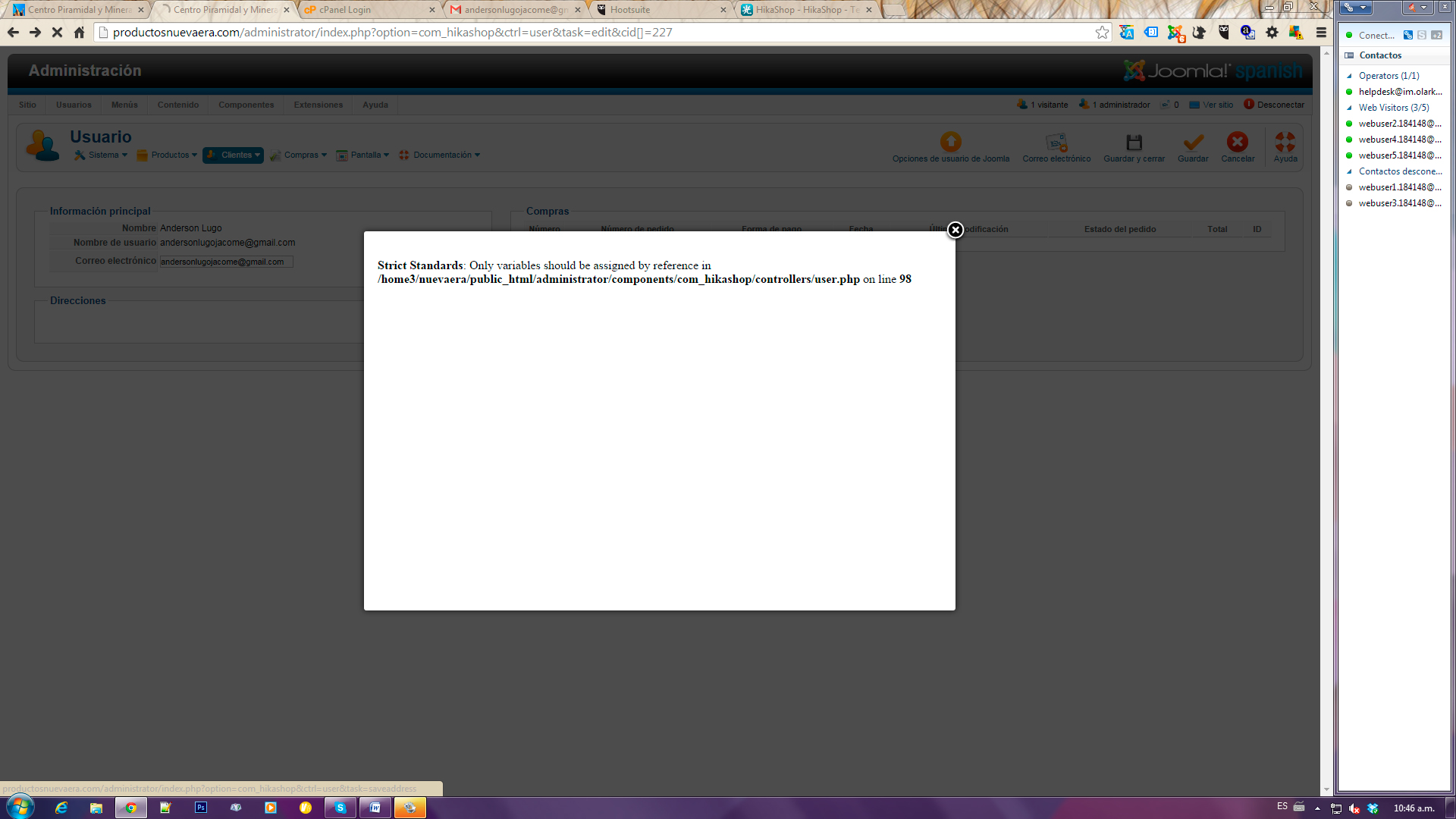

  • Posts: 13
10 years 7 months ago #173773
Hi, I have the same problem, but now the disable AcyMailing, but I still have the same error, no data are recorded customer address, attached the image of the message it gives me. Please help me :(

  • Posts: 83890
  • Thank you received: 13579
10 years 7 months ago #174101
It looks like there is a problem with the custom address fields in your database.
Plese turn on the "debug mode" option of the joomla configuration and try again to register and it should display an error message explaining the problem if that's indeed coming from that.
Also, you can try to disable the custom fields that you created/modified via the menu Display->Custom fields. That should hopefully solve the problem. Then, you can try to recreate them.
  • Posts: 13
10 years 7 months ago #174282
Hi .. Thanks, yes, it was a custom field that blocked the registration, unpublish and now i can register the address, but as it is a data that really I require (it is a number of citizen identification), I went back to create, but when I fill in the form recorded everything except this, do not appear in the data, and I need it to appear there and on invoices.

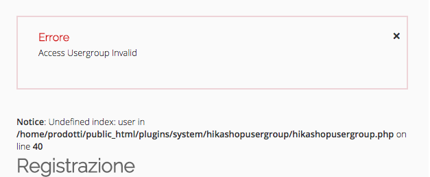

  • Posts: 4
10 years 5 months ago #183952
HikaShop essential 2.3.4
Joomla 3.3.6
I got a problem with account registration; a error box is shown "Error: Access Usergroup Invalid" and even though the registration is successful no address is recorded in the profile and is again asked during checkout. I switched on debug mode and see this message "Notice: Undefined index: user in /home/prodotti/public_html/plugins/system/hikashopusergroup/hikashopusergroup.php on line 40"
How can I fix this problem?
Andrea
  • Posts: 83890
10 years 5 months ago #184022
Try to disable the HikaShop group plugin via the Joomla plugins manager.
  • Posts: 4
10 years 5 months ago #184432
thank you! it did work. Only there was still a small problem with some links directing to the Joomla deafult registration form, leading to the same problem of missing address on the stored profile. I found a solution on a different post. Here the link, hope can be helpful if someone has this issue too:
www.hikashop.com/forum/3-bug-report/8726...trationredirect.html
