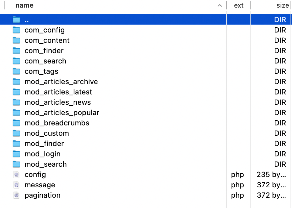

  • Posts: 198
  • Thank you received: 4
  • Hikaserial Standard Hikaserial Subscription Hikashop Business
1 year 5 months ago #366383
UPDATE: enabled "Ask address on registration" and now everything works fine.
there is no com_user folder in this place.
I enabled redirection plugin, but it only showing email for registration. Capcha is shown this time, but where is other fields?
