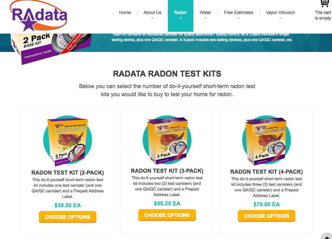

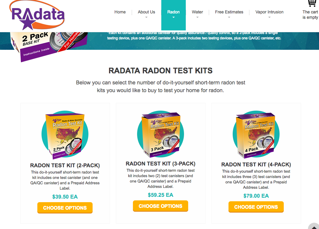

The screen shot you saw after I posted it twice here doesn't show the Hikashop reCaptach v2 because even though it was enabled it wouldn't show.
As I said more than once, on radata.com (production site) there are two others in Joomla. One is in the Global Config and its named Default Captcha and its set to None Selected. The other is in the Plugins section and its named Captcha - ReCaptcha and this is enabled. The other that's also in Plugins is currently disabled because when it was enabled the HikaShop ReCaptcha v2 was not working and that's when the error appeared. I had to disable it so people could place their order.
Now if you look here (Dev site) dev.radata.com/radon/buy-radon-test-kits the Global Config Default Captcha is set to None Selected, in the Plugins the Captcha - ReCaptcha and the HikaShop ReCaptcha v2 are both enabled.
See the attached screen shot. Click on the image of the box that says RADON TEST KIT (2-PACK) and when you do it'll take you to dev.radata.com/radon/buy-radon-test-kits...adon-test-kit-2-pack Then Add To Cart then keep moving forward until you see where you enter an email address and the captcha is right there and it works.
What I'm telling you is that back on radata.com (production site) I had the exact same settings before I disabled captcha so people could order and captcha wasn't working.

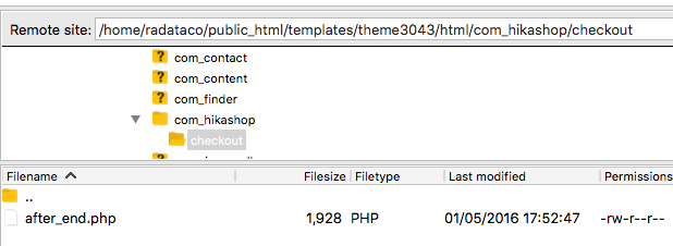

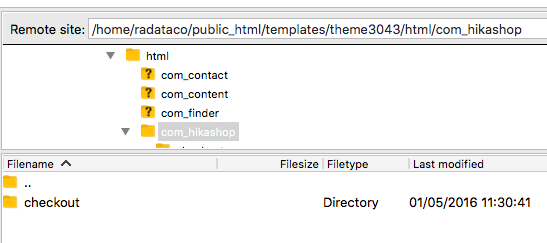

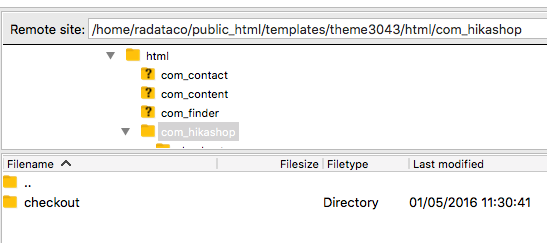

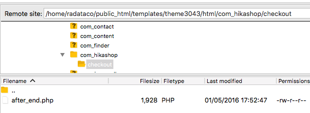

8 years 2 months ago #293824
As you can see by these two screen shots neither coincide with the path you posted here in this thread.
templates/YOUR_TEMPLATE/html/com_hikashop/user/registration.php
It would have been nice if you told me where exactly to find Use bootstrap design other than just the Config page because I had to go looking for it and found it in Config > Display. Its set to YES.
  • Posts: 86042
  • Thank you received: 14174
8 years 2 months ago #293898
So it seems that the issue doesn't come from a view override since you don't have the user folder at all under com_hikashop.
