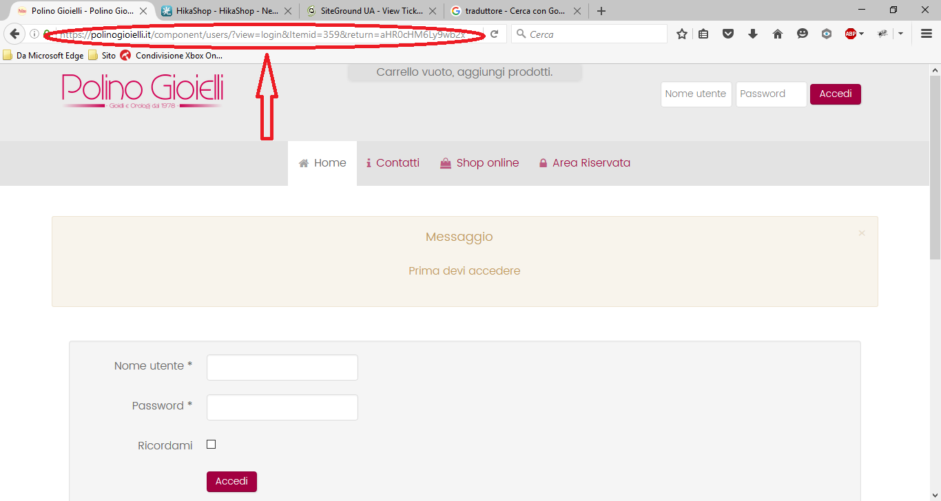

-- url of the page with the problem -- : polinogioielli.it/component/users/?view=...cmVhLXJpc2VydmF0YQ==

i have a problem with the URL of the login page of my users . I want only the alias cues of the voice of my menu, but I can not fix it . Can you suggest some method to solve the problem ?

I don't think it's a problem in joomla because if I change the menu item from hikashop's cpanel to a simple joomla's login in the url you can see the alias while at the moment you can see:
mysite//component/users/?view=login&Itemid=359&return=aHR0cHM6Ly9wb2xpbm9naW9pZWxsaS5pdC9hcmVhLXJpc2VydmF0YQ==

It's normal that the menu alias is not used. Joomla can only replace component/NAME by the menu alias if the menu type correspond to a menu type of the component.
So to replace component/users in that URL, you would have to change the line:
global $Itemid;
to;
$Itemid = XXX;
where XXX is the id of a menu item of the user manager component of Joomla in the file components/com_hikashop/controllers/user.php and ht will use the alias of that menu item.
But it's not possible to use the menu item alias of the control panel of HikaShop there.
