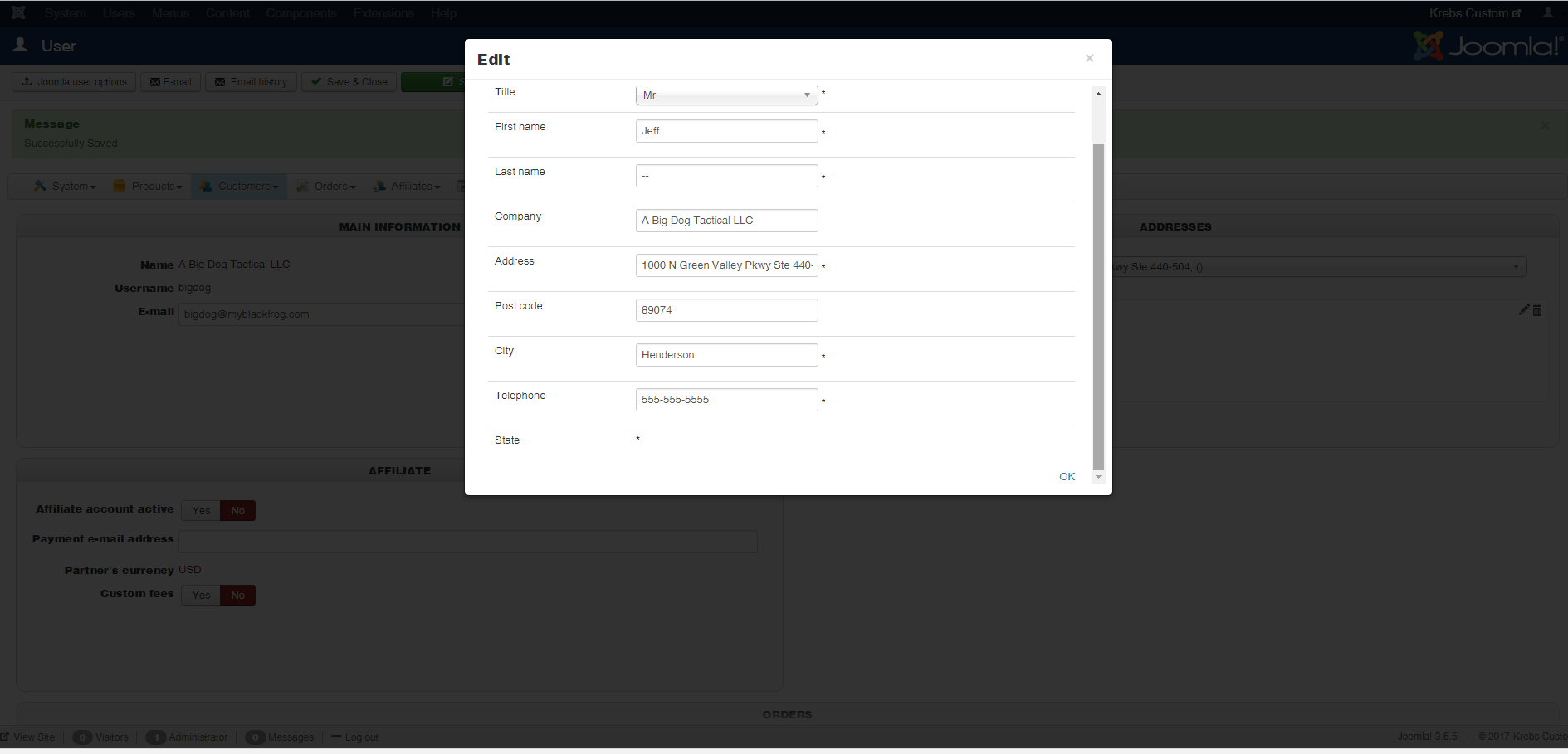

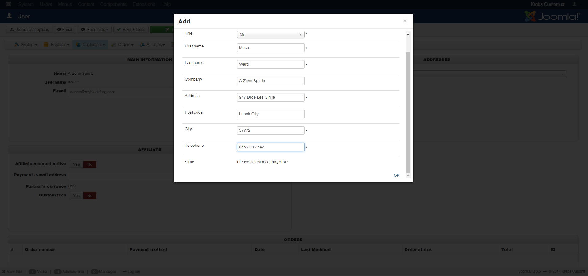

-- PHP version -- : 5.6.3
I am setting up dealers on the backend. I create them as a user, and then go to the customer field to put in their address information. The system will not give me the opportunity to put in a state unless I pick a country, but it doesn't give me an area to pick a country (even though they are all US). So I put in what I can, and then log into the front end as the dealer. Going to the profile it then gives me a dropdown to select a state... what am I missing here?
Here is the back end shot.

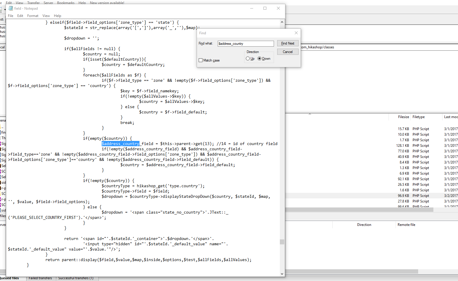

Change the line:
$address_country_field = $this->parent->get(14);
to:
$address_country_field = $this->parent->get(13);
in the file administrator/components/com_hikashop/classes/field.php and that should fix the problem.
  • Posts: 62
9 years 5 months ago #264289
Thank you.
I made the change but am not being given a field box to enter the State value.
