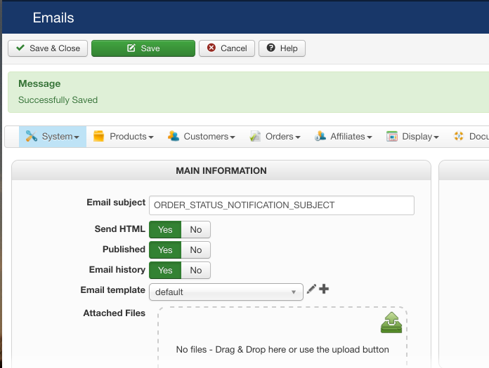

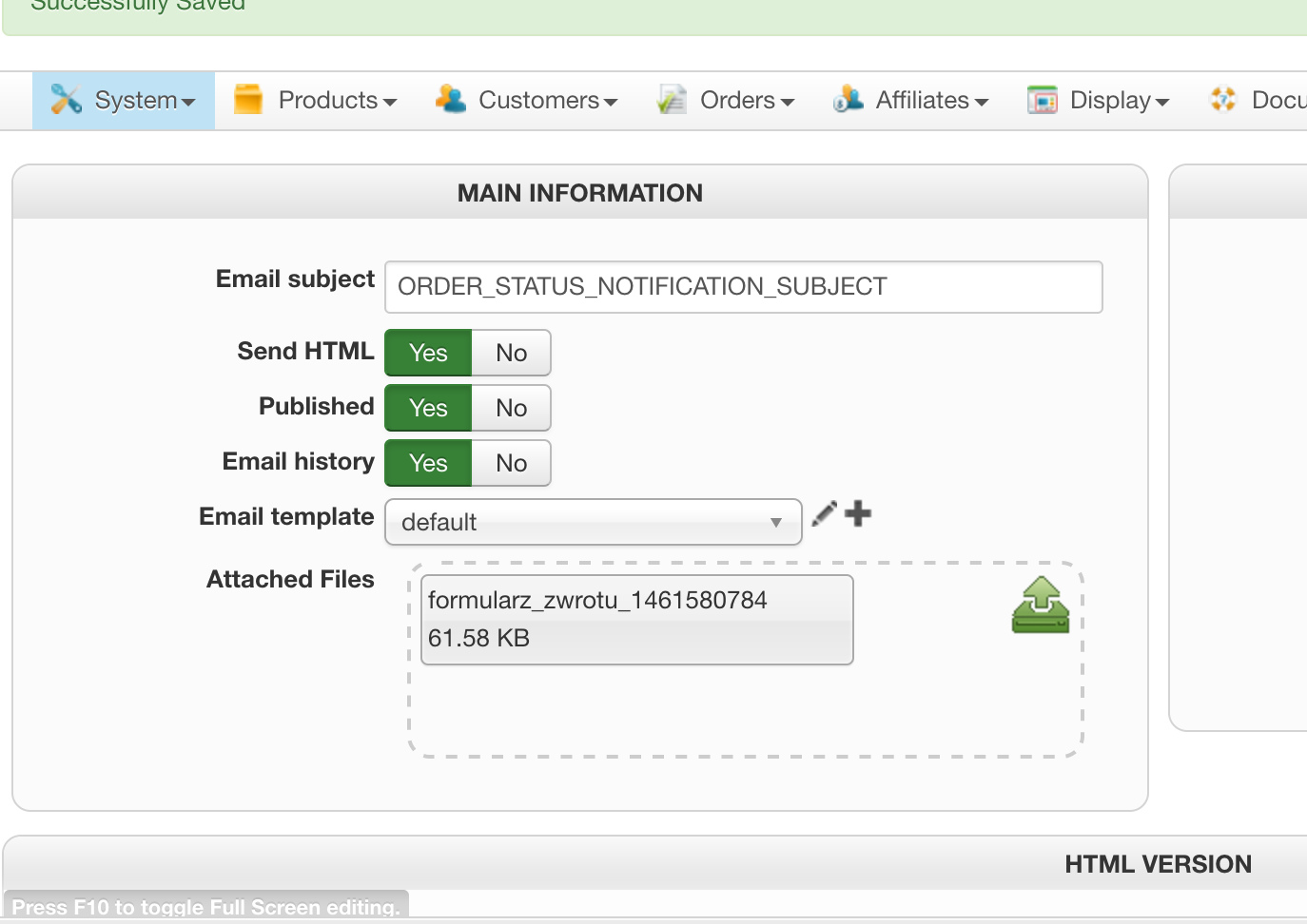

As in the subject - after adding the files in the e-mail configuration - attachments are not saved :(
