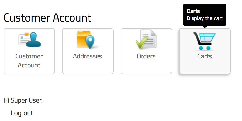

How do I remove the "Carts" button and page from the user control panel? Please see attached.

Hello Josh,
The solution will be to directly customize the code of the file "Cpanel" of the "User" view of your front-end template via "Hikashop->Display->Views".
You'll just have to add these lines :
After :
Code:
if($btn['image'] == 'cart')
continue;
Code:
foreach($this->buttons as $btn) {

This worked great.

could you update the process here for Hikashop 4.5 ? Cause the explanation seems to not working on this version.

You can edit the file cpanel via the menu Display>Views and at the beginning of the file, you can add that code:
Code:
<?php unset($this->buttons['cart']); ?>

Thanks Nicolas, i hided it via CSS but it's better with your solution
Thanks !
