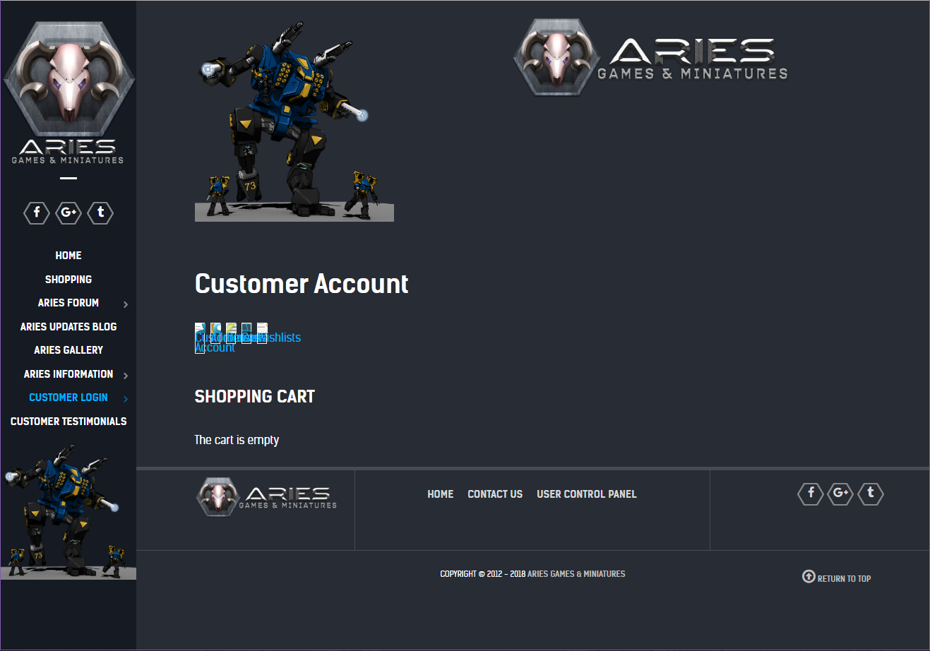

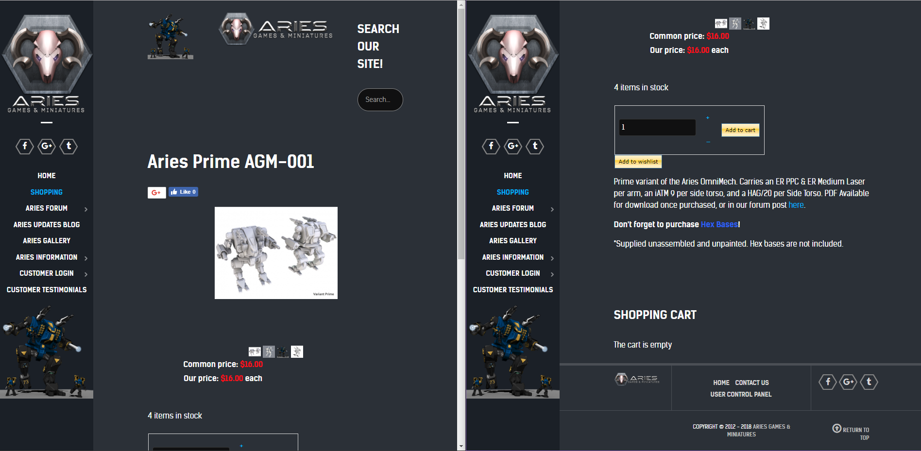

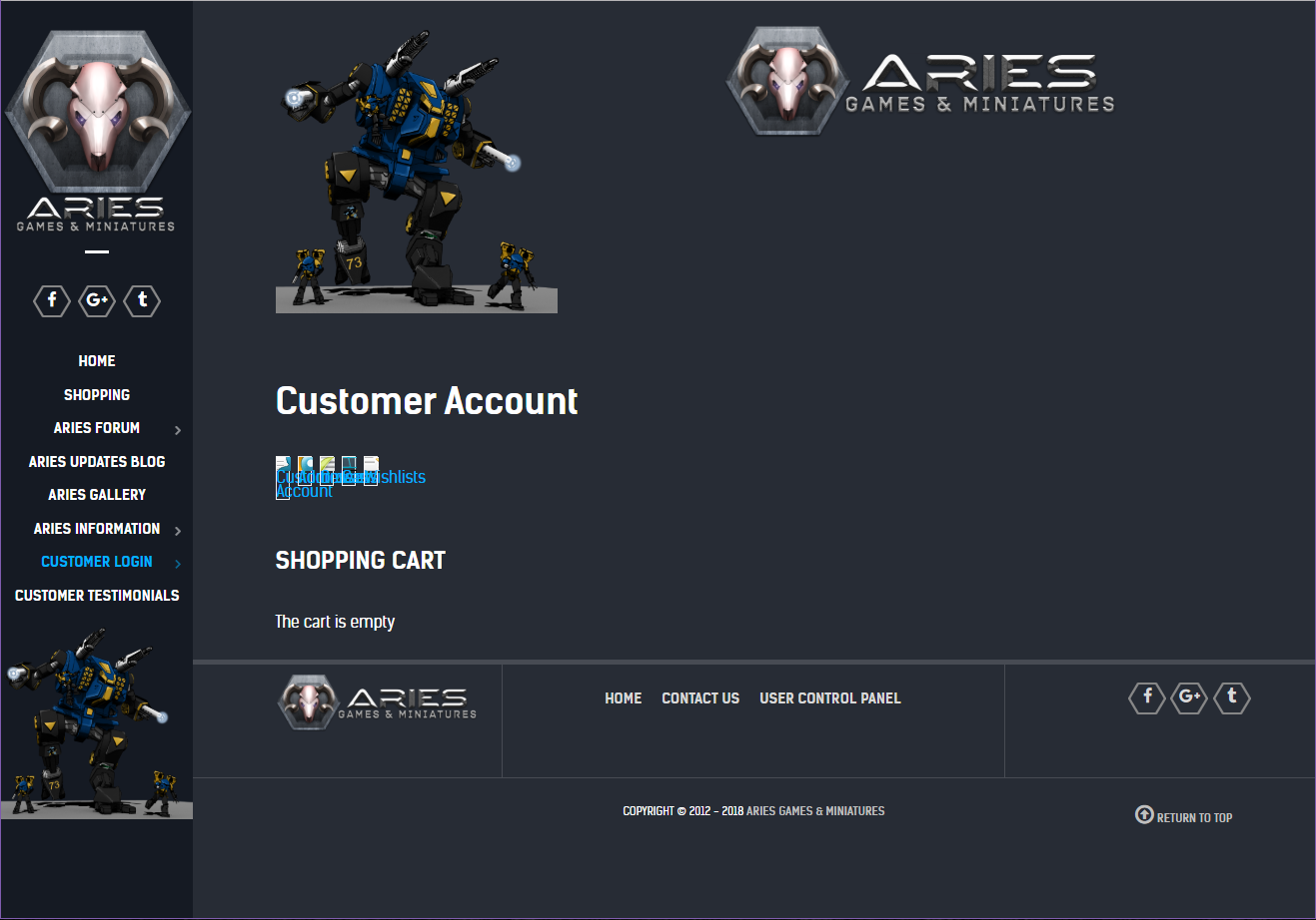

First, I know my HikaShop is out of date (as is Joomla). I need to resolve a issues with both on a test site I installed the newest version on before I update my live site.
My user account control page is not displaying properly. I have NO idea how long this has gone on...but I've tried to investigate the issue myself and need some direction.
First off, please see the attached images. This shows both before (checked) and after (unchecked) I toyed around with the investigate tool within chrome. I still cannot figure out how to make the associated images larger though.
Any direction would be helpful as I'm a bit unsure on what to do. I have (per memory) never changed the CSS for the User Account Control page...so I'm not sure why this is happening.
Thanks!
Checked
Unchecked

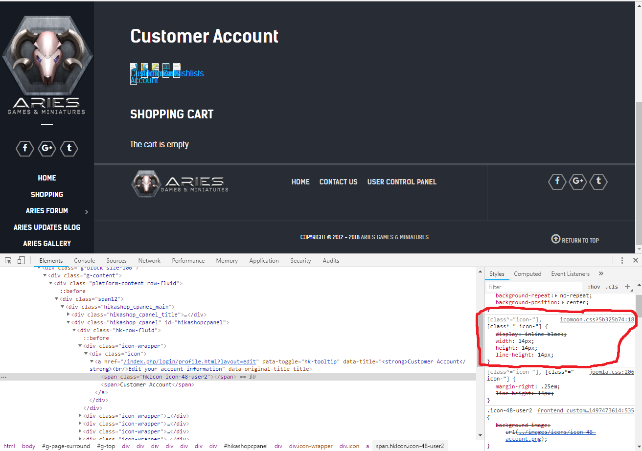

You should have a customized CSS file.
Because HikaShop 3.x was a major release ; it had a lot of modifications including CSS modifications.
We now recommend to try to keep the "frontend default" CSS and use the "style" to create your customization.
Depending how your CSS is already customized, it would be easier to add the missing rules in your current used file.
Rules are around the "icon-wrapper" "icon" classnames and also the "hkIcon".

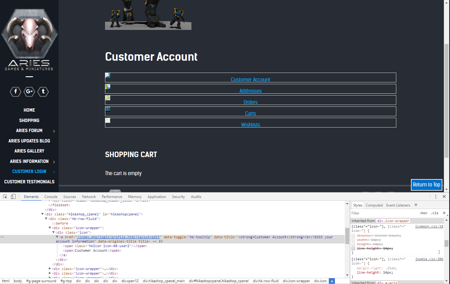

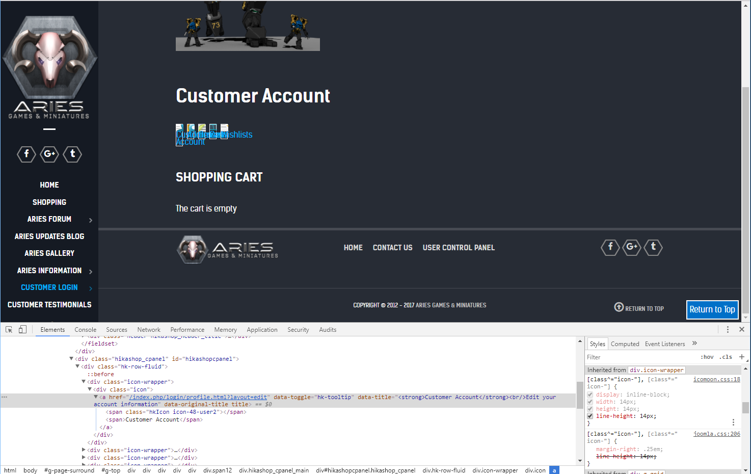

8 years 2 months ago #294718
Jerome and/or Nicolas...I'm still oddly having this issue. Attached are new images.
I know where to change the CSS file, but...of course when I do, and there's an update, all changes revert to their original state.
So where exactly should I copy these changes to? I'm using a Rocket Theme template if that matters. I have tried all the previous posts, and it doesn't seem to work for me, or...I'm doing it wrong.
Images attached are as follows:
User Control Panel - This is how it looks to customers (on a computer) when they access it
BEFORE Editing User Control Panel - The red circled area is the part that I need to edit
EDITED User Control Panel - This is how I'd like it to look and the red circled area are the changes I made
Thank you!

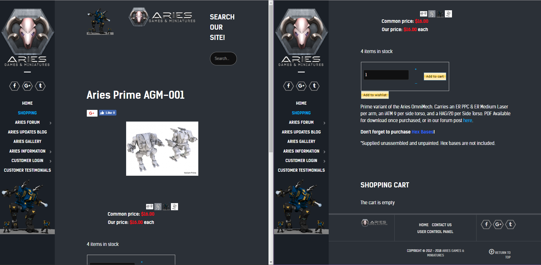

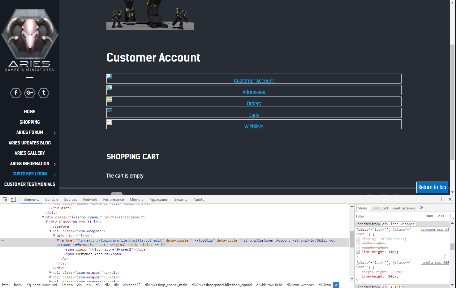

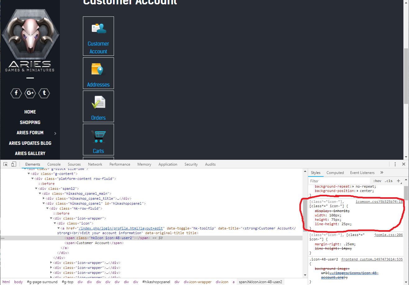

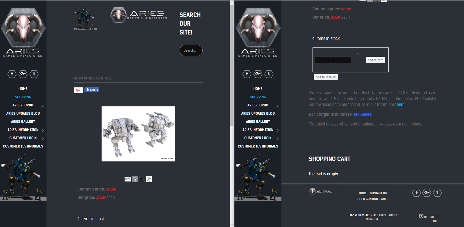

Ok...I have GOT to be doing this wrong. Re-reading what you both have said, and the documentation I can find...it's still not working and it changes the rest of my site.
I've attached 2 images (split screens since the page is longer than the image), you will see in the AFTER Edit one, fonts are changed, sizing has changed, things are italicized when they were not before, and the color of wording is now grey.
BEFORE Edit - this is how my live site looks, as well as the staging site before copying & editing the style sheet.
AFTER Edit - this is how the staging site looks after I include the following code
[class^="icon-"],
[class*=" icon-"] {
	display: inherit;
	width: 100px;
	height: 75px;
	*margin-right: .3em;
	line-height: 25px;
So what am I doing wrong? Here's the steps I took:
Created the staging site, which is a direct copy of the live site
Went into the admin panel, to HikaShop configuration, then Display, then CSS
I opened "Styles for the front end" and selected "custom", then clicked edit.
I entered the above code at the bottom of the new custom front end css and hit save
Then I get the messed up look on the site.
How can I change JUST the User Control Panel screen and not the rest of the site?
8 years 2 months ago #294918
You use a too generic selector, and of course that will modify the whole site page.
You have to create a more specific selector :
.specific_page_class .html_element_class {
/* Your command css */
And so, your custom code will be applied only on the page with that specific page.
Last edit: 8 years 2 months ago by Philip.

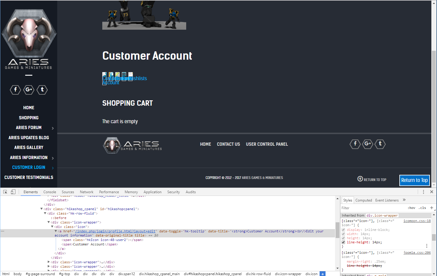

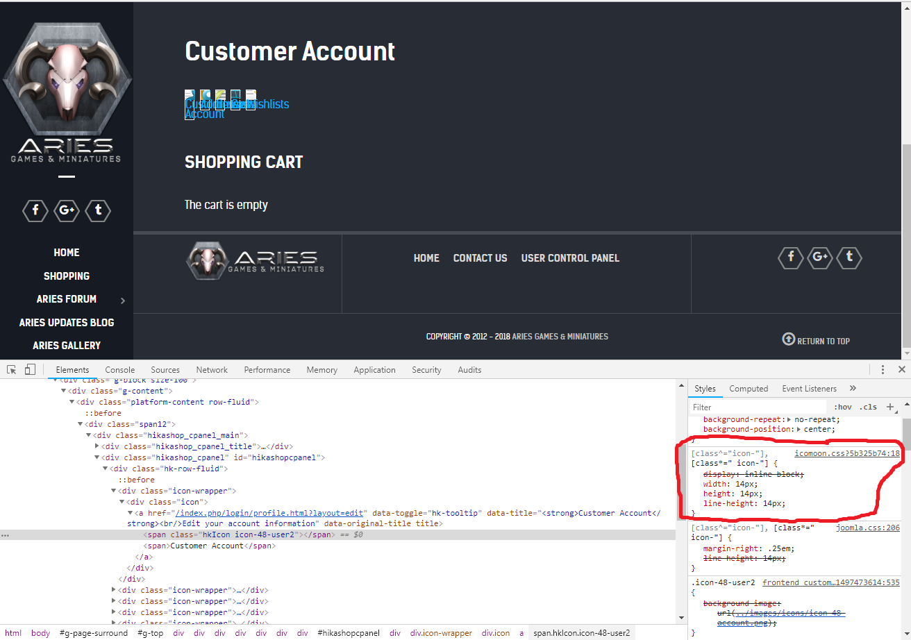

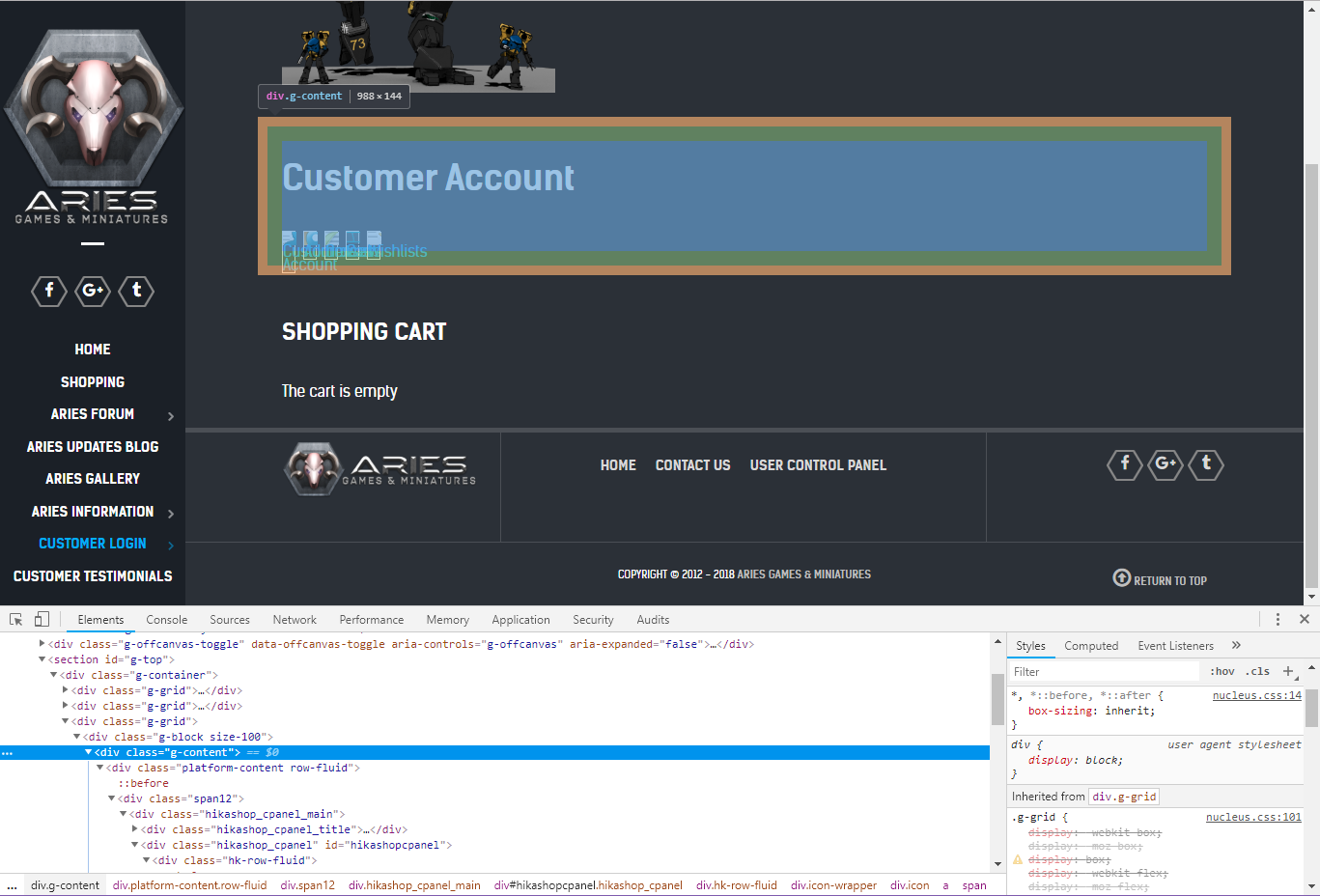

8 years 2 months ago #294944

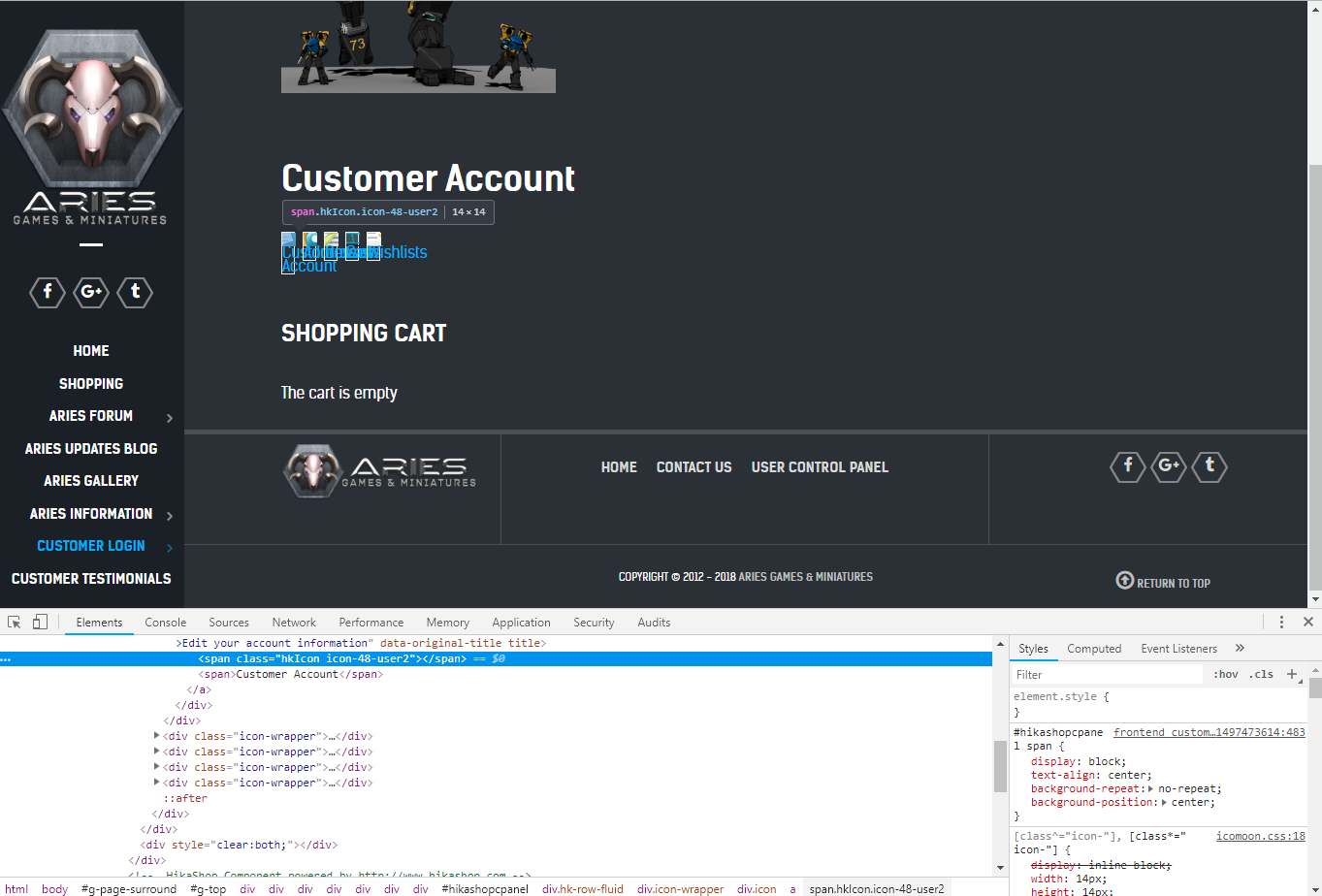

You can use your inspector tool to get the specific page class (or better id), for this you have to right click and select inspect, inspector too or else (depends from your navigator), see my screenshot :
Hope this will help you.

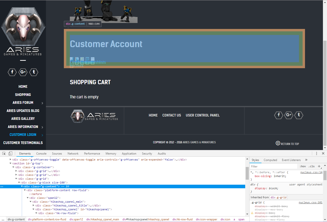

  • Posts: 713
  • Thank you received: 37
8 years 2 months ago #294964
That helps...I think...
In the attached images, which of the the highlighted area is the one I need to list?
Image 1
Or would it be...
Image 2
Number 1 correct? If so (or if it is Image 2)...what is the ID? I don't see anything specifically stating an ID. Sorry...I'm still rather new at this, and Coding is definitely not something I'm great at yet.
Last edit: 8 years 2 months ago by Dragon41673.
8 years 2 months ago #294971
I will suggest you to use this Id :
This Id will be present only on this HikaShop page, and so your custom css will be only apply in this area.
