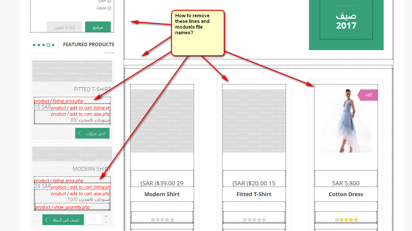

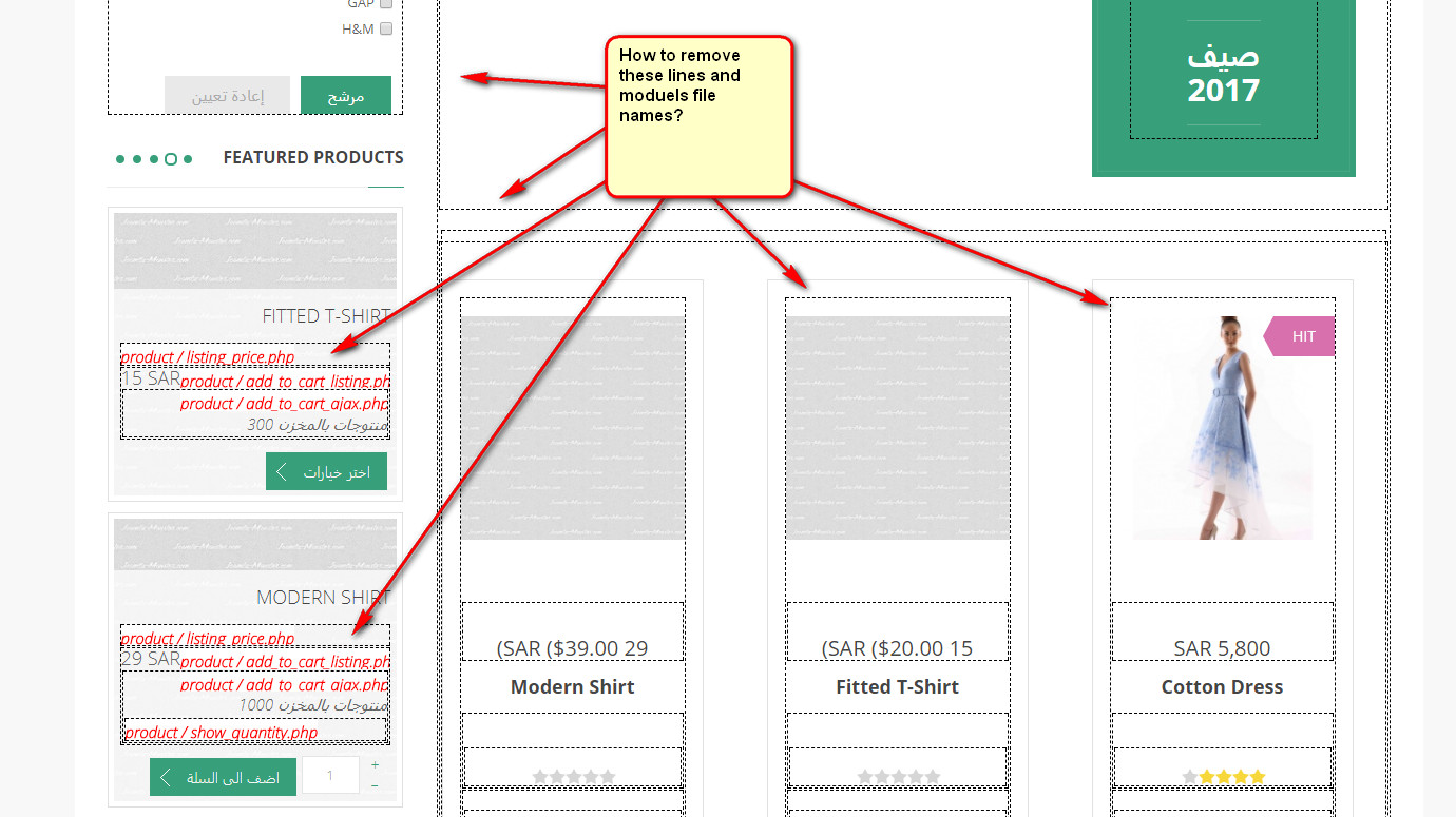

Dotted lines and file name showing around modules boxes
  • Posts: 1
8 years 11 months ago #277011
I do not know what I did , but dotted lines are showing around modules and also modules files names are showing.
How can I fix this ?

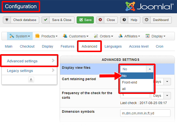

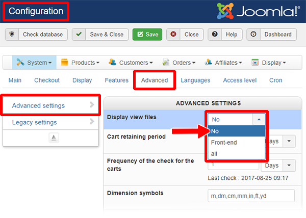

You have switch on the "Display view files" option, for reach it, go to main HikaShop Configuration (in Component => HikaShop => Configuration), then click on Advanced tab and in "Advanced settings" part see the first option and switch it on "No".
