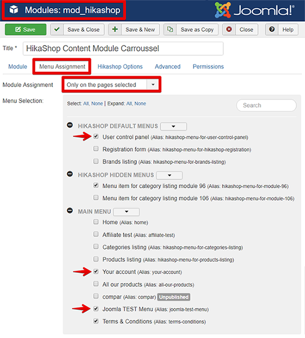

8 years 11 months ago #277212
I think there is misunderstanding, Nicolas give you the menu id where you don't want to display your modules.
From this you can set where modules will be displayed see this screenshot :
On this screenshot the module will be displayed only on the menu spotted with a red arrow.
Hope this will fit your needs.
