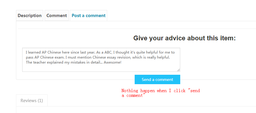

-- Error-message(debug-mod must be tuned on) -- : No response to my click

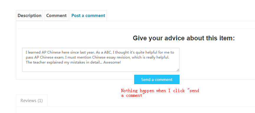

When I test the hikashop, I want to send the comment. But nothing happen when I click the "send the comment". I can't send my comment. Can you help me check it?

8 years 6 months ago #287527
I actually don't see the comment form at all on your link:
monosnap.com/file/YzmiqompDiaMXA1QQs78DXT1d13Ze7
Did you change something ?
Or maybe we need to be logged in to see it ? In that case could you provide a test user account ?

Then click menu "Store > online shop > Course package > AP Chinese Special Package". When you post the comment, it doesn't work.

8 years 6 months ago #287640
If I check the HTML of the page, I can see that the hidden fields necessary for the comment form to work properly have been commented out:
monosnap.com/file/mDRh8aJfjD0j7n8feOqKFmI6PB8KBb
So either this was done on your end or by the template.
Either way, the comment system can't work properly in that case.
The simplest is probably to rename some of the view files in the template:
templates/YOUR_TEMPLATE/html/com_hikashop/product/show_tabular.php
templates/YOUR_TEMPLATE/html/com_hikashop/vote/form.php
But I would recommend checking also with your template provider.

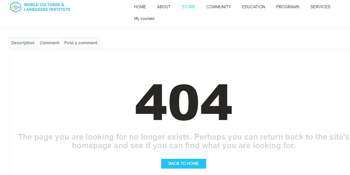

After following your instructions to rename these files (show_tabular.php ---> show_tabular_2.php
form.php --> form_2.php), a new error pops up when I click the product ( www.worldedu.us/course-package/product/listing ) it will show me a 404 error.
How can I fix it? Look forward to hearing back from you.
Thanks again.

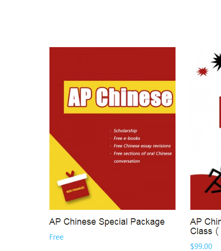

  • Posts: 14
8 years 5 months ago #288751
Hello
I attached some screenshots you need. Look forward to hearing from you.
  • Posts: 86042
  • Thank you received: 14174
8 years 5 months ago #288781
I've checked your listing again but I don't have the issue anymore.
It seems to be working for the "AP Chinese Special Package" product.

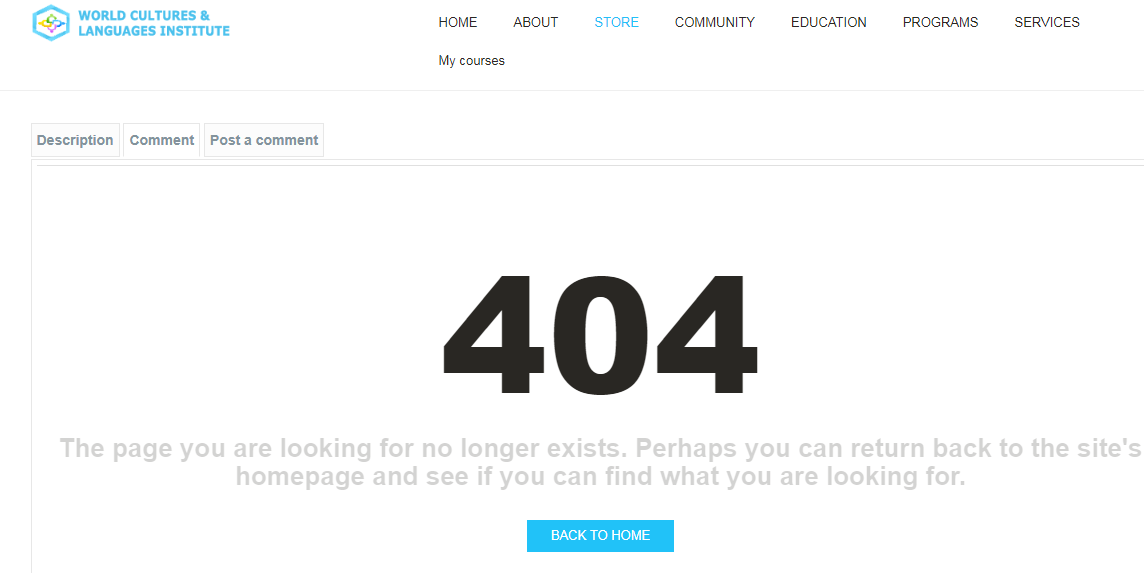

I just deleted the old product and create a new one, I still got the problem. I can post a comment now, but when I check the comment area, it shows 404 error. You can check this product: Test . When you open it, it will show 404.

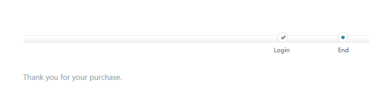

Another question is can I add a link when customer finish the order? It shows a message "Thank you for your purchase", but I want the page jump to the customer center. How to achieve it? Look forward to hearing from you.

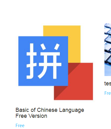

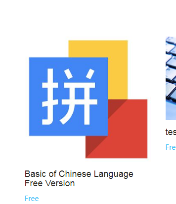

Sorry, I mean this product: Basic of Chinese Language Free Version
Once I commented the product, it will show 404 error. Why did that happen?

8 years 5 months ago #288893
I don't see why that product page URL would generate a 404 error. The URL is just fine.
And I don't see how having a comment or not on the product would change that.
So you mean that if you delete the comment for that product, the page works again ? (you can delete the comment in the Customers>Votes menu in the backend)
I doubt that it's the case.
To me, it sounds like a SEF issue. For example, if you use an extension like Sh404SEF and you reset the SEF URLs cache while you have canonical URLs in your products with the "force canonical URLs on listings" setting activated in the HikaShop configuration, it would do that.

When I unpublish the comment at the backend, the page works again. I tried to clear sh404 cache and product url before, but it didn't change anything. I didn't select "force canonical URLs on listings". Is there any way to solve the problem?

8 years 5 months ago #289182
The error on the product page when you have comments is this:
table tz_portofolio_users doesn't exist
That error comes from your template.
So there must still be a view override which creates the issue.
I tried to access your FTP but you didn't provide the password, so I couldn't check.
However, one of the files in either templates/YOUR_TEMPLATE/html/com_hikashop/vote or templates/YOUR_TEMPLATE/html/com_hikashop/product must be generating that issue. You'll have to rename them one by one to find the culprit.
