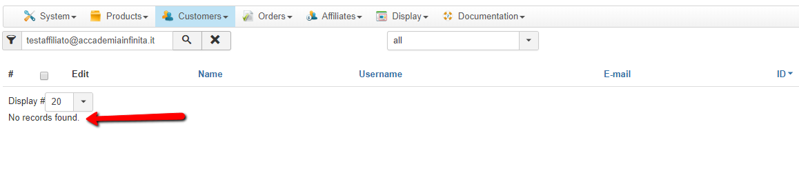

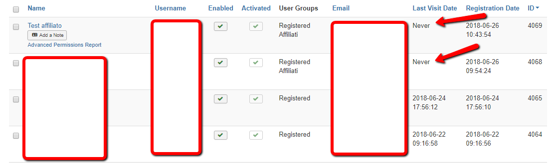

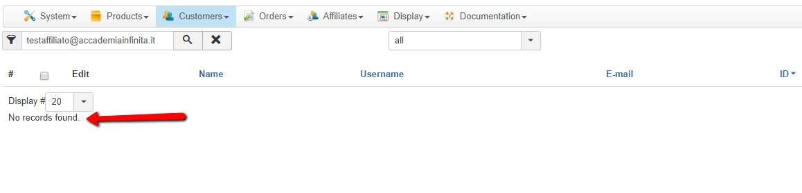

I am registering new affiliates via a custom Chronoform form, the users are being registered normally in Joomla (I can see them in the Joomla user list), but when I go to the Hikashop Customers list to activate them as partners, I can't find them there.
I have selected "all" in the dropdown menu, but none of those users shows.

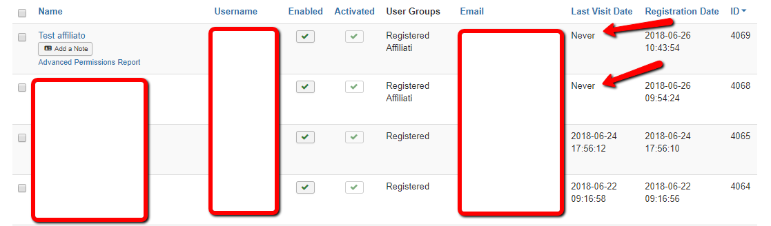

Thw only difference I can see about these users is that they have been created but didn't log into the site yet.
Can this possibly be the cause of the issue?
Thank you

I have tested further and if the user has logged in at least one time he will be listed in Hikashop customer list, only users that have never logged in are not being listed.
I can easily solve this by auto-logging in usres after they register through my custom registering form then.
Maybe you could check this on your side and correct the issue so that even users that have never logeed in are being listed n Hikashop as customers.

Please note that HikaShop "check database" (via the hikashop configuration) perform the sync between Joomla and HikaShop users.
Please also not that HikaShop do have fallbacks to create users when a Joomla user is log-in.
The "HikaShop users" system plugin is there to catch Joomla events when a user is created ; if the other component do not use the Joomla core to create the user in the database ; I'm afraid that we can't do anything.
You have to create the users using the Joomla core functions so the other plugins/components will have the knowledge of what is happening (and create interaction, a full working eco-system).
Just while a user is log-in, there is a trigger and that's why HikaShop can create the corresponding user. It's a well designed workflow !
