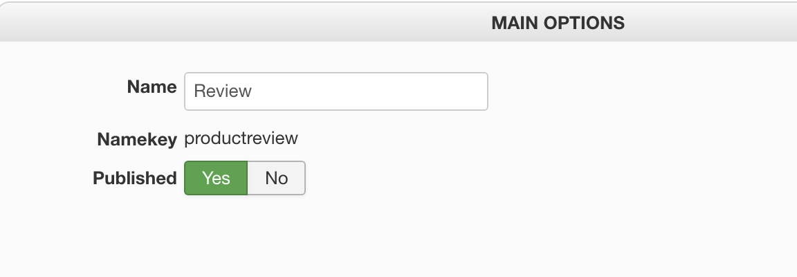

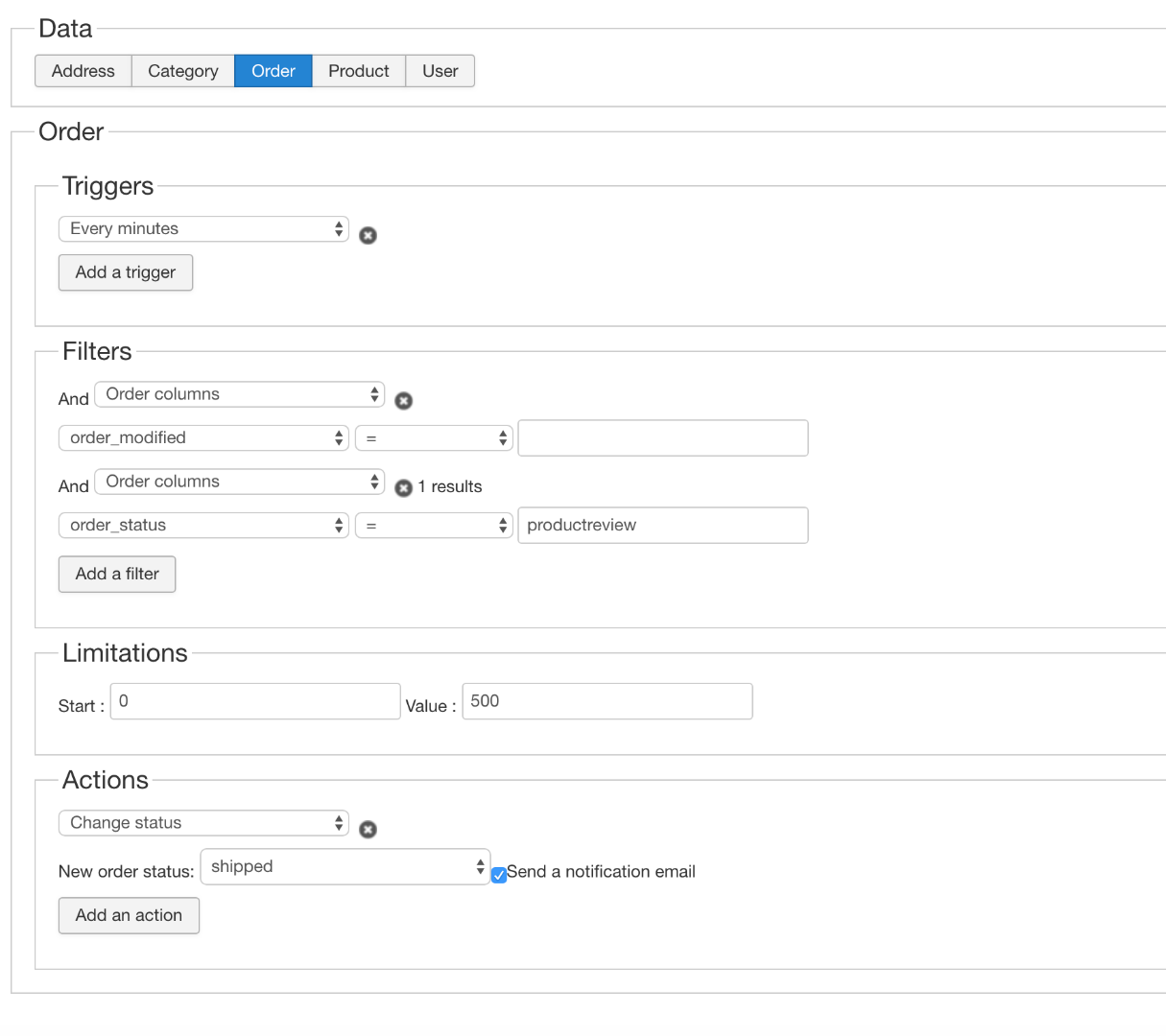

I have also tried setting up the mass action however I am not sure if I followed your instruction correctly. For action I am unable to select a new order status 'productreview' I created. and where do I select the delay as I want it to email out 5 days after a order is shipped.
I have attached the settings

Regarding the delay, you'll want something like that for that filter:
order_modified < {time}-432000

I have now added the order_modified fiter as '< 432000' you suggested.
What did you mean about the order status in the filter I did not understand? Is what I am using 'order_status = productreview' correct?
I am looking at mass action and I am wondering how will it know that when a order status is set to 'Shipped' that 5 days later it will change the the order status to 'Review' and send out an email?
There is nothing on there about when the order status is set to Shipped?
Last edit: 8 years 2 months ago by dancingkazzaf.

Note that you also need the {time} tag which will be replaced by the current date so that the filter can be: order_modified is before now minus 5 days.
You don't need to change your order_status filter. I was only saying that custom order_status can't be selected in mass actions if you don't have the latest version, that's all.
When the order status is changed to shipped the "order_modified" value is update with the current date. So the filter order_modified < {time}-432000 will allow you to pick orders which have last been modified more than 5 days ago and for which their status is "shipped".

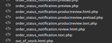

Hello in the com_hikashop > mail folder I have only duplicated the order_status_notification do I also need to do the same with order_notifcation too?

8 years 1 month ago #295731
As Nicolas said, you'll just have to duplicate files of the "order status notification" email and use that kind of file name for your productreview email :
- productreview.preload.php (which will load displaying information)
- productreview.html.php (which will display loaded information)
- productreview.text.php
Note that you'll probably have to alter the code of the preload and html files according to your needs.
Best regards,
Mohamed Thelji.
  • Posts: 256
8 years 1 month ago #295788
Hello I have already done this. I have already duplicated these files and named them as so.
If you read my explanation above the backend "order status notification" as been edited and is ence also overriding my productreview.preload.php, productreview.html.php and productreview.txt.php files.

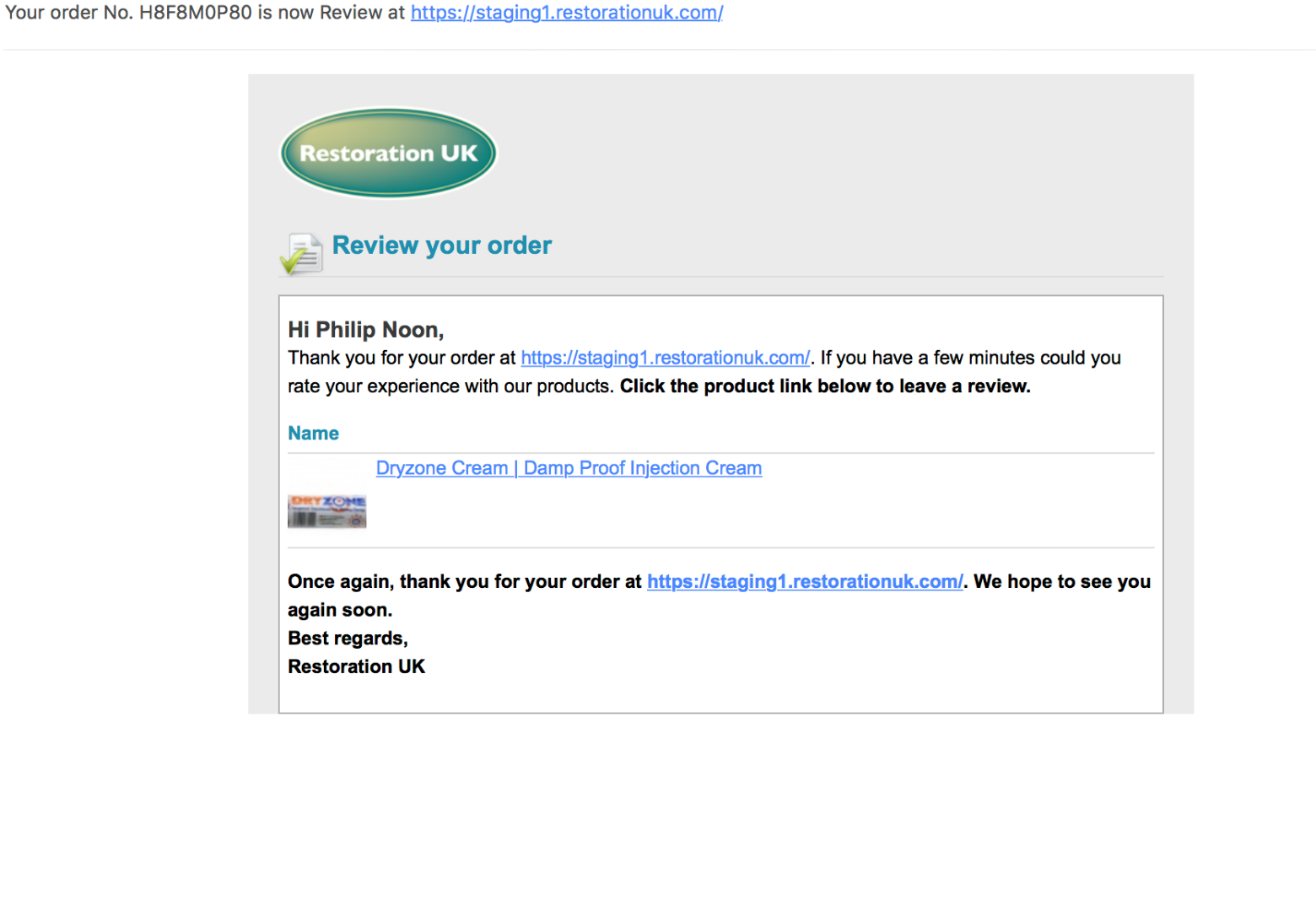

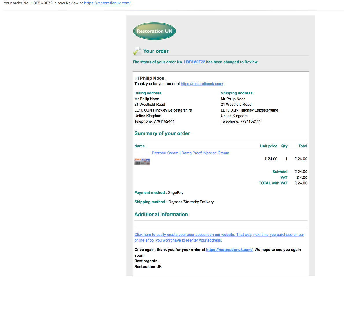

8 years 1 month ago #295864
Hello to reiterate what is happening.
I have created a productreview email override for the review status, which when the status is changed manually and I toggle on the send email. You receive the correct email (the 2nd attachment below).
However when I process the mass action to change the status from shipped to review. It sends a different email (not my override email). This is in the 1st attachment below.
Now why is the mass action not using my productreview email override?
Last edit: 8 years 1 month ago by dancingkazzaf.

  • Posts: 256
8 years 1 month ago #295939
Something is not working correctly then as that is exactly what I have done. I have attached a screen shot of the copied email file renamed to the name of the review status.
I have also screenshot the main options of the review status settings.
Is there something I am missing?
