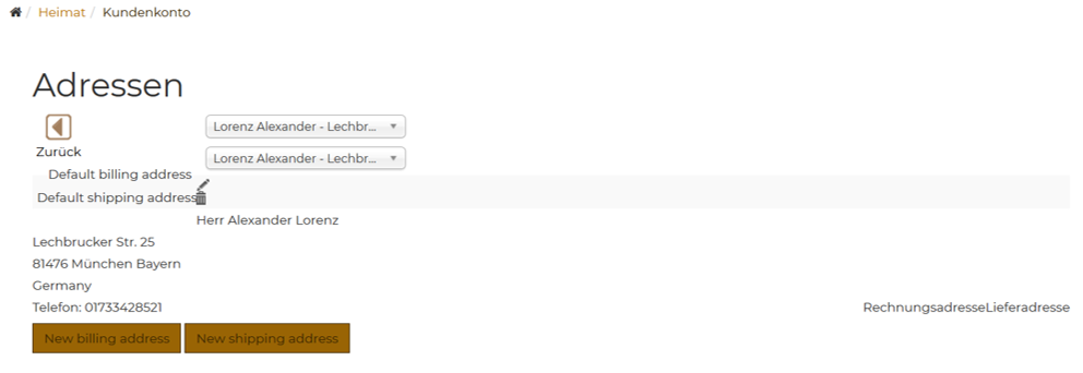

-- url of the page with the problem -- : www.ginmacher.de
-- Joomla version -- : 3.7.2
-- PHP version -- : 7.1
-- Error-message(debug-mod must be tuned on) -- : See below screenshot
Hi Team,
after the update to Hika Shop Business 3.5.1 in the customer area the area for customer adresses is somehow messed up (see screenshot). The buttons are in englisch now, some destription texts also in englisch and it does not look good (strange alignment). ALso on the right side on the bottom there is the germabn text (RechnungsadresseLieferadresse) without any link, button etc.
How can this be fixed
Thank you in advance.
Alexander

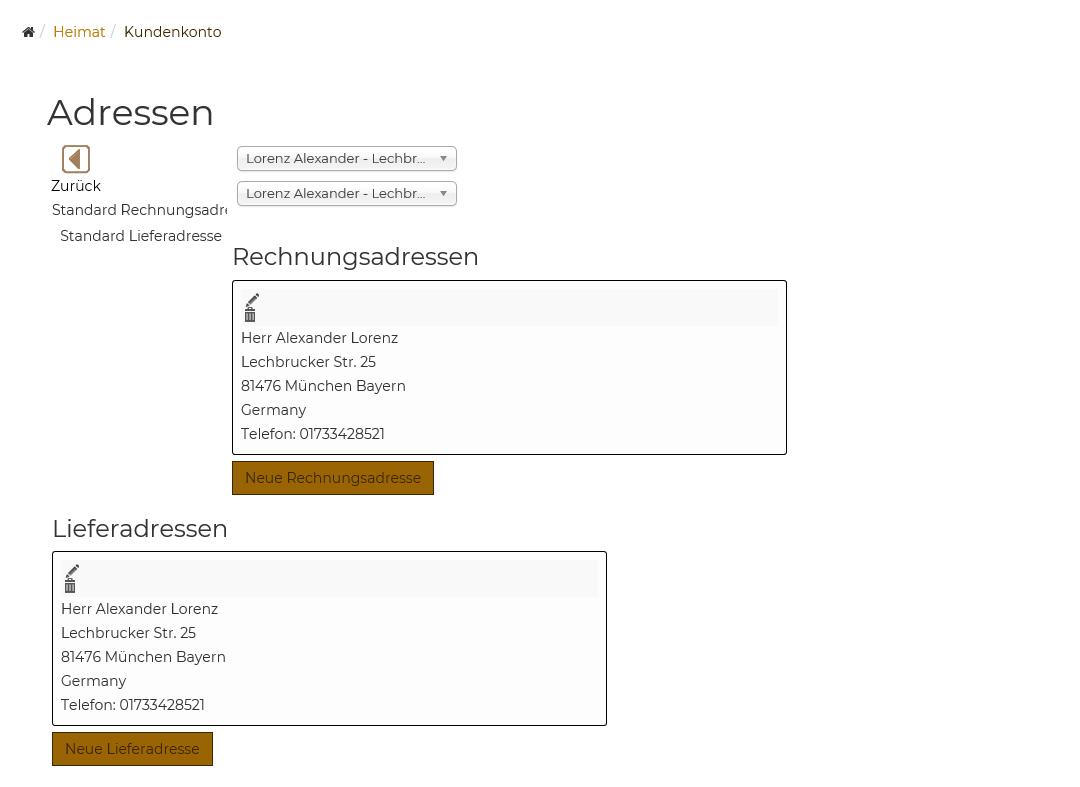

7 years 10 months ago #298451
I merged the language files and also the css files. Looks good so far beside in the customer adress are (if you are logged in as a customer). See screenshot. In the browser it looks kind of messi but in the mobil version it looks good.
What has to be changed from a css point of voew that also in the browser this looks correct again?
Thanks for your support:

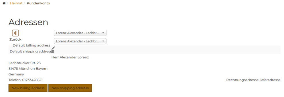

7 years 10 months ago #298509
I just have a look to your website, and more especially the User Address, it seems that you have still in your frontend some customs that leads to this result, see my screenshot as example :
I checked on our side I can tell you that this command don't come from the default frontend view.
Maybe a custom made earlier ?
Hope this will help you.
