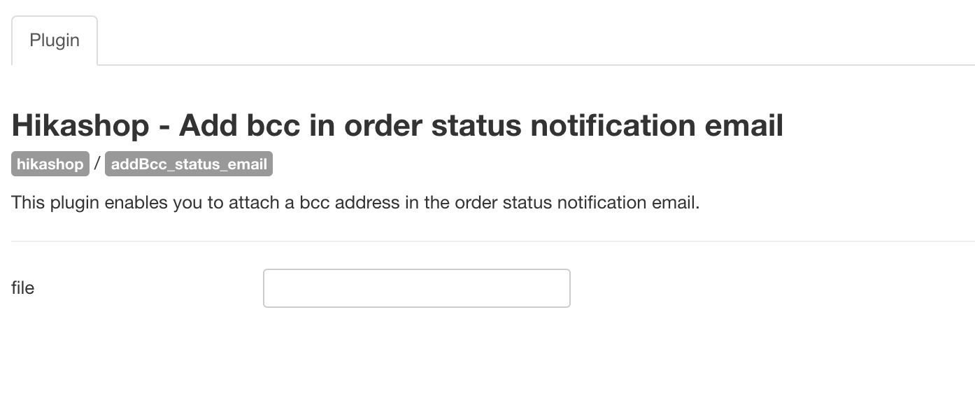

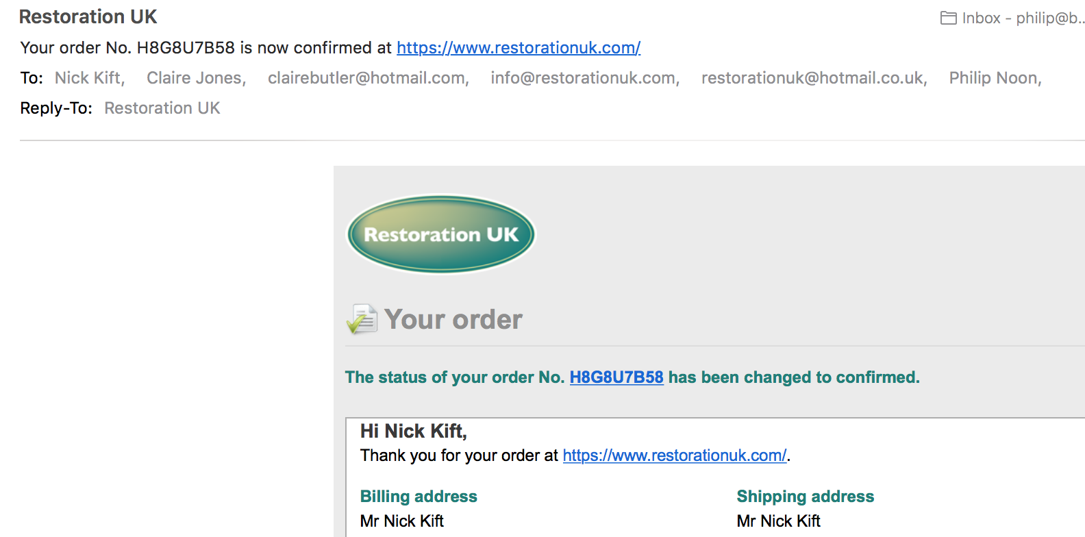

  • Posts: 256
7 years 11 months ago #298982
No they are not in email history. However I believe I remember how it was done before I used the bcc plugin to copy in when a order status is sent to the customer my client also receives it which works now.
However the bcc is not working as a blind copy as you can see everyones email in the receiving email.
I have attached the plugin I am using and the email we are receiving.

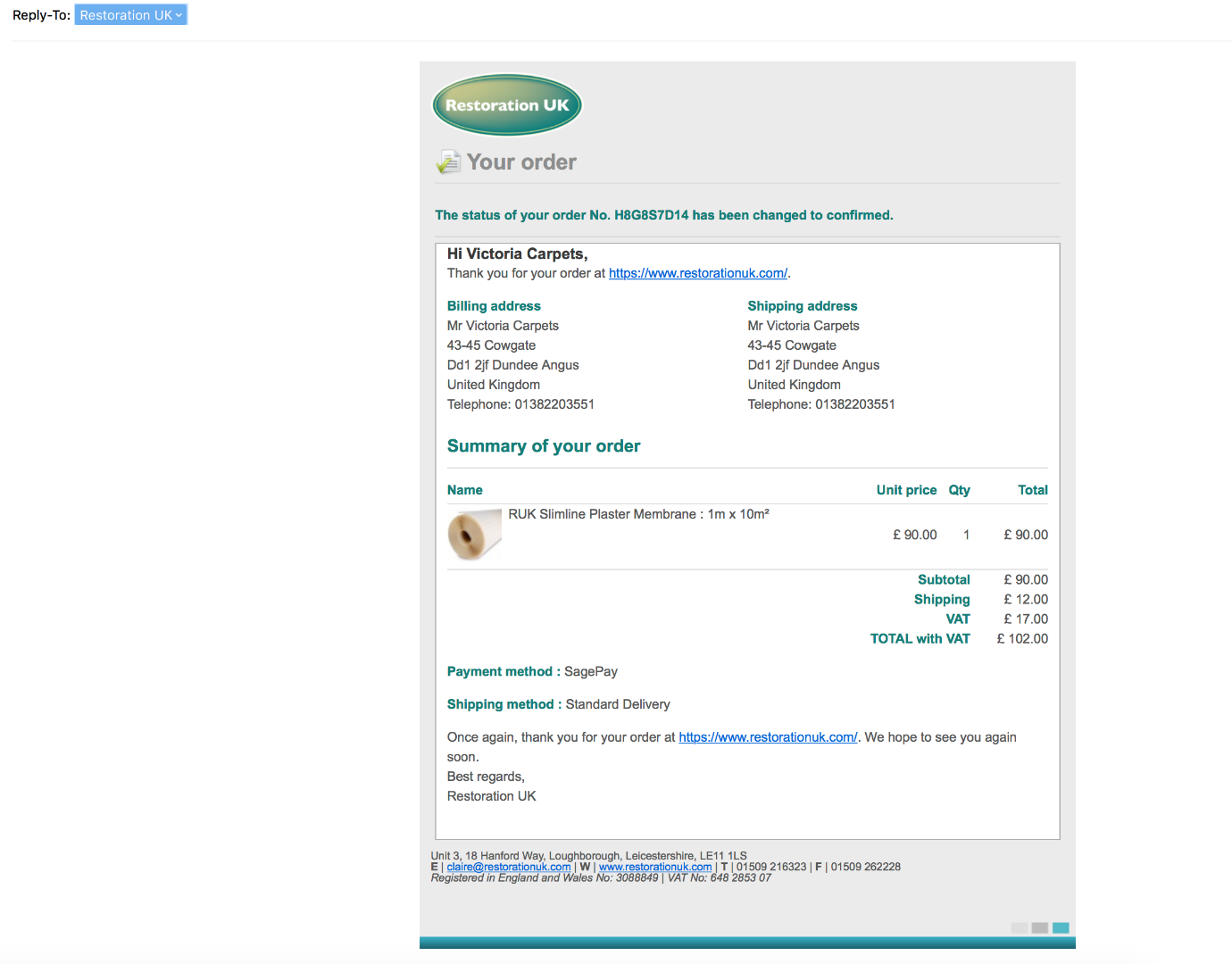

  • Posts: 256
7 years 11 months ago #299260
It is just how the client as always done it and they did receive it before.
We are currently not receiving any email notification that an order as come through. Does the notification email look similar to the status email and how would I set this up so the client will only receive the confirmation?
I have attached what the client use to receive when a order came through.

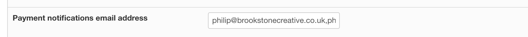

7 years 11 months ago #299330
I have already unpublished the creation email. I have added my email address into the payment notification field however I have the issue of still receiving the Paypal pending notification emails when I only want to receive the email when orders are confirmed?

  • Posts: 86180
7 years 10 months ago #299484
This plugin code always add the email addresses in the order status notification regardless of the order status.
So basically, it works like the bcc field of the emails that we have in the email edition interface.
This plugin cannot only add the email addresses for the confirmed order status and not the others. That would require some additional code in the plugin.
So I don't see how it could be working for you before HikaShop 4. I suspect that you already had that behavior before but you just didn't notice until now.
I've made a small code change to that plugin so that it adds the email addresses only when the order status is confirmed:
Last edit: 7 years 10 months ago by nicolas.
  • Posts: 256
7 years 10 months ago #299539
Thankyou I will upload and give it a test. I did have another issue with this plugin. Even thou it is meant to do a blind copy, when you receive the email you can see everyone elses emails who are copied in aswell. Not sure if you know what is causing this?
  • Posts: 86180
7 years 10 months ago #299544
Yes, that's because the code adds the email as recipient, not as bcc.
