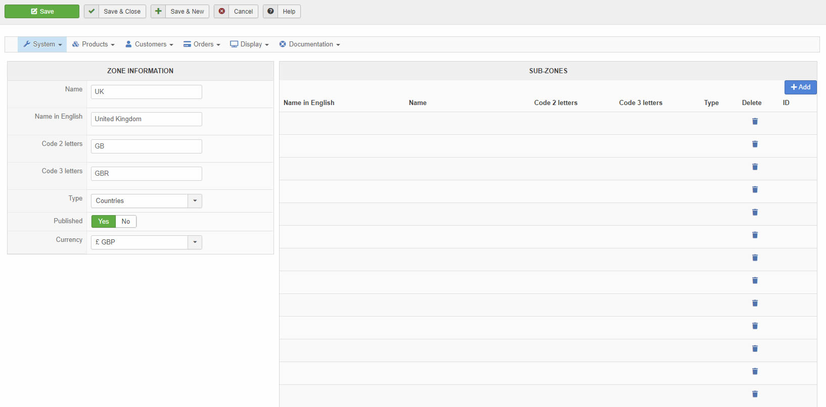

I have lots of customers where the county/state has been removed from the country. The county/state still is in hika shop however isn't associated to the country. There is also an issue which I have no idea if it is related where the country has lots of blank sub-zones (see screenshot).
I found out that the sub-zones were missing because lots of my customers started not being charged vat, the country they were listed was to be charged vat but if their address contained a sub-zone that was no longer in their country it wouldn't charge them.
I hope this makes sense.

To handle the zones in HikaShop, there are two tables in the database:
- hikashop_zone which stores the information of each zone
- hikashop_zone_link which stores the links between the parent zones and the subzones.
If you have blank lines, it means that there is an entry in hikashop_zone_link pointing to a zone that has been deleted in hikashop_zone.
I would recommend to delete these two tables, install again the install package of HikaShop 4.0.2 and that will put back all the zones as they were by default. Then, add the zones that you need (if any), relink the zones in the "zone" setting of your tax rules, payment methods, shipping methods, discounts, coupons if you set any and you should be good to go again.
