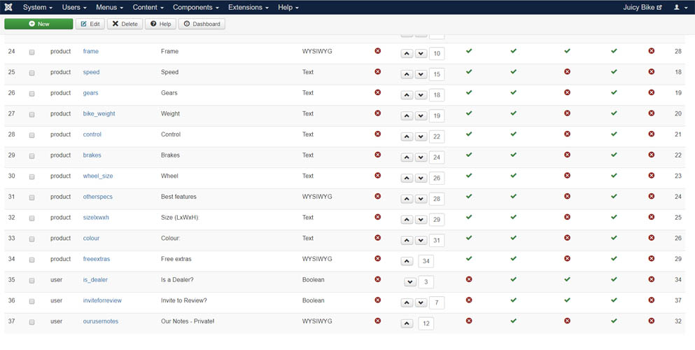

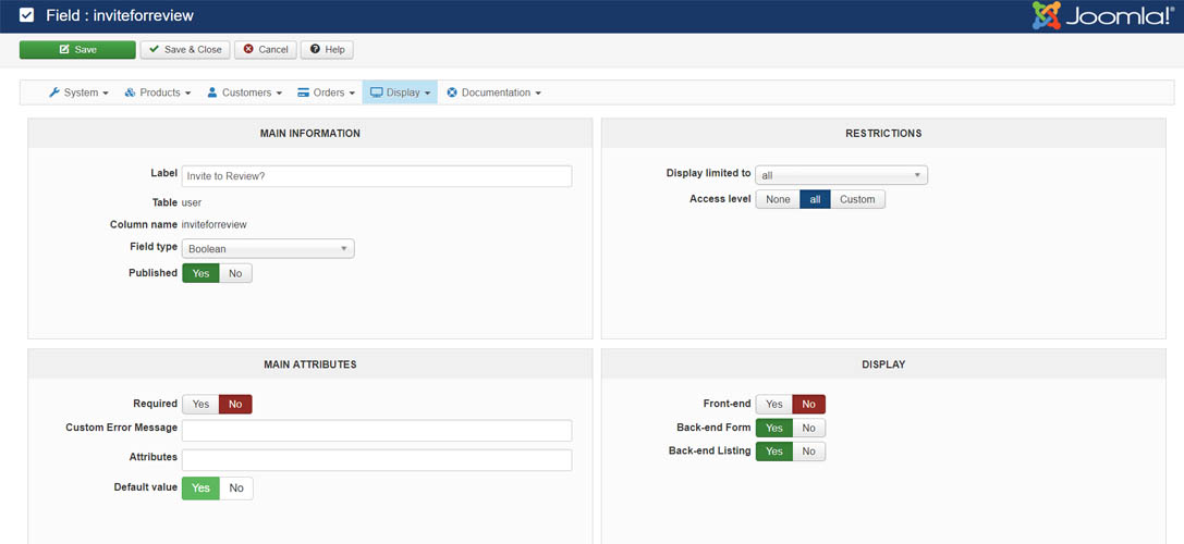

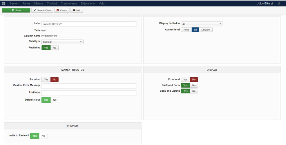

1. Attached the field settings list...
2. And the field details...

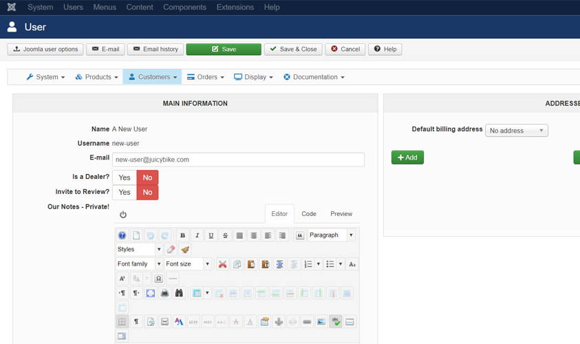

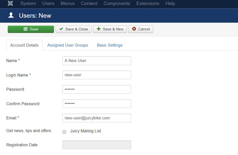

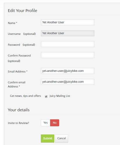

3. I create a new user from the back-end...
4. I check the new user's details in Hikashop...
For some reason the Invite For Review field shows "No", but the default setting shows as "Yes".

It's actually not a problem of the fact that the custom field is a boolean custom field. you would have the same issue with any kind of custom user field with a default value.
That's because you create the user from the backend and on the backend form to create the user, these custom user fields don't show up so their default value cannot be initialized.

And are you sure that you turned on the "frontend" display setting of your custom user fields so that they can display on the frontend ? Otherwise, they will be ignored like when you create a user from the frontend.

7 years 7 months ago #303379

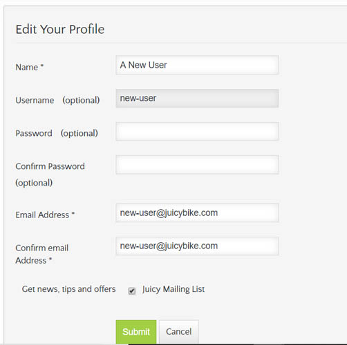

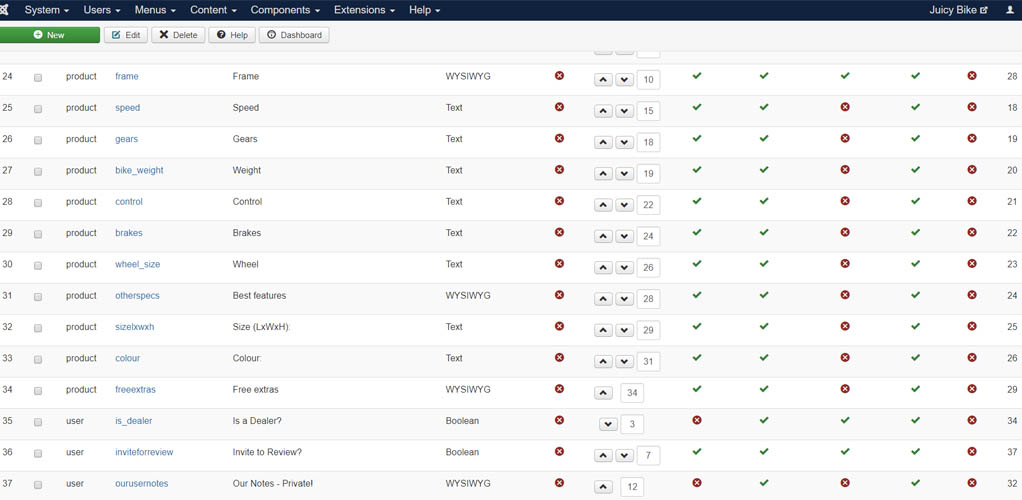

Yes Nicolas - just tried that way again and took screen shots to show you...
But anyway, we would not want this field to appear on the user profile. This is a field just for our back-end use.
And you will notice that although Subscribe to Newsletter is set default = No, it appears as checked, which is not as intended.
Hope this helps - I think I have correctly understood how to configure these fields.

  • Posts: 26384
7 years 7 months ago #303385
And regarding your screenshot, the field "invite to review" IS displayed in the front-end, we can see the green checkmark on the column just after the ordering column.
So the field is displayed in the front-end because it is configured as well.
But your screenshot is showing the edition of the profile ; not the registration. Which mean that we can't deduce anything from that except that when you edit a profile, it load the current saved data.

7 years 6 months ago #304045
Thanks for your reply Jerome
The screen shots show the results of Nocolas' suggestion. He suggested I tried "Show on Front End", so I did and then gave Screenshots to show the results of his suggestion. The user was created on the Front End also, as Nicolas suggested.
You can see that new user has their Invite-For-Review setting to "No", whilst the settings for that field default = "Yes".
So, it doesn't make any difference Front End or Back End user creation, Show on Front End or Hide on Front End - the default setting is ignored (which is a pain).

  • Posts: 86106
  • Thank you received: 14206
7 years 6 months ago #304107
I checked your settings.
All your custom user fields have the "frontend" setting turned off.
So the custom user fields are not displayed on the HikaShop registration forms on the frontend and thus their value is not initialized, as if you were registering through the Joomla registration form.
You need to activate the custom fields and if you don't want to display them to the user, you can use custom CSS to hide them.
Alternatively, do no use a "boolean" type but a radio type. Then, when you add the yes / no values to the custom field values list, make sure that you leave the "value" input empty for the default value you want. That way, even if the custom field is not displayed on the form, the default value will correspond to the field not being used and it will display properly on your user details page in the backend.
