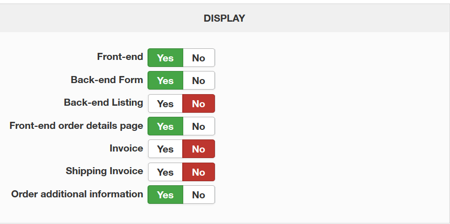

If you edit the custom field via the Display>Custom fields menu, you have the setting "Back-end Listing" that you can activate and the custom field value will appear on the listing without any code modification to order / listing.php
Now this will display the value of the custom field, not the input field. If you want the input field, it will require coding. First in order / listing.php to add the HTML of an input field, and then add a controller via a hikashop plugin to be able to save the data in the custom field column in the database.

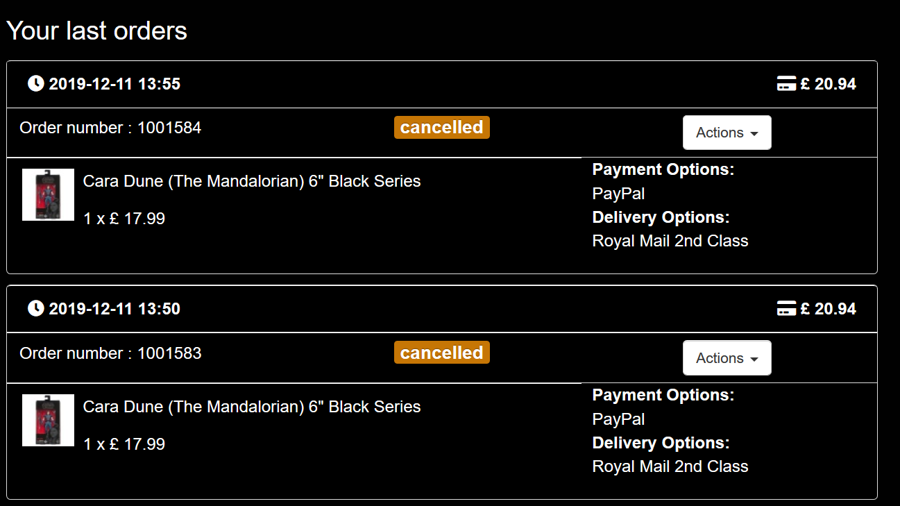

It is required in the front end listing under the order number if possible. So I need the value only to be displayed. On this page as well user / cpanel_orders.php again under the order number.

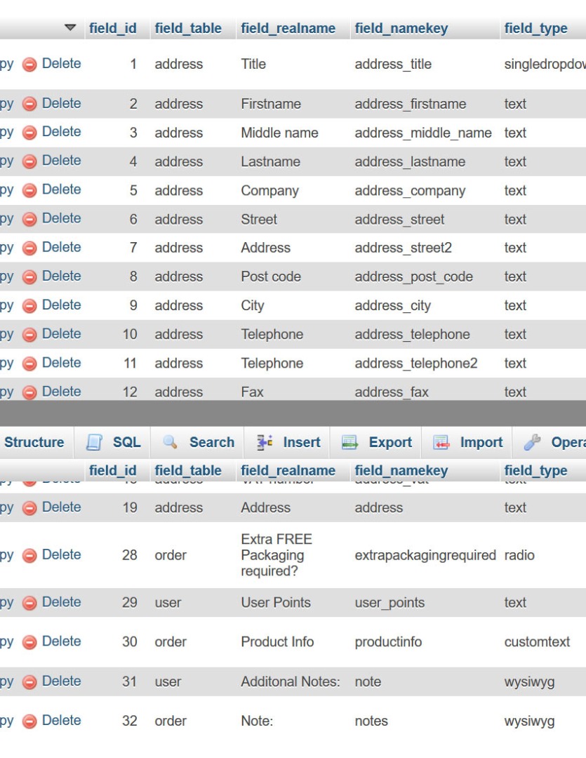

I would just like to clarify what I should be entering in the code. The field is in the Hikashop field table as per attachment.
Dave

so column name will be field_realname, so it should look like as below?
<?php echo $row->field_realname; ?>
Dave
Dave
6 years 8 months ago #316509
by nicolas
Replied by nicolas on topic Add a Custom Field To A View
No. You should replace field_realname by the column name of your custom field. If you custom field name is "extrapackingrequired", then your code should be:
<?php echo $row->extrapackingrequired; ?>
