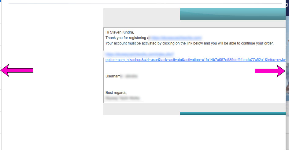

When a new customer 'registers' they are sent an activation email. However, they come in aligned to the far right and much of it is clipped off from view as shown int he attached.
How do I remedy this?

6 years 7 months ago #317990 by dagroupinc
Replied by dagroupinc on topic Activation Emails
Using Mac Mail. In all my years we've never seen this occur before.

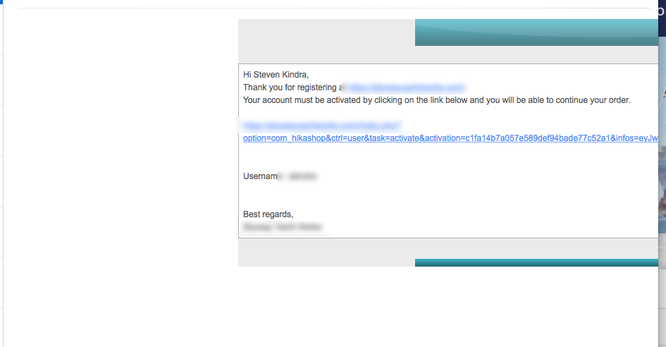

6 years 7 months ago - 6 years 7 months ago #318018 by dagroupinc
Two things:
1) I don't see a way to edit the email at System>Emails — we only see the list of possible emails, none refer to the activation email, and it doesn't appear we can edit them here—only turn them on or off.
2) However, my original issue was that the activation 'message' is positioned very far to the right in the email viewport, and no matter how far we expand the viewport to the right, the entire message cannot be read.
This seems to be isolated to the activation email. — See attached.

6 years 7 months ago - 6 years 6 months ago #318042 by dagroupinc
1) Ok
2) I would still expect the content of the email to align all the way to the left of the viewport. It's clearly aligning right.
3) We had a case where a customer entered the wrong CVV code and we only received a payment confirmed email, but when we checked we found that the transaction was declined. One confusing thing is when a transaction is actually delined the emails say 'canceled' which seems to suggest that the customer canceled the order instead of the payment being declined.

6 years 6 months ago #318126 by dagroupinc
2) My point is that we only have an alignment problem with the activation email—none of the other Hikashop emails.

6 years 6 months ago #318150 by nicolas
Replied by nicolas on topic Activation Emails
2. Well yes. That's the only email with a URL printed in full in the email. That's why I told you to change the link to not print the URL in the link and only have it in the src attribute. That way, it should display fine too.
