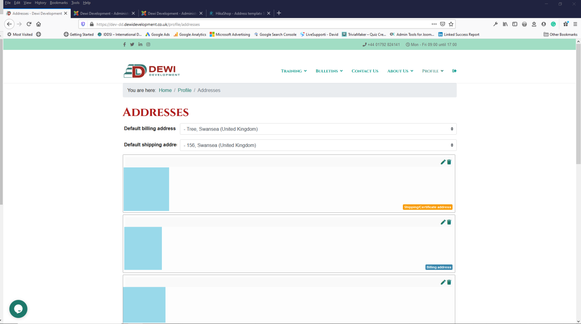

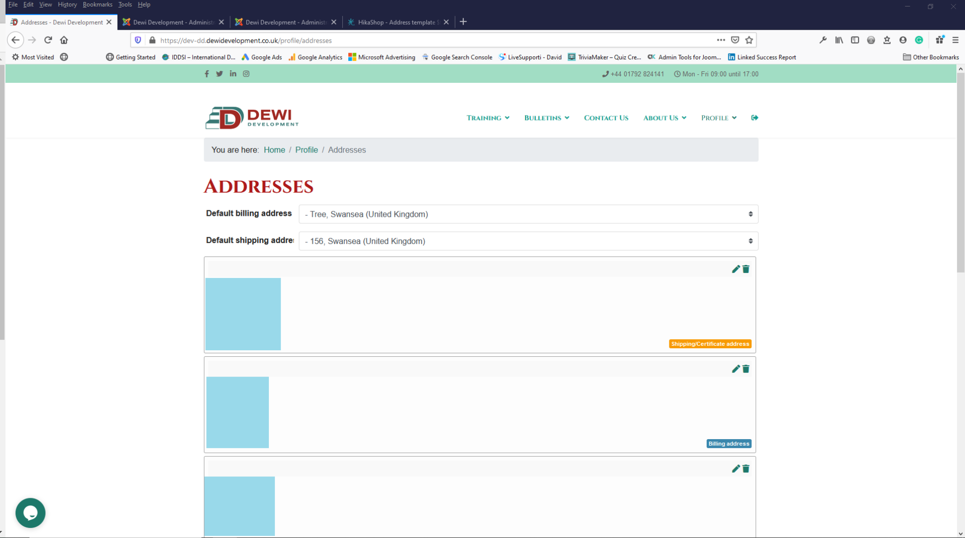

Address view. I use to have two columns of addresses, but now I have one column, with each address saying billing and/or shipping in the bottom right corner. I'm not sure how you set which type it is, as there are no options to set in the edit screen. Have I missed a change or I have I changed a setting for the layout without realising?

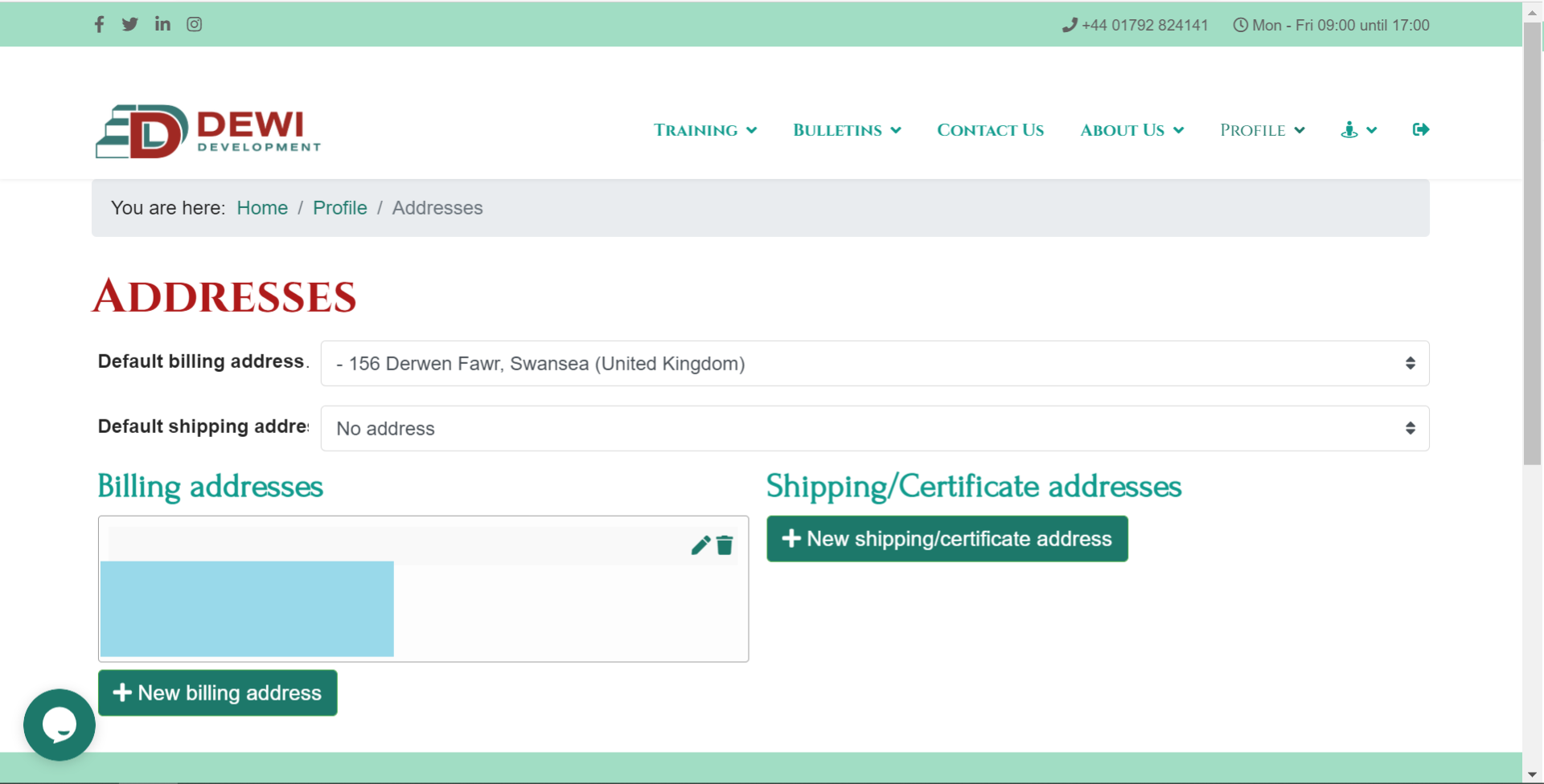

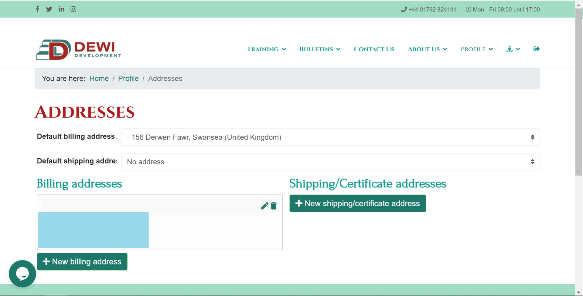

  • Posts: 52
  • Thank you received: 6
5 years 6 months ago #328881
Morning
I have had another look this morning after putting the system live over the weekend. The live setup was a copy of the development environment.
In live I got View2. In development I got view1. It does not matter if I go in through the profile cpanel or through an address menu.
I have just tried development again but viewing with the same user as live. I get View2, the same as live. It suggests it is something about the user. But I am not aware I changed anything on the user?
I prefer View2.
Thank you
David
