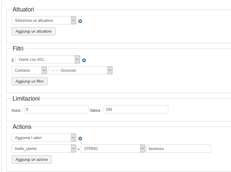

At the moment we have 2 user_level values: customer and reseller.

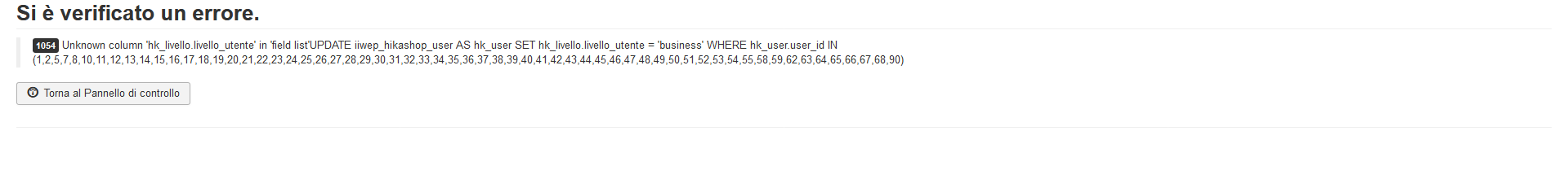

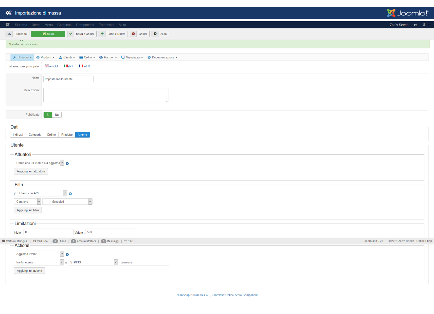

Customer is the default one, but many of them have already been moved to reseller Joomla Group, instead the new field shows "customer".

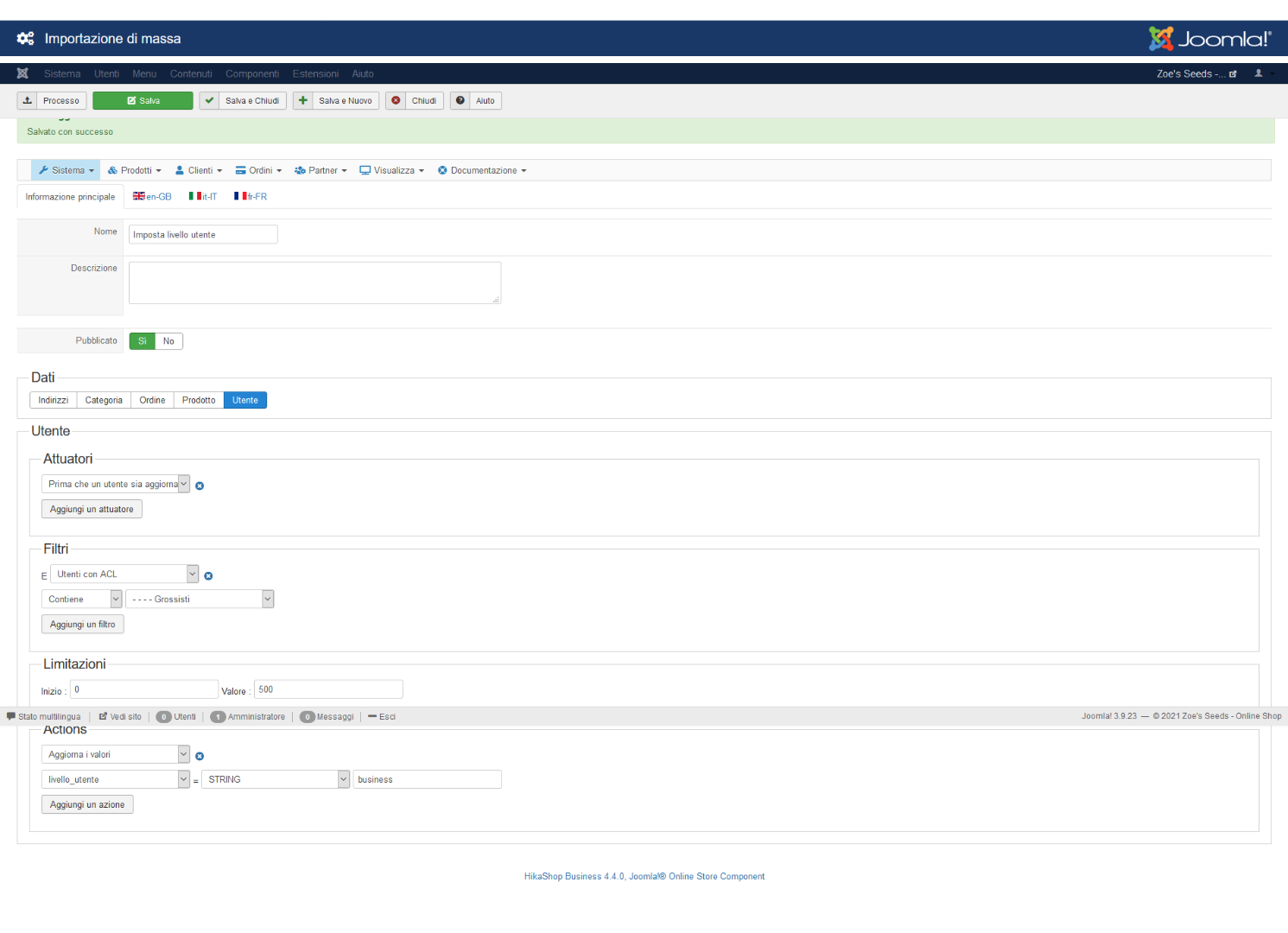

If the owner update the client without changing the new custom field, the user is moved back to customers Joomla group, as I've made that action too, of course.
So I would like to create a new mass action that changes the user_level value based on real Joomla Group, so to sync everything.
I've made a new mass action that you can see in the attachements. It should be run just once.

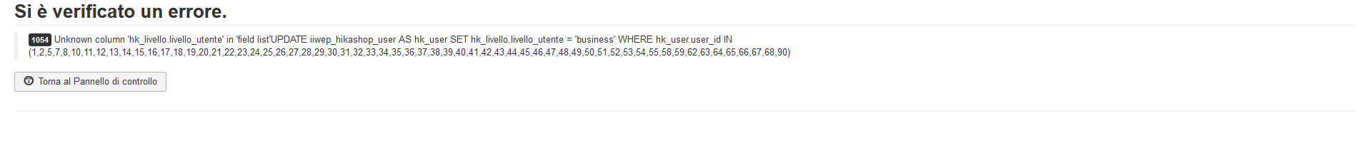

But I get a MySql error.
Searching on forum I've found a previous post where you asks for detailed mysql error message.
Made that change in the database/exception/executing.php
I post the erorr in the attachments too. Hope it helps.
Thank you for your precious support.

Looking at the MySQL error message, it seems that for some reason the alias of the table "hk_user" is translated to hk_livello for some reason.
However, I tried to run a similar mass action and I'm not able to reproduce the error.
So I must be missing something about your setup.
I think I'll need a backend access and a FTP access to check on the issue directly.
Could you provide that via our contact form ?

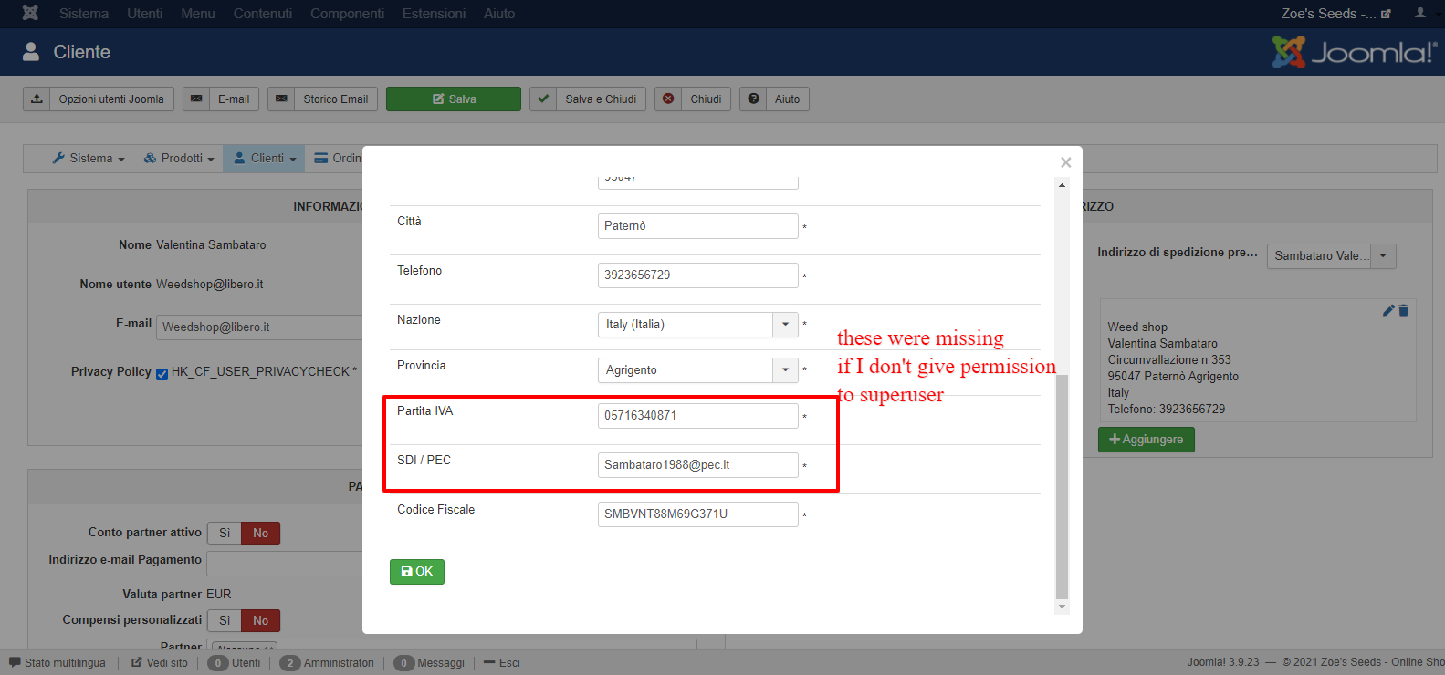

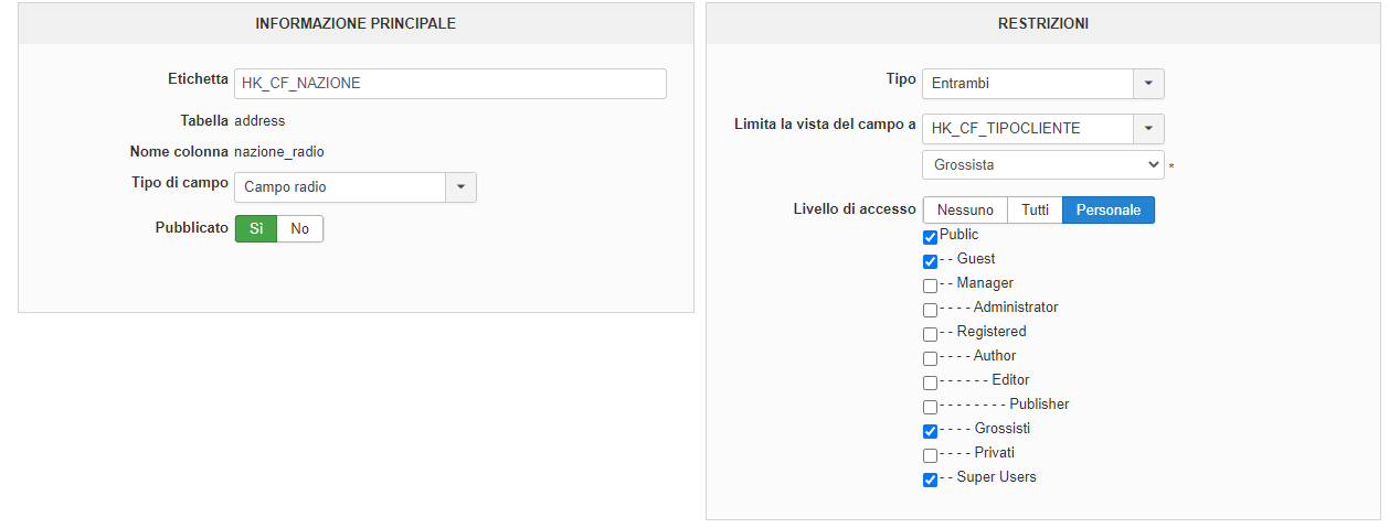

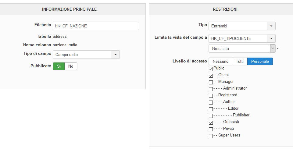

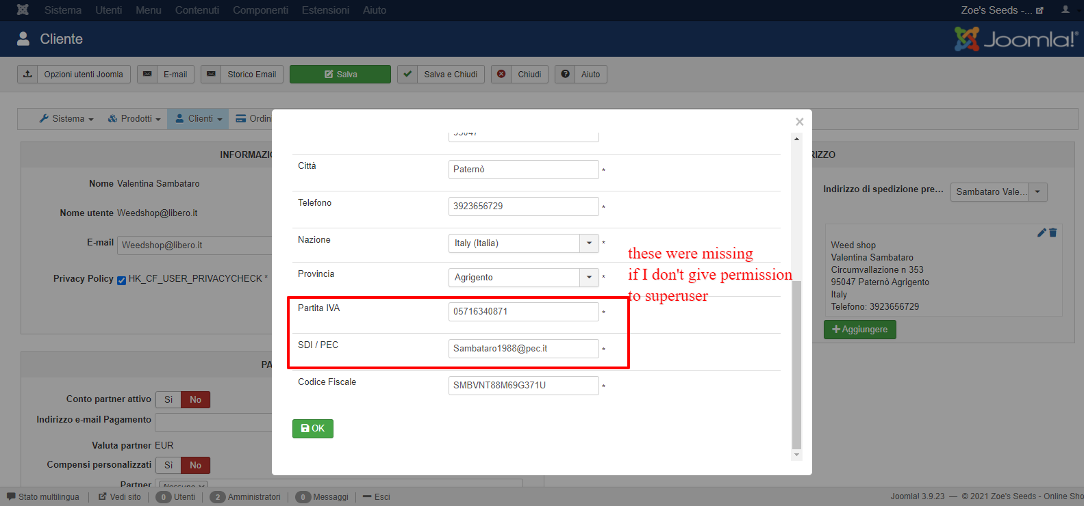

Meanwhile, this morning the owner noticed a wired behaviour.
Inside the client page some address table fields were missing. Vat number and pec address were not displayed anymore in the billing address.
I made a check on the test site too, where these fields are shown correctly.
The test site is a back up of last week; during this week I've made some modifications to the products page view, but nothing related to these values (vat and pec).

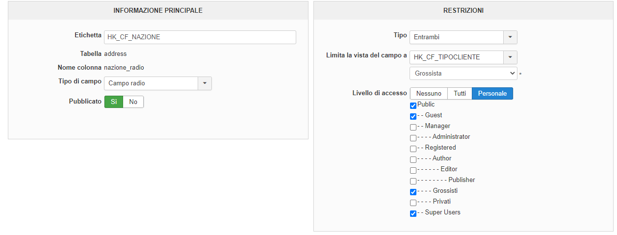

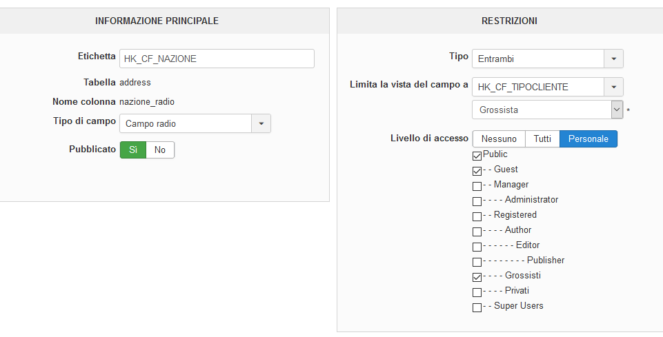

Long story short: after some hours of tries and errors I've found that on the live site I had to make these fields available to superuser too.
The wired thing is that on the test the superuser is unchecked and the fields are visible, you can see the parameters in the screenshots.
Thank you.
Davide
  • Posts: 64
  • Thank you received: 6
5 years 7 months ago #329086
don't consider the second part of previous mail.
I've never relized that ACL was involved in the visualization of data in admin too.
Sorry :)
Davide
  • Posts: 86177
  • Thank you received: 14212
5 years 7 months ago #329117
Thanks. I found the issue.
A mass action on the user data with an action "update the values" on a column from a custom field not starting with "user_" would generate a fatal error.
And of course, on my local test environment I was testing with a custom field with a column name starting with "user_" and thus it worked fine.
I've added the patch via FTP on your website and confirmed it fixed the problem.
We'll also add the patch on our end for future versions of HikaShop.

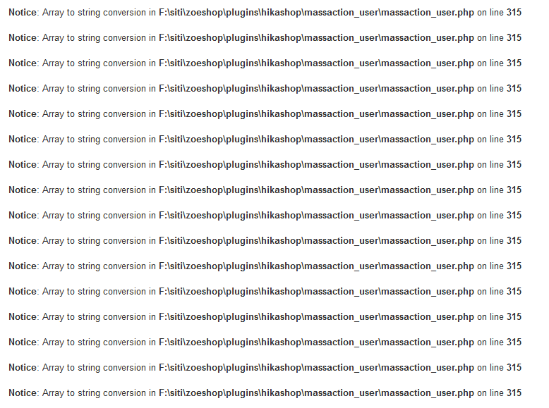

Hi!

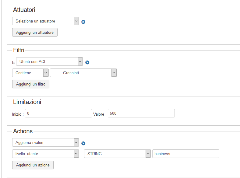

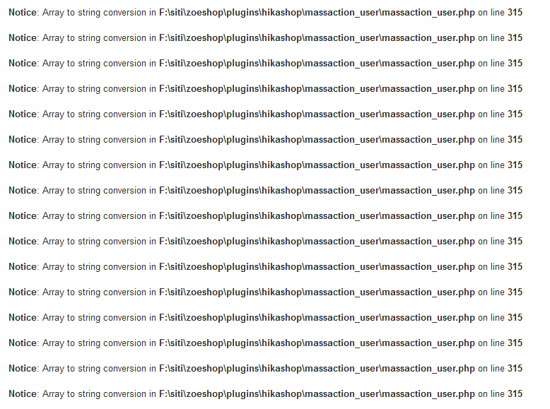

I've run a test on my local enviornment. It works as intended but I've recieved a message at the end.
Maybe I've made something wrong with the action rules or maybe is just a message.
I attach both files (message and config), can you please confirm I've not made a mistake.
Thank you
  • Posts: 86177
5 years 7 months ago #329218
Thank you for your feedback. It's another small bug. No worries.
I've added a patch for it.
So you can download again the install package of the latest version of Hikashop on our website and install it on yours to get the patch.
