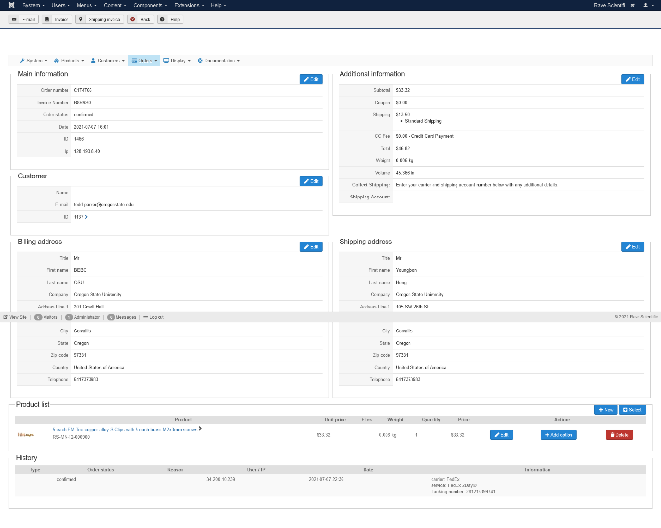

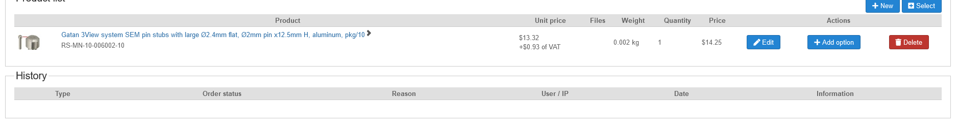

Could you provide a screenshot of the "history" area at the bottom of the order details page in the backend for an order with the issue ?
Also, do you have any custom plugin developed on your end on your website ? Did you configure any mass actions in the menu System>Mass actions ? Did you customize the emails in System>Emails ?
  • Posts: 32
4 years 11 months ago #334403
Yes it seems that orders using the credit card payment method through Authorize.net are not triggering the "order creation notification" for the customers. The order goes through but the system does not seem to send the email to them. This never was an issue until recently and I'm not aware of any changes that would have caused this. I attached a order history screenshot of an order with the problem, I can see that there is no line for the "payment notification" only a line showing the order was confirmed and with shipping details.
Regarding custom plugins, no I don't have any setup. Also regarding mass actions there are some setup but none are set to run without manually running them. They also have been setup for a while now before this problem started to happen.
Regarding the System Emails and customizing, Yes. We did customize them but also this was done a long time ago before this problem starting happening. Nothing has changed that I'm aware of.
Not sure what the issue could be but I attached a screenshot of the order history area for a customer that didn't get the email, and I attached the customized "order creation notification" system email and the "order status notification" system email so you could have a look at the them too. Let me know what you find. Thanks.
  • Posts: 85786
  • Thank you received: 14079
4 years 11 months ago #334406
If you check the code of the "save" function of the file administrator/components/com_hikashop/classes/order.php you can see this:
			$app->triggerEvent('onAfterOrderCreate', array(&$order, &$send_email));
			$historyClass->addRecord($order);
			if(!$send_email)
				return $order->order_id;
			$this->loadOrderNotification($order,'order_creation_notification');
			$mailClass = hikashop_get('class.mail');
			if(!empty($order->mail->dst_email)) {
				$mailClass->sendMail($order->mail);
There, the line
is responsible for adding the line you can see on your screenshot in the history area. So that means that the code run up until there.
And the line
is the one sending the order creation notification email.
In between, there is not much, so the list of causes is:
- the $send_email is set to "false" by a plugin implementing the onAfterOrderCreate trigger. This could be done by a custom plugin. Besides that, I don't see what would do that. I checked all the plugins in HikaShop and none change that variable.
- the email order_creation_notification can't be loaded for some reason or the $order->mail->dst_email attribute is empty. This could happen with some customization but that's about it. I checked your files and it seems ok. I would recommend you try to use the "preview" button of the order creation notification on the same order for which the email was not sent. Maybe you'll be lucky and get some clue on the problem.
- the loading of the order_creation_notification email results in a fatal error. In that case, the customer should see a blank page at the end of the checkout, and you should be able to see that fatal error message in the PHP error log of your server. So I would recommend checking there.
There is nothing else I can reasonably see which could cause the email not being sent so if the the things above don't yield any interesting information on the problem, it will be necessary to add
hikashop_writeToLog('step x');
between each lines of the code above (with a different number instead of x each time). Then, reproduce the issue once and look at the "payment log file" in the Hikashop configuration. You'll see the "step 1", "step 2", etc messages at the end and you'll see if it stops somewhere. That way, we'll know where to look.

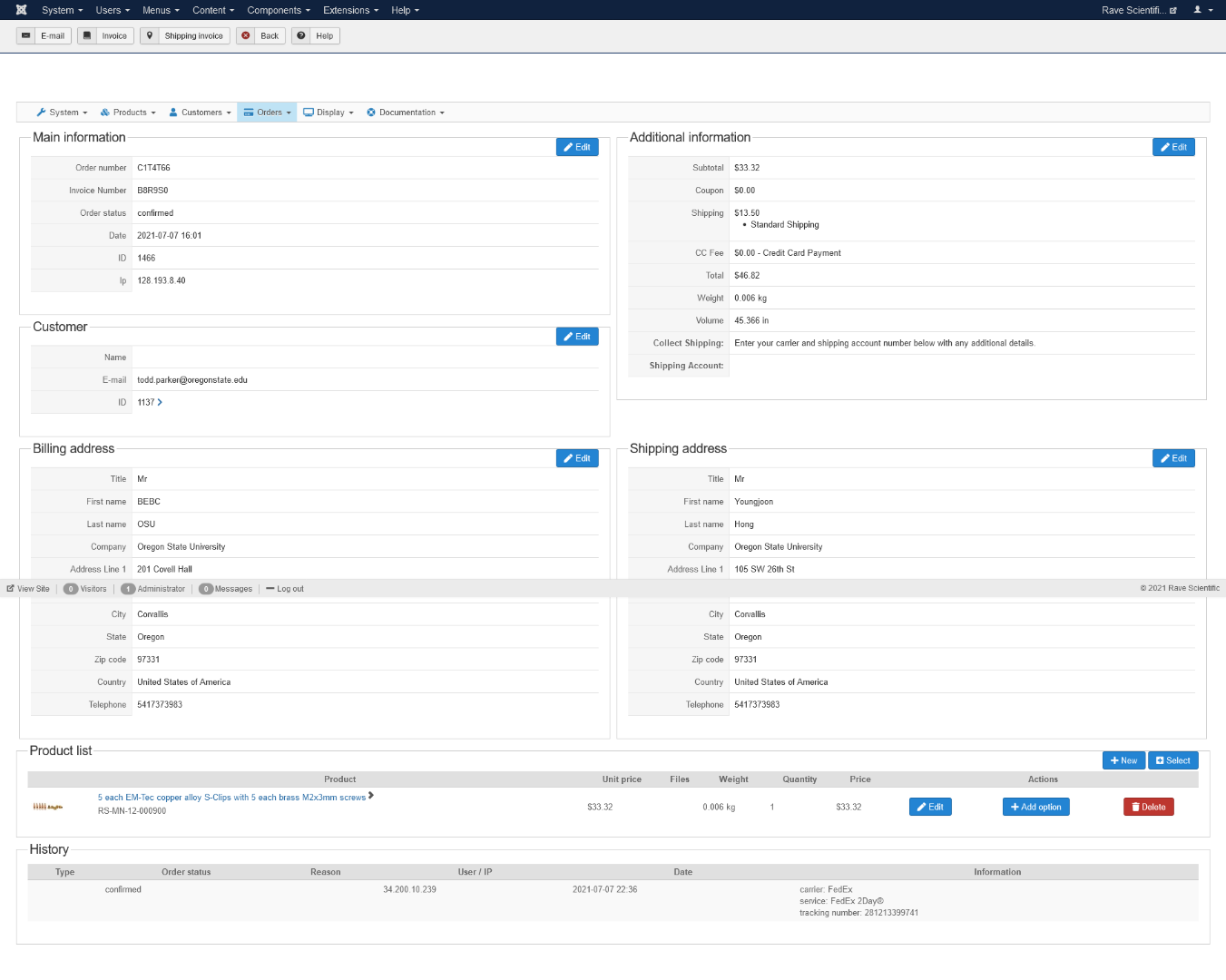

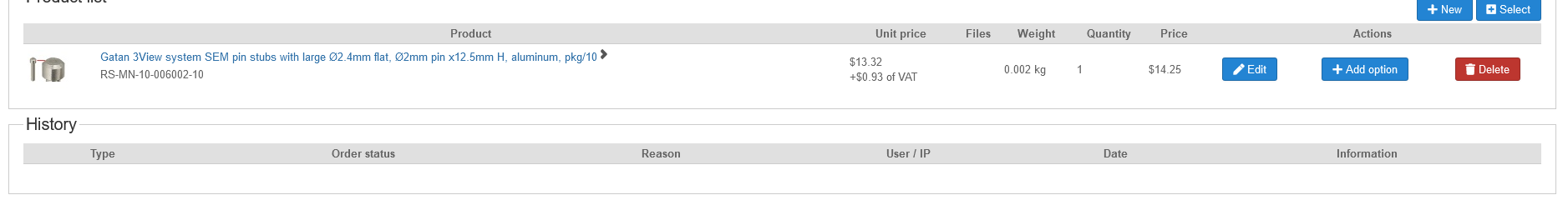

Also I attached a screenshot of the order history for a transaction that didn't send the users order creation notification email. You can see we have no history.
Any thoughts on this? Thanks in advance.
