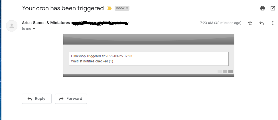

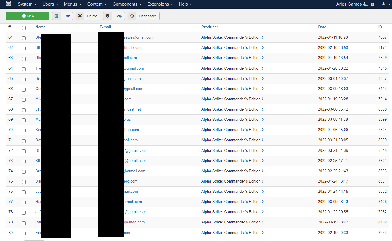

4 years 4 months ago #340415
Nicolas...thank you for the deep explanation.

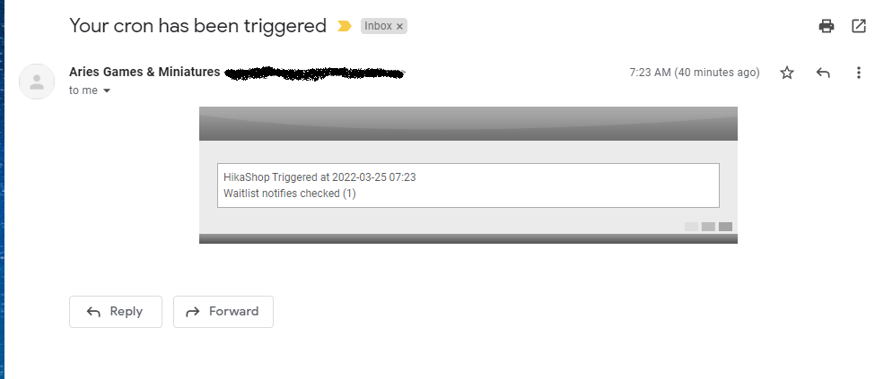

SO I checked everything you mentioned in #1, and I have it set to send 100 emails every 12 hours (been like this for several years now), but as of this morning, I see my cron only sent 1 email notification out...and I still have 54 people waiting for a notification for this single product.

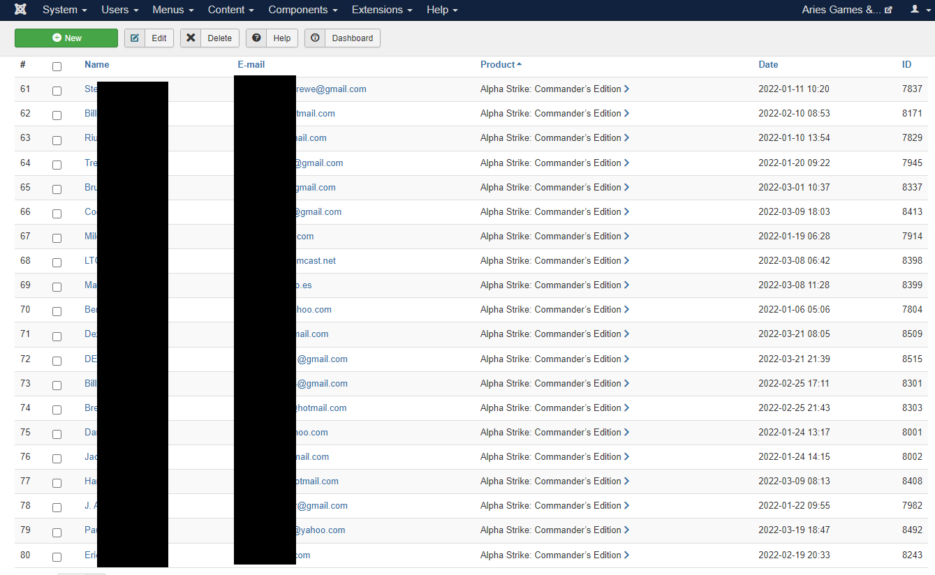

Any thoughts on what I can check? I've attached screen shots for the Cron notification I just got a while ago, and 1 page of the waitlist for this product. I will be getting another 30 in today, so need to get these going out to customers...but I still have a few left in stock so I'm not understanding why these emails aren't going out. Some of these people haven't been waiting long, others...have been waiting for almost a year (next page on the waitlist).

Could it be that you have several products with the same name ? If you click on the arrow next to the name of the product on the waitlist listing, do you get the information of the correct product ?

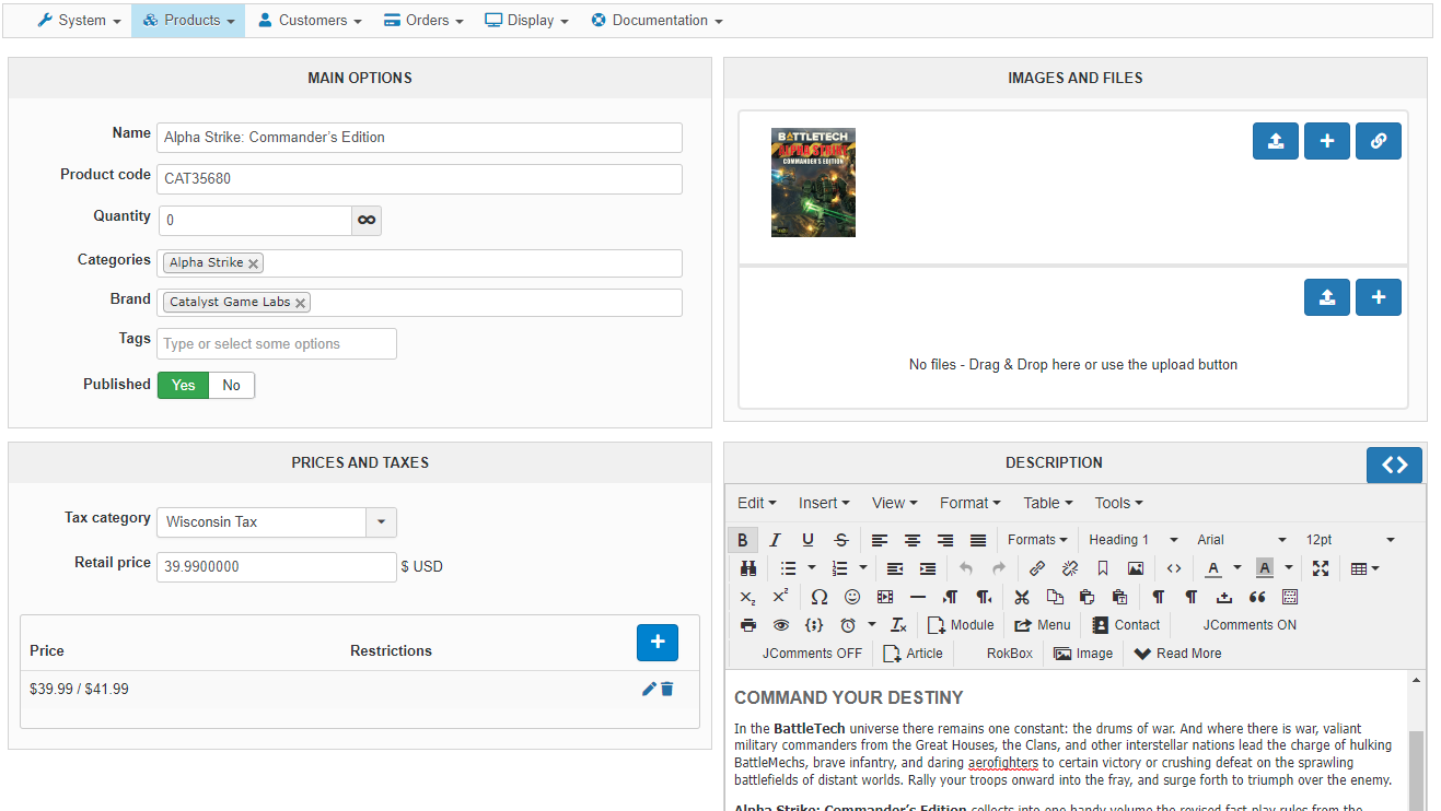

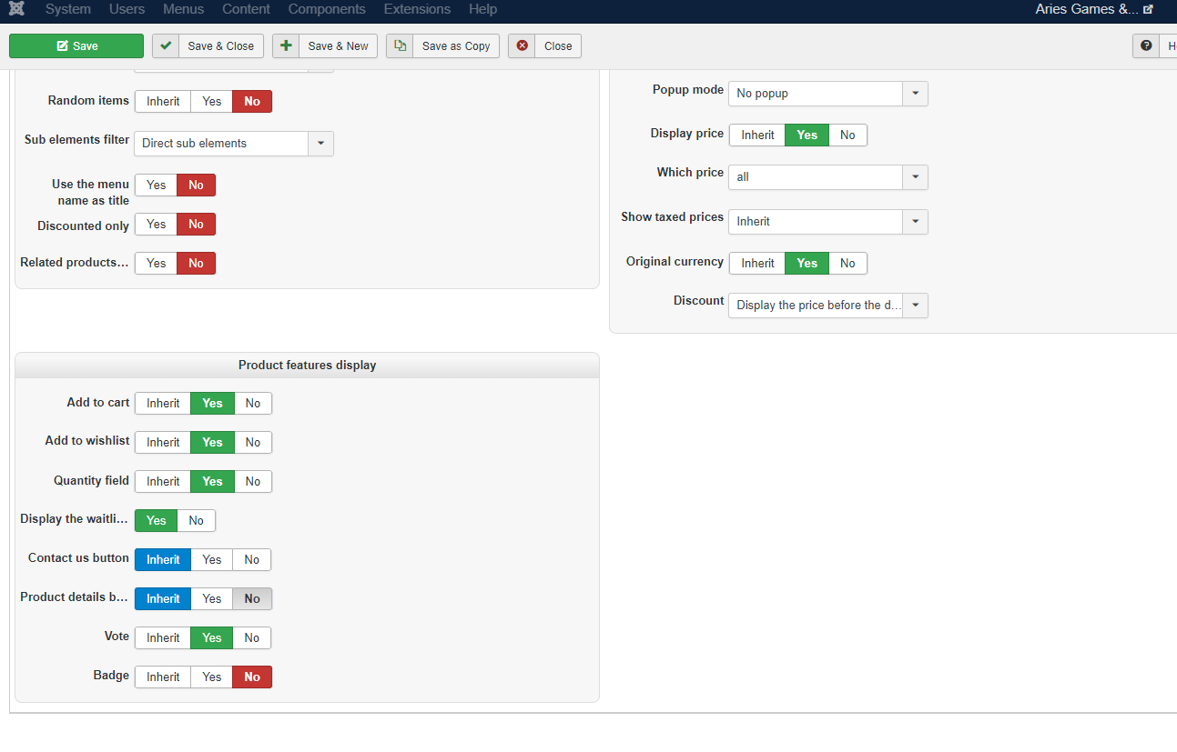

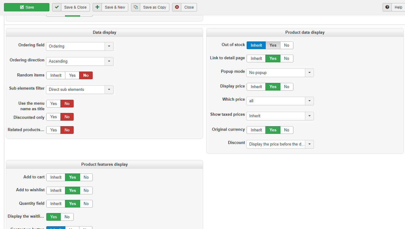

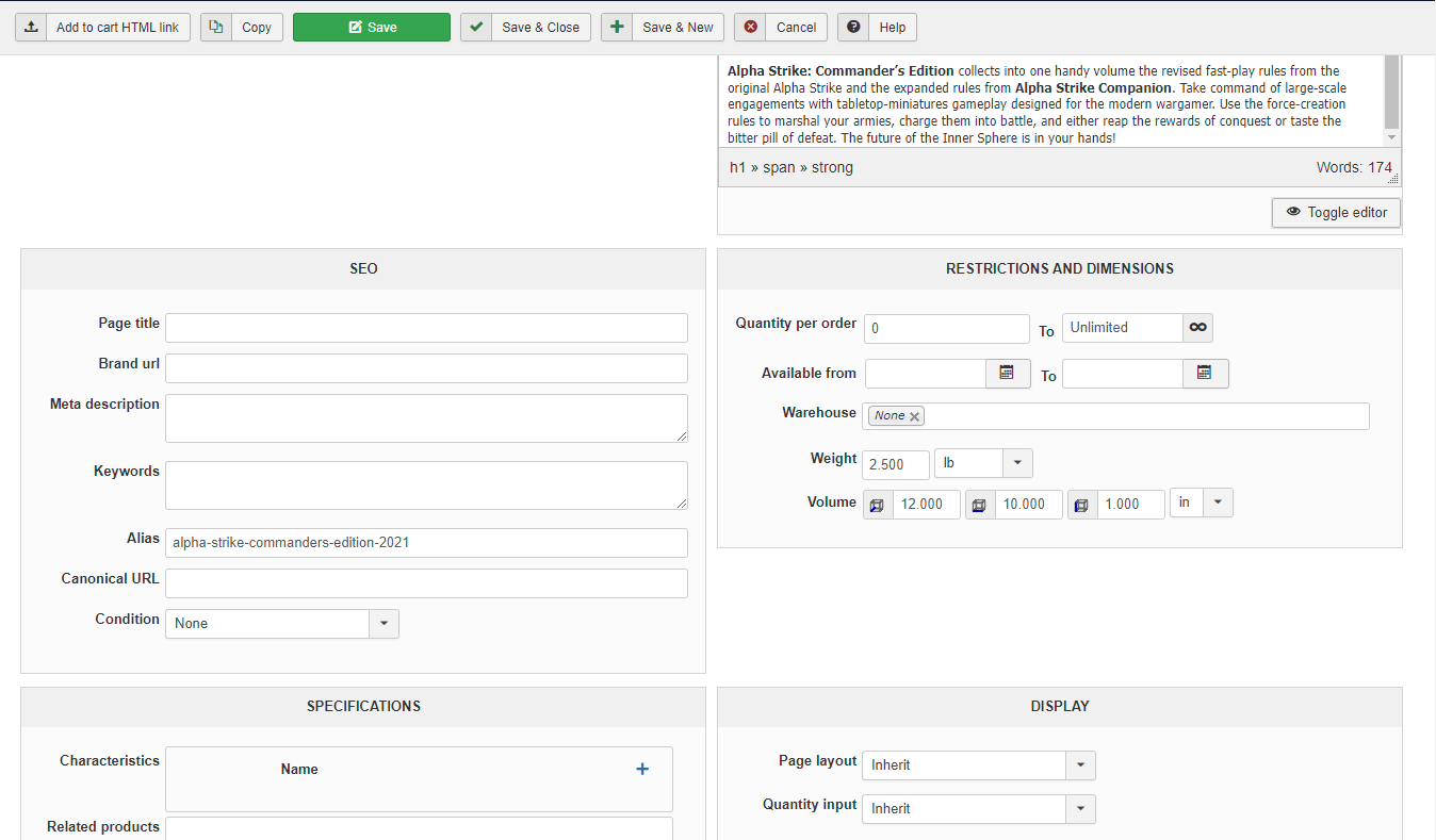

4 years 4 months ago #340436
Could it be that you have several products with the same name ? - Nope...just a single product with only 1 name, no others like it
If you click on the arrow next to the name of the product on the waitlist listing, do you get the information of the correct product ?Yes
Or could it be that this product has variants ? - Nope...just a single product with only 1 name, no others like it
How is that product configured ? - Correctly just like all my other items on the store. Emails go out, but not ALL emails are sent when I have product

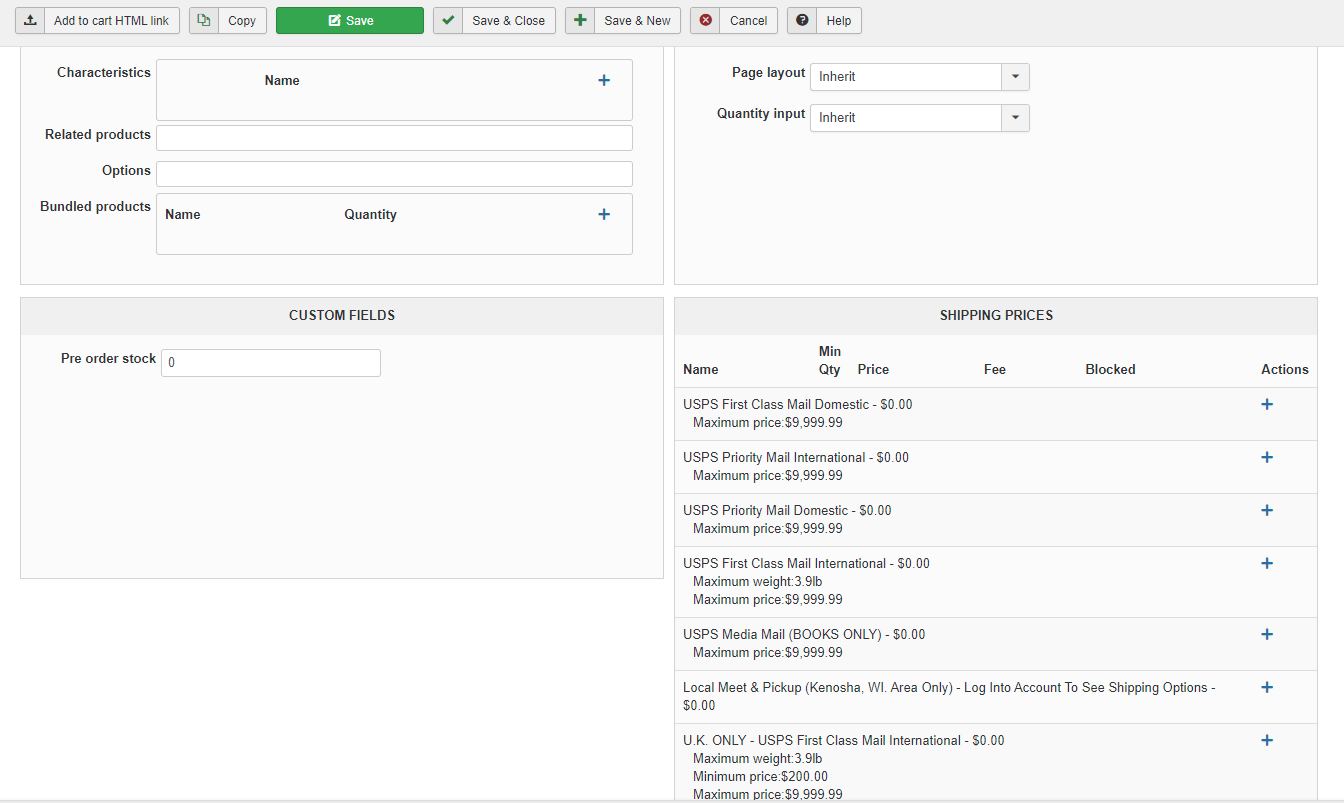

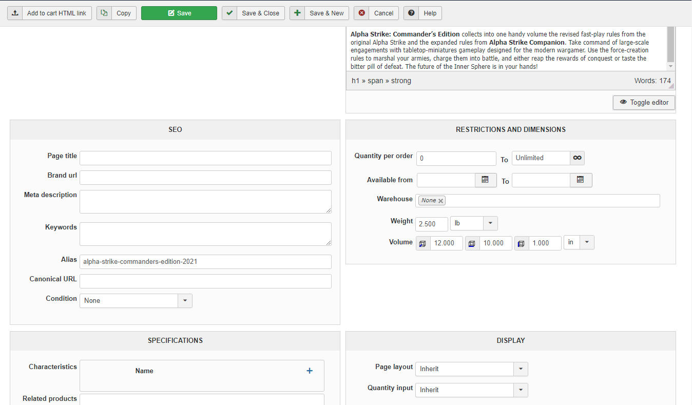

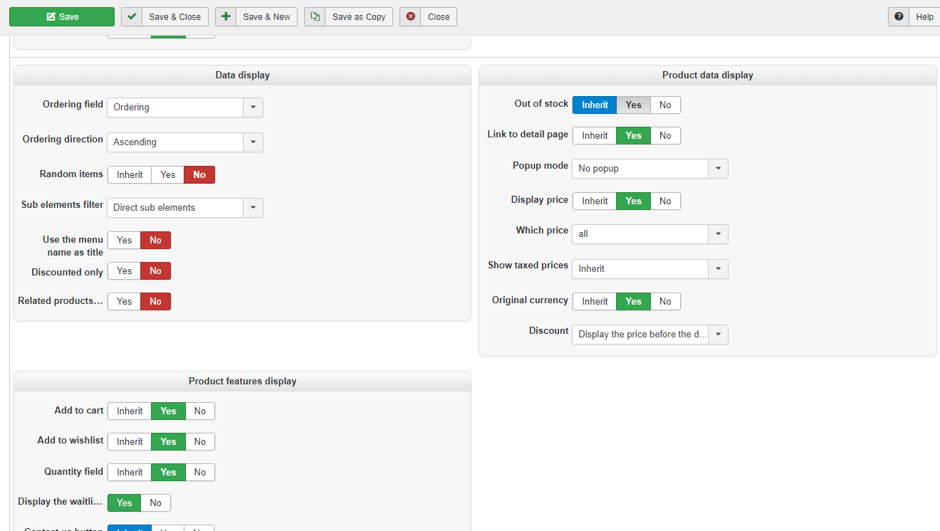

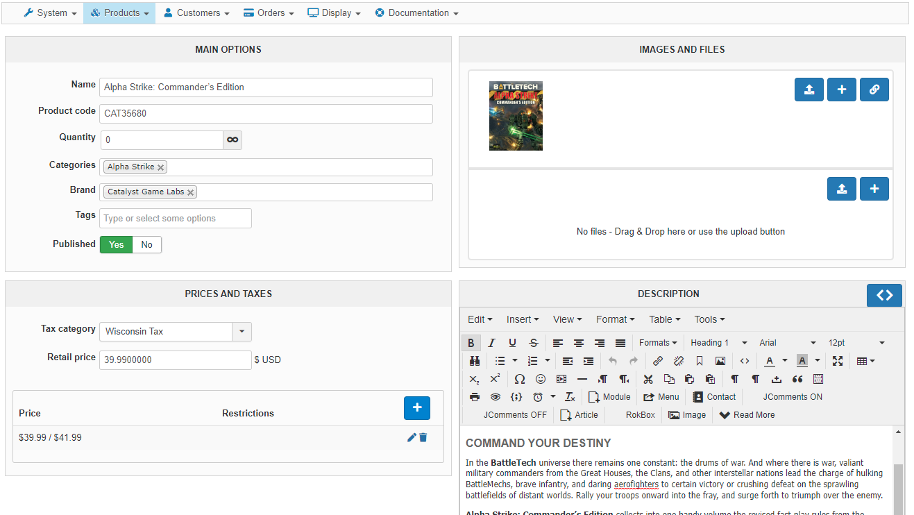

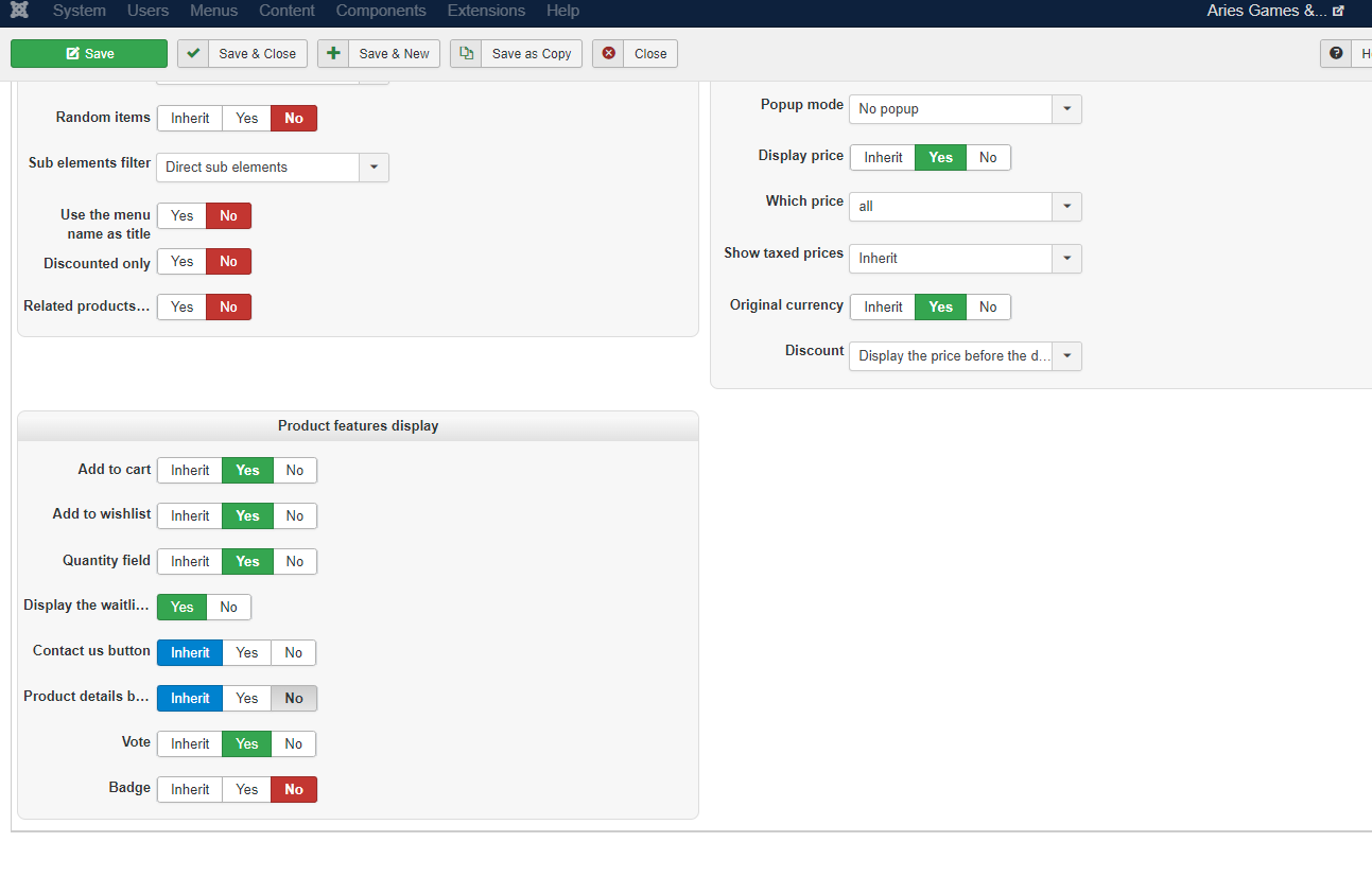

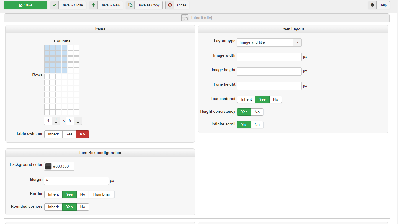

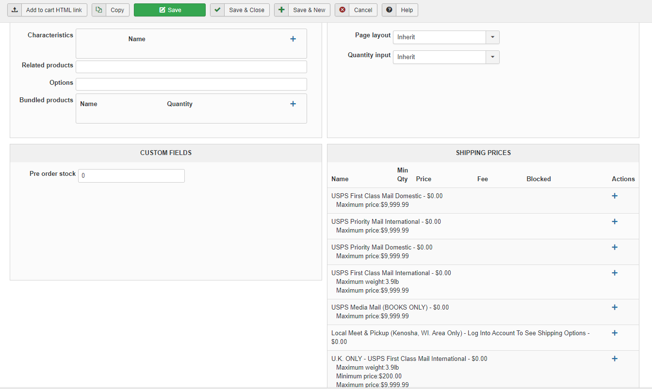

Could you do a screenshot of that product settings ? - Sure...images attached 1-3 are of the product itself (now out of stock). Then images 4-6 are of the product settings in the menu.

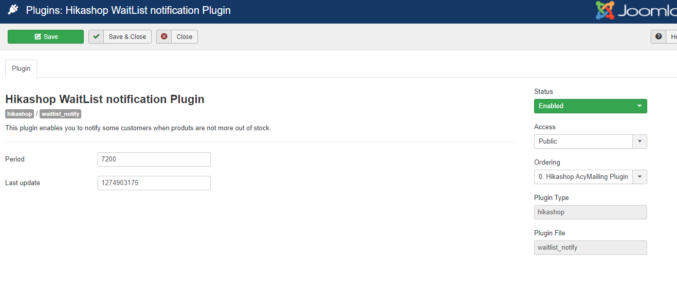

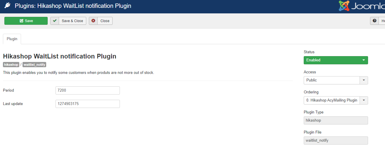

How is configured the waitlist plugin settings ? Image Number 7 attached (at least this is what I think you want)
  • Posts: 86042
  • Thank you received: 14174
4 years 4 months ago #340438
Sending 100 notifications per product at the same time is a lot.
I would recommend you to reduce that setting to 10. And instead, you can change the Period setting from 7200 to 720. That way, instead of sending 100 emails at once every 2 hours, it will send 10 emails every 12 minutes, which is much more reasonable.
Also, make sure that your cron task is running often enough (like once every 15 minutes) under the Cron tab of the HikaShop configuration.
