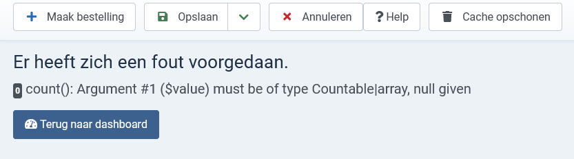

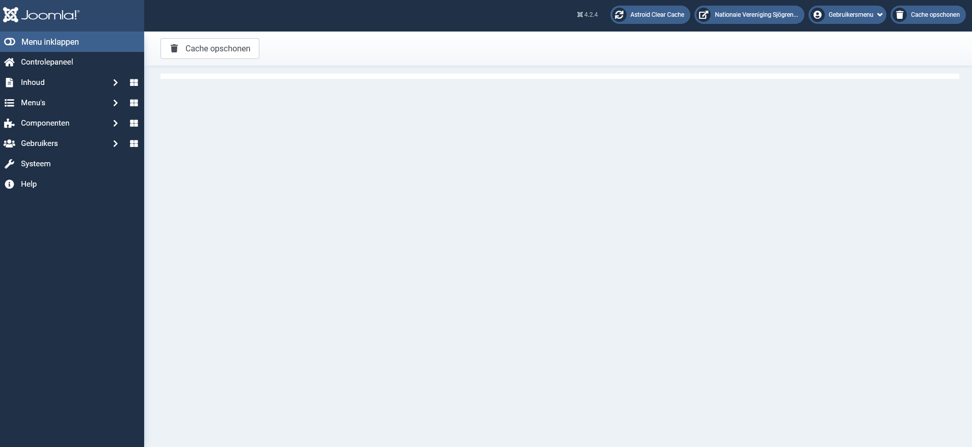

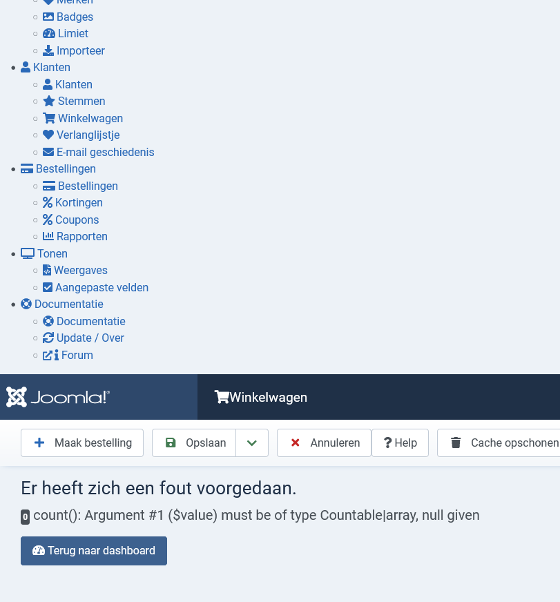

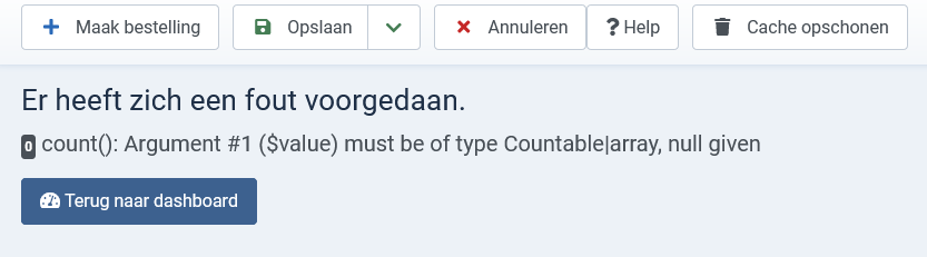

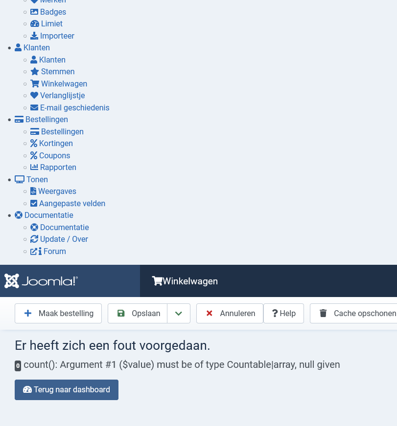

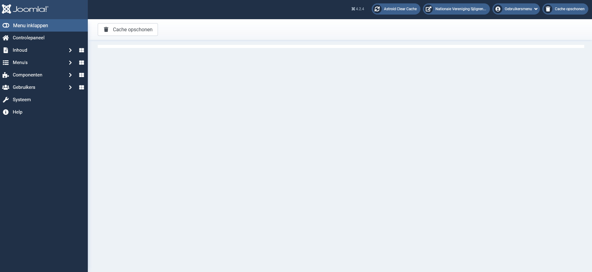

Under customer --> cart :I get the following message when I click on new: "0 count(): Argument #1 ($value) must be of type Countable|array, null given" when you click on make order, then you get a blank screen, the same happens with wishlist.
what is the cause of this and how can we solve it?
