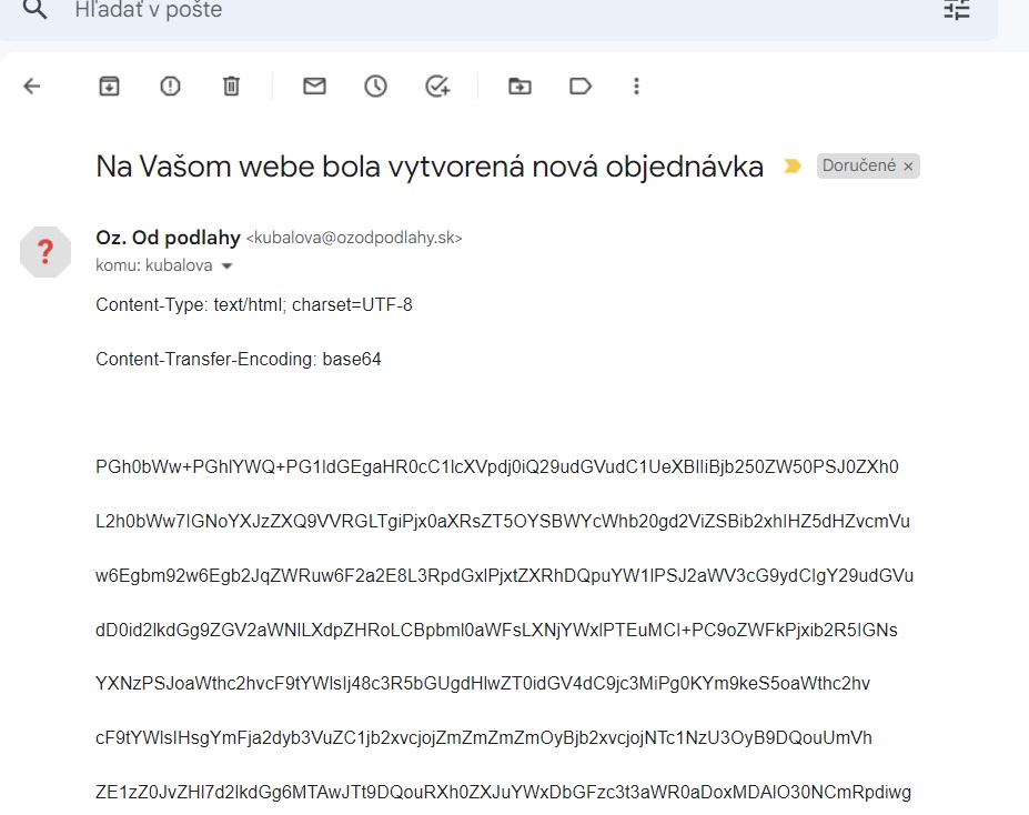

Hello i have a problem with e-mail. It is sending in plain HTML code as you can see in picture. Have you anny solution please,

You have a similar problem to this:
superuser.com/questions/1122385/emails-b...utomatically-decoded
So first, please look at the source of the email. Your email client should have a menu to be able to do that:
www.lifewire.com/how-to-view-the-source-...ow%20it%20was%20sent .
Please provide the whole source so that we can get a better undersanding of the situation.
Reading what's written on my first link above, it's likely to be something linked with the setup of the email server / domain name / etc. So we'll likely not be able to do much, and it will likely be something to report to your hosting.

The problem was in using PHP Mail insted of Sendmail in global configuration.
The problem is solved.
